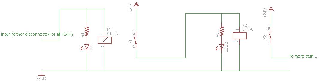

Hi, quick question about relays.
I have some 24V, 1.8k relays with a LED in series with 2k2 across the coils.
There are no snubbers on the relays. The LEDs seem to fail intermittently, and almost always on the same relays. Is it reasonable to think that it's the kickback EMF that kills the LEDs? How would you dimension an RC snubber for this application (i'd prefer that to a diode)?

I attached a quick schematic to show you how it could be hooked up. Basically, it's relays driving other relays in various constellations.
There are LEDs across many relays to display their state. The 24V supplies are of course hooked together, so in some sense you could say that the LEDs are in series with the relay contacts, as well as being in parallel with the coils.
Upon seeing this, may I ask you for your reaction and where you feel the snubbers should go? :)

Hmm, I guess I have been misreading your descriptions of your circuit the entire time. The LED is in parallel with the coil, not in series with the coil or the primary relay contacts.
Yes, that would definately do it. The voltage spike appears across the inductor...and what's in parallel with the inductor? The freakin' LEDs! As we all know, things in parallel all have the same voltage. The inductive kickback produces a voltage spike across the inductor. This voltage spike also appears across the the LED-resistor (because they are parallel with the inductor) and applies a reverse voltage to the LED causing it to breakdown.
I doubt an RC snubber in parallel with the relay coil will be enough (it only dampens and slows the spike it does not clamp it). What you need is clamping because the LED is so sensitive to reverse breakdown. Use a fast diode (like a schottky) in parallel with the coil- it will clamp the reverse voltage across the LED to less than 1V which should be enough for the LED to block.
Or a better method that makes it so the LED does not have to block any voltage would be to actually place a diode (that is fast with a reverse breakdown voltage high enough to survive the voltage spike) in series with the LED. It will do most of the blocking when the inductive spike applies the reverse voltage so that the LED does not have to.
Yes, you need to stick a reverse connected diode directly across the relay coil - the high back-EMF is destroying the LED's.
This is a VERY standard requirement, and should be fitted to all relays involved with any electronics.

the diode shouldn't see anything more than 24V - or perhaps double that if there is some inductive resonance on the input rail somewhere. It'll see 24V when the relay is on and just the forward drop when the relay is shut off and it is free wheeling.
Put the diode across the LED itself, in parallel reversed, and stick a big cap on the LED too like 100uF. That will save your LEDs, and provide snubbing, and still provide fast relay release.
Actually with a 100uF cap on the LED you may not need the diode at all, the energy in the relay coil is not likely to move that voltage much as the cap will be at 1.7v and the back emf will just drop that cap voltage a fraction, maybe drop 1/2 volt?

1. connect a diode 1N4007 in reverse direction across the relay coil.
2. LED in series with 2k2 means higher current through LED. it looks it is more than the rated current. Hence increase the resistor to about 4k7.
All the best.
Two points:
Firstly the diode does not have to be 1N4007. The reverse voltage is only 24v.
Secondly, the current through the 2k2 is about 10mA. So the resistor does not have to be changed.
A simple 1N4148 across the LED is all you need.
You can add a 100n across the LED too.
