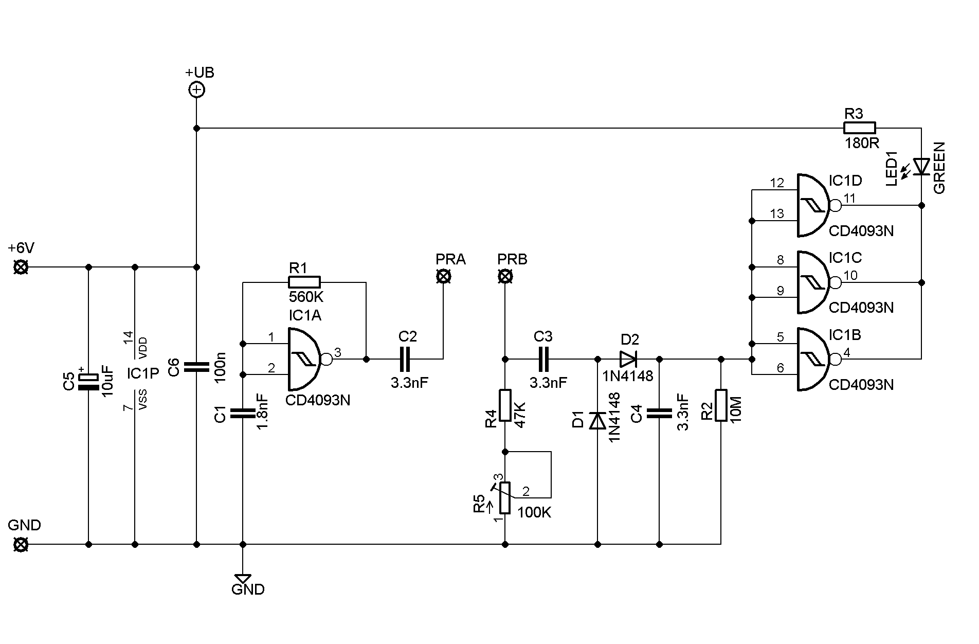

Friend I have here a water sensor circuit and I want that if the water level touches this sensor then it will drive a relay which will turn off the Motor pump...
And as the water level goes low means below the water sensor then it should turn on the motor pump...
I have 12volt and 200ohms relay... with 10 ampere contacts....
Guys how should I drive motor pump with relay please provide help....
So please provide a circuit diagram or modify this one so that it can turn on/off the motor pump...

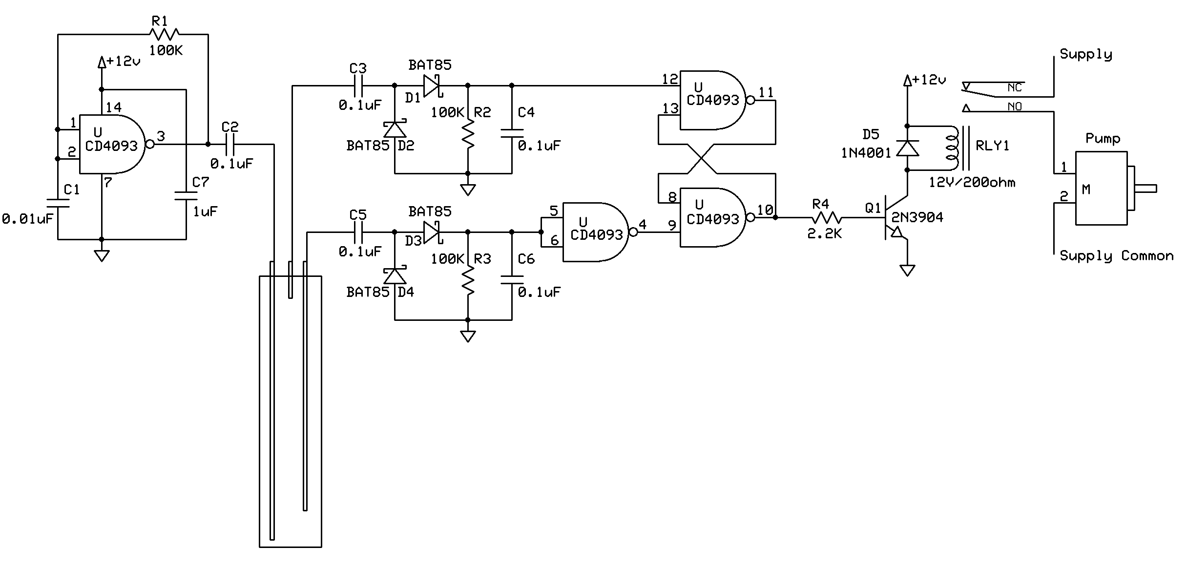

A problem with that circuit is that is will "short cycle"...turning the pump off and on and off rapidly as the water level changes a small amount. You would need to add a time delay for hysteresis, or better, a second probe circuit and a flip-flop. The high probe sets the F-F turning the pump off. The low probe resets the F-F, turning the pump on. I saw one using that basic circuit...but I can't find it. :(

Friend please help... I have posted this circuit diagram above because I have tested this with the Led in water for 1 month and it worked corrosion free... now I am thinking to turn ON/Off motor pump so please help....
I dont want low level circuit I just want that as I put this circuit probe sensor in water it switch off the motor pump and as the water goes low below this sensor then it will turn On the motor pump...
Your circuit is good for an indicator. But with it, the pump will switch off as soon as the probe touches the water. This may cause sloshing. The probe is then briefly out of contact with the water and the pump will restart. This can also cause sloshing and repeats the cycle over and over very rapidly. A second, lower probe with a flip-flop will prevent this, with only a few more components. This is how I remember it: attached.
I actually use a version of this, except with a micro-controller instead of a flip-flop, to automatically maintain water in a Christmas tree stand.
Ken
you have to use another probe as KMoffett said, it seems yo have no idea of how it shoudl work. i have a working circuit too, its with NAND gates only. no capacitor required, if you are interested tell me..
Dear KMoffett thanks.... you very much but is this corrosion free circuit diagram......
and what is the diode number.... please give.... or can I use IN4148 diode...

This is as "corrosion free" (AC vs DC) as you will get with a "conductive liquid" circuit. Normally I would use 316 stainless steel TIG welding rods for the electrodes, but platinum or gold would be even better. For absolute "corrosion free", you would have to find a non-contact sensing system.
Ken

D1-D4 are BAT85 Schottky diodes, and D5 is a 1N4001 silicon diode as shown in the schematic in post #4.
As for your "new" requirements...its time to dump the simple logic-gate solution and go to an 8-pin microcontroller. This means that you need to get into programming. I used a PICAXE 08M on my water level controller. PICAXE-08M2 is as low as $3.50US each. https://www.picaxe.com/ BASIC programming software for Windows is free. Minimum programming setup is: the chip, 2 resistors, 4.5V battery, and a homemade serial port cable. There is also a very supportive and civil users' forum:**broken link removed**
