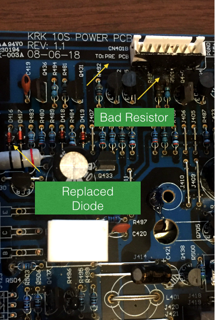

I was doing some noodling in thought on this, and the two or one blown resistor at the bottom (where it says "Bad Resistor) - the white connector goes to the pre-amp pcb (even says it on the board), which kind
of now makes sense to me why no sub woofer output is present, but is fine for the two mains (they're going thru).
I do feel the issue is in this neighborhood.

I get what you're saying regarding the complexity. I feel that I've gone this far, and for me to not do something at this point would be out of character for me.
I'd like to at least try replacing these parts if I knew where to get them.. Should be a cheap enough experiment.
I'm certain that at least one of them failed...
This one I don't know what it is:
These small resistors:
I'd be reasonably satisfied removing these, possibly testing them individually, buying them on-line, and once
reinstalled seeing where it gets me.

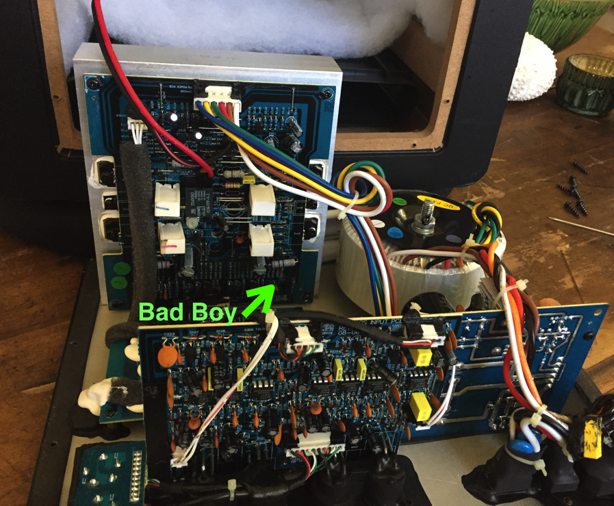

Here's my lack of knowledge shining thru clearly...
What is this 3 pronged black component ? I tried identifying it by number on the web, but couldn't find it:

What is this 3 pronged black component ? I tried identifying it by number on the web, but couldn't find it.
Three terminal components are often transistors either, NBJTs, PBJTs, NMOSFETs or PMOSFETs. The most common for audio amplifiers is NPN Bipolar Transistors (NBJT) and their compliment PNP Bipolar Junction Transistors. Big manufacturers tend to get their parts directly from the manufacturers and have their own custom number marking, so it is often not possible to get a replacement, except from the equipment manufacturer, if they will cooperate- often not. But, having said that, most components are standard and if we can see the circuit diagram we can recommend a standard part, which can often be better than the original where there is a weakness in the design.
Hmm.. Wow, I wonder if this is tough luck on this part... No way of testing it in isolation to ensure it's bad?

Update: I took the Transistor and the two questionable resistors off.
On YouTube, Learned how to identify and test the Transistor, and it was in fact a PNP Bipolar Junction Transistor, and it was bad.
Couldn't find a replacement, and I'm quite certain I won't be able to get the part from KRK.. SOL as they say.
I'm either going to bring it into to a service center that's authorized depending on the cost, or buy the whole back panel for $180+ from compass (once I get $$)...

:Hello: some scattered information, hope somewhat helpful.
The blue resistor (if that is a dark blue stripe on the light blue housing) is 68 Ohm. The other Green a 10 Ohm unknown tolerance. If the stripe after the black is a metallic the tolerance, Gold 5%. for other resistors, Brown 1%, Red 2%, a leap to Silver at 10%. The resistors do look corroded. The transistor (three lead IC) C3206, or 2SC3206 appears to be KEK Korean Electronics. However data listed as an NPN? transistors can show odd results when damaged. However a solution for outer trace Ic's such as 3 pin transistors is to try to follow the Emitter track to either a positive or a lead to common. P channel would usually be Emitter to Positive voltage source, the N channel Emitter to common ground. This can be used under typical situations to identify the type on an existing legible pc board. There are however in some circumstances when transistors are used in many other ways. The transistor (if my results are correct) is a Triple Diffused PCT type, meaning its manufacturing method. Features are 150 Volt DC @ 50mA. a low power switch. So more than likely if the part number matches is a sinking transistor switch configuration, turning on something elsewhere. Cases such as near that ribbon connector? the other end board may require that transistor to act as a switch on to function from the board it's on. Or it could be just for that board, the tracts are a bit tough to see clearly as if that transistors leads connect to that ribbon connector or turn back to that board. as for the IN4148 Schotty diode they are easy to burst when reverse voltage breakdown occurs due to over current or reverse high voltage spike that can result in a crack or complete small firecracker effect.
