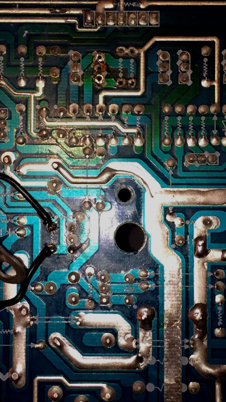

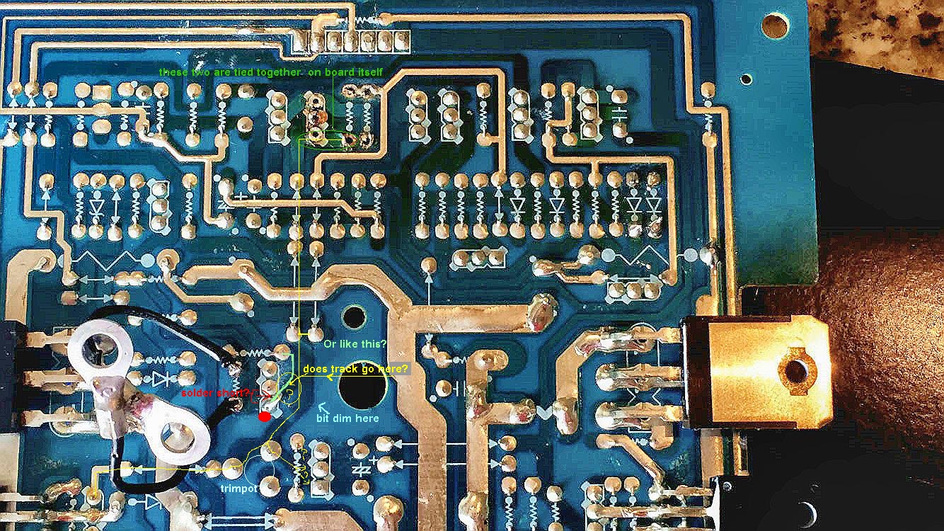

continuing, goes to a common ground connection, however I loose the tracks on the backside (solder side) of the PCB near those black wires with ring looms. So "If" the Emitter on that bad 3206 does in fact go to those wire components, then that should be a Ground point as those have to be common connectors, I've not seen what they connect to via the screw used. that aluminum heat sink? of so then those two wires are common Gnd for the sink itself also completing the path to a GND point for the 3206 .
If the track goes else where I cannot be sure with the wires blocking some of the power PCB's view. A photo of that area with those two rings slightly over to the left from the current image all ready posted as a reference to the paths I need to see if in fact the E does go to a common point on the board.
I'm pretty sure it goes to common GND, When I disassembled the pcb from the heatsink, the two small wires that connected to it needed to be cut (because I didn't realize the screw had a hole thru the board (convenience) to un-screw it... Imagine that! What you see in the pics are my re-fabbed ground connector (ring looms).
Either way, I'll trace the board print/solder to see if the 3206 lead to my hackery..

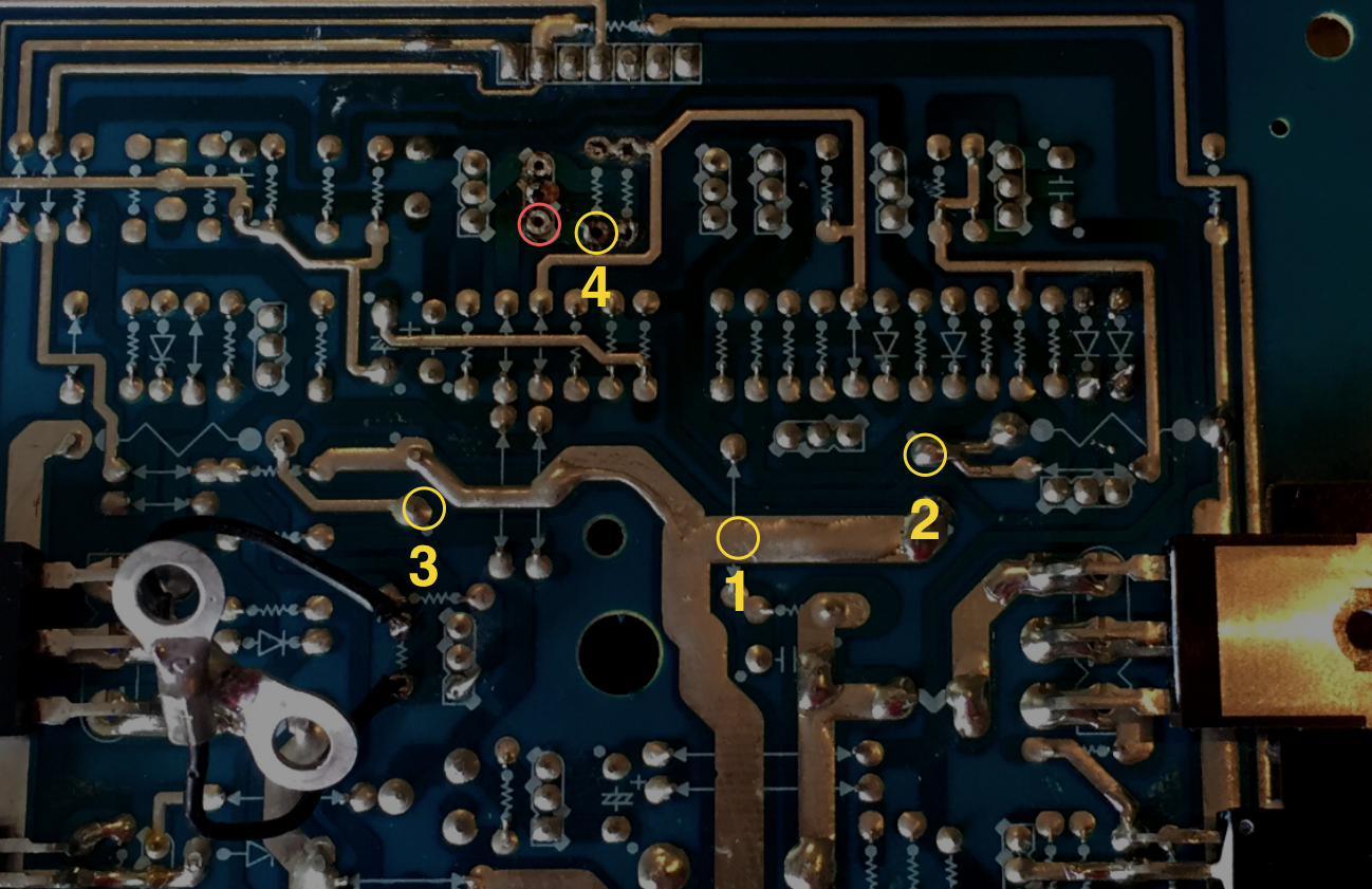

Was typing this whilst you were posting the readout info, :) , I'll read that now, this extra can be used to just double check if it's close enough to the test all ready done.

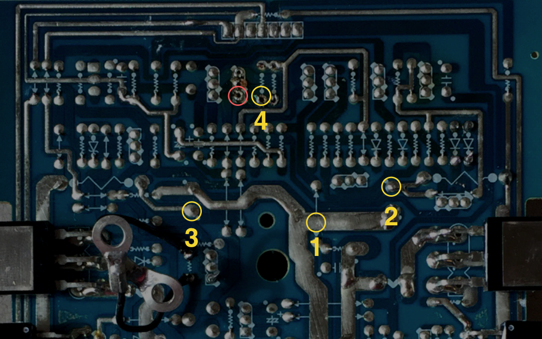

And as for testing the 3206 Emitter terminal to a Common point using those large capacitors.
Multi tool in Ohms mode auto range, Probe common test pin to the large solder track on the center power pcb (from that bottom connector that solder track runs from the bottom of the board in the image and runs up the center of board), then the Red test lead to the E port where the 3206 was located, it would be (looking from the back of board matching the image posted) the lowest port of the 3 ports at the 3206 on the solder side.
The reading would be for E to the large solder track?
And also the meter value may change during testing, the test results being interested in are the initial result value.
Next, same method in auto range, the red test lead still on the E terminal solder side, now the common test pin to the Large Electrolytic caps opposing the large solder tract that goes left and right from center of board. They are vertical mounted on the board from the image. The right one from the solder sides opposing pin is above that large center track of solders right side of board at the tracks end up at that Y looking solder point just to the left of that printed resistor stamp (this is located on the right hand solder side of the board -\/\/- well it actually looks like a W.
what is that points initial reading?
Next the same for the other Electrolytic, its other contact point needed is (from the image) right in that loop of those two wires below the center solder track. a small track goes left then up to the resistor mark (that W again) on the left side of the board solder side.
What would that value be?
Overall the caps are joined in opposing polarity config by that center track comprised of exposed solder requiring only one test on that and then 2 more test, 1 per other pin on those Electrolytic from the 3206 E terminal as reference over all. And as to those caps they are the Push Pull system to the fets control that drives the sub.

The main reason for the test of that 3206 E and those large electrolytic caps. I'm wandering to a possible tied short through any of those fets are present there.
And yes please to attempt to find out if that 3206 E does lead to a common point on the board. Main looking type if possible. thank you.

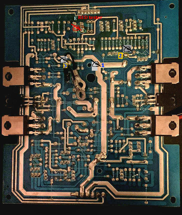

Question: To get theses questions answered am I'm reinstalling the old parts and testing the board in isolation (not powering up)? Or am I getting the new parts installed then testing (again isolated, and not powering up).
Just want to make sure I follow before I get started :)
no need to reinstall the parts, nor any power needed, just the E terminal that the 3206 was connected to is all that is needed with the multi tool on ohm auto range with red pin on the E terminal solder side then the common test lead is doing all the wandering work at the other connections mentioned for those two caps, as for their identification method, refer to the image of the solder side when noting the readings, the Right cap is the right one,and the left is the left when looking at the solder side of the power PCB photo posted on forum. As all the necessary contact points are available on that side of board.
Very good.... I'll get this done in the morning. Thank you!

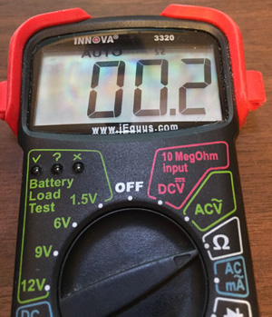

the Emitter test of the 3206 shows very low resistance, something may be off somewhere else, if not then the BJT are not likely to be shorted in certain cases and the
electrolytics are Ok. Some driver stages when abruptly shut out or off can result in damage to the driver stage via holding one of the stages on for a long period resulting in
Trying an image here. about the test points with the 3 multi tool results to test.
Hmm/:meh: no good. workin on it. either pending, or wrong method used, photobucket, i think may be the end of interest.
last try for now, element type link attempt. PNG format
Test result of value:
1
2
3
please and thank you.
Here's goes...
1 - No reading
2 - No reading
3 - No reading
Given these, I thought I'd test the Meter and I added another spot #4 (the Blue resistor pin) that was just to see if I'm getting any flow, and I did get a reading = a value of 00.2:

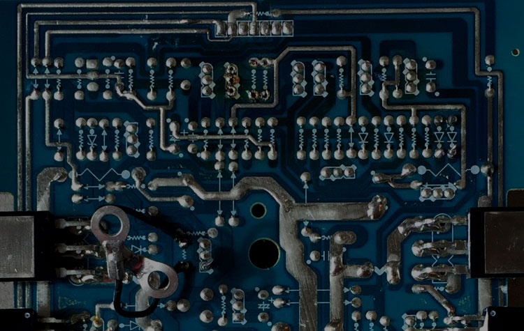

Also here's another set of pics that may validate I was touching the right 1,2,3 spots, as well as some others that my help you see the
board print, etc.
Without notations:
Hope this was the expected results :)...
Good reading through the 3 points. the 4th reading would read low because the test pins were shorted together. Now on the thin yellow line edited in should be the path from that 3206 E pin and down to those two wires, no matter the enhancement of the photo here, they all need light when photographing to see the tracks clearly. in the image I've posted the yellow again is the track and the green color line edited into photo is a possible track flow to that transistor (Q705) as indicated on a previous image from the topside of power pcb as a reference. The transistor leads in question are the Q705. Just does the the bad 3206 E lead go to the connector of that particular transistor at all? or simply go around it like the yellow line edited in and not have any interaction with it via a board trace in that immediate area indicated by that does track go here in yellow. I will post an image totally unrelated in a bit for an example only.
I'll see if that track goes down to that spot. Time to get the room lit up and my squinting in order.. Stand by..

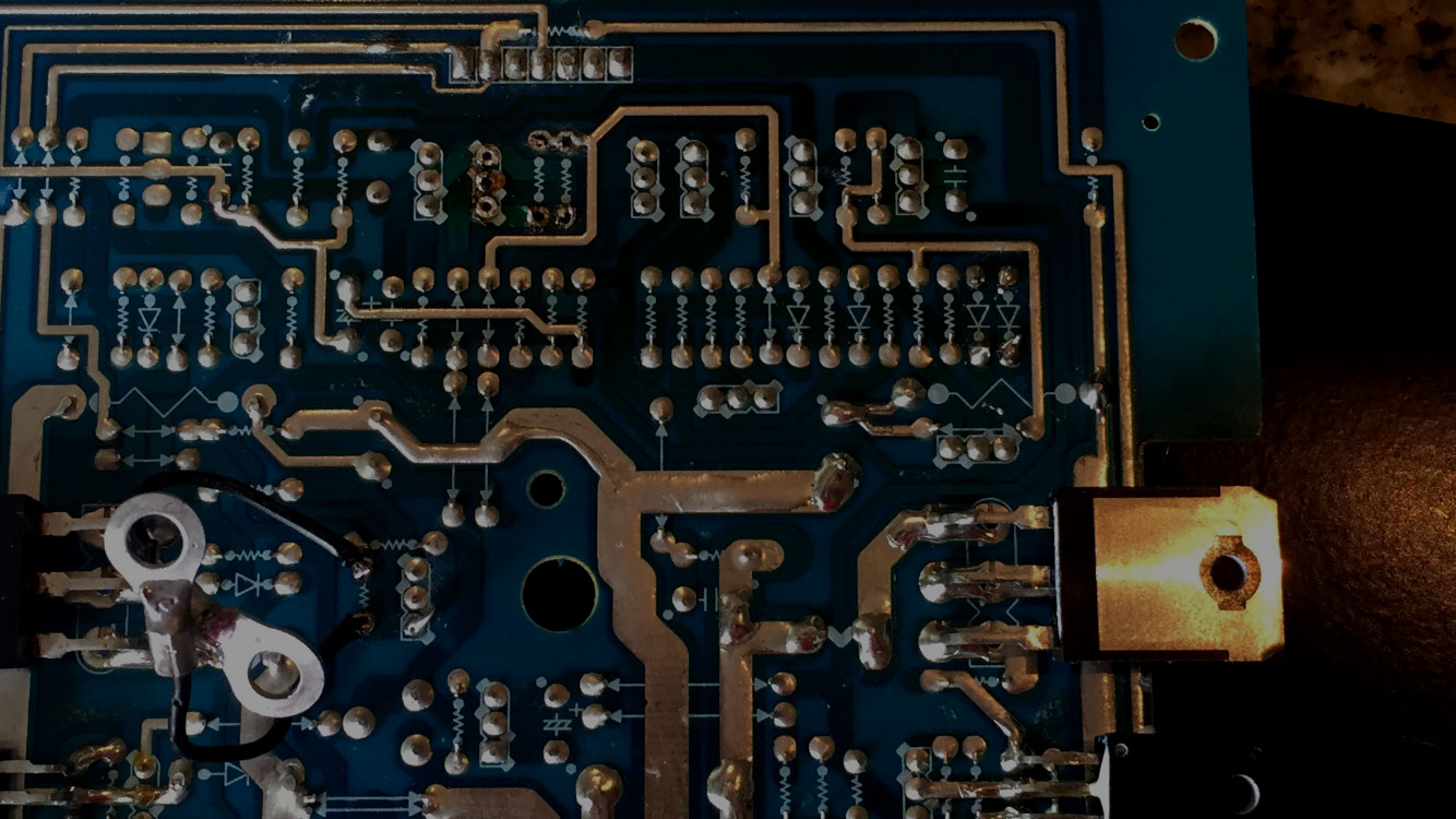

This time I didn't down size it.. It's the lighting and flash effect that make it harder for me.
How does this look? (Personally, I couldn't tell where it's tracking because of the over connecting components).
Some of that metal tracking material looks like it came off from the 3206 E & C pole positions.
