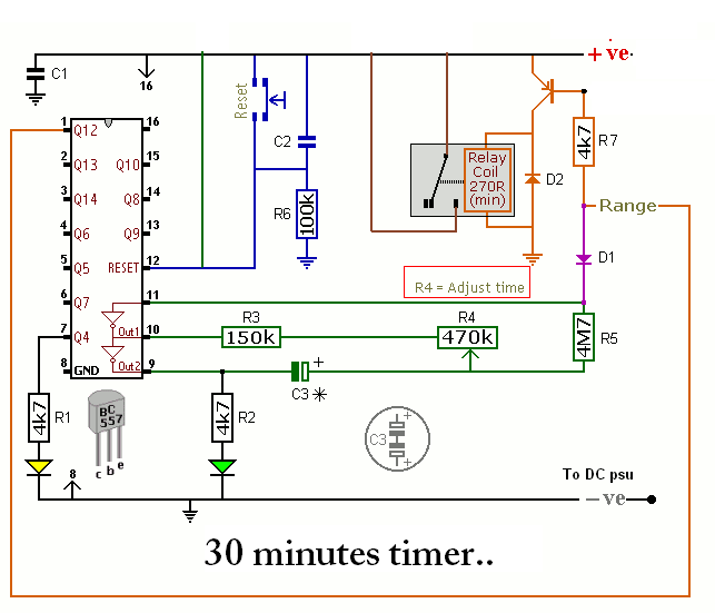

Do you have a diagram of your CD4060 timer?
Thanks 4pyros for your reply ......
I have attached my 30 minutes timer circuit using cd4060...
I have same circuit for 10minutes timer also...
Thanks in advance..

That looks like this timer here;
This page has the same circuit with the instructions to make it a repeating timer;
Friend I know this site from past 1 year.The repeating timer which they have present are only fixed on/off timer.THAT means the off is equal to on time, eg : 10 minutes on and 10 minutes off. We cant set the on and off time values differently.. I THE repeating timer which I want will have on and off times values ie: 10 minutes on and 30 minutes off.. I you can create this repeatings timings 10/30 from the site you mentioned above then I will be very glad.

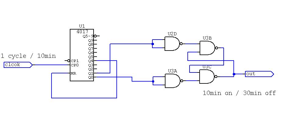

if you have a 10 min timer you are done with a 4017. you do not need to have a separate 30min timer.

FRIEND can you give me the circuit diagram.. So that i can analyze it..
see the attached, you need a pulse or clock of 1 cycle / 10min (Ex: 5min on 5mn off)
instead of 4 NAND gates you can use a SR flip flop.
Edit: reset of 4017 can be selected as required, also depends on the status required after 1st clock the out put of counter can be re wired.
also you have a short of programming feature with this, the on & off total time can be set in 10min resolution in a 100min span with a 1 cycle / 10min input and so on. this can be done by slecting appropriate out puts of 4017 to set & reset the latch (of four NAND gates)
