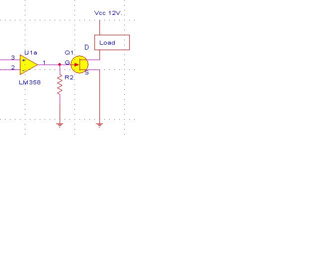

This is what i tried with the IRF510. (attached drawing). Q1 is the IRF510 MOSFET (a little larger then needed, but all that was available). R2 is 100,000K. The load was a piezo buzzer, about 200ma. The problem, was that the load was always on, whether or not the LM358 output was high or not (on-state voltage on the output pin was about 9.5 V, off state was measured at about 3.5mV).
I was thinking maybe the FET was fried. I've read where FET's are very senstive to static (though I was careful), so maybe driving a small power transistor with a smaller one will be the best. This circuit will be in a high vibration environment, which would make a "cheap" relay more prone to failure.
That isn't the symbol for a MOSFET, it's the symbol for a JUGFET. You've connected up as a source follower so you wan't get any voltage gain, you'll just get the gate threshold voltage drop. Connect it up common source style, with the load connected from the drain to +V.
yup yup yup. to clarify, that means move the load between +V and the transistor.

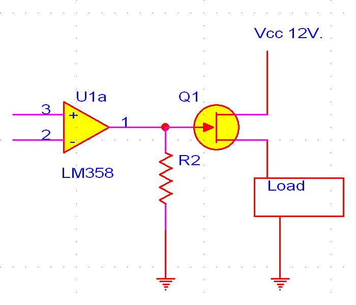

Hey, you guys are pretty sharp!!! The MOSFET symbol was the only one i could find in PCB123 that was close, so I used it. I've got it hooked up, as in the drawing, and it works. There is a small chirp from the buzzer, when the circuit is powered up, but its not objectionable ("power on diagnostics, an undocumented feature").
What I dont understand, is why it works though. I thought that the Source of a MOSFET was connected to the most positive voltage, and the drain to ground. This is opposite, and works!!!
You are thinking about how a P-channel Mosfet works. But the IRF510 is an N-channel Mosfet.
You've still using the wrong symbol for the MOSFET, the correct symbol is **broken link removed**.

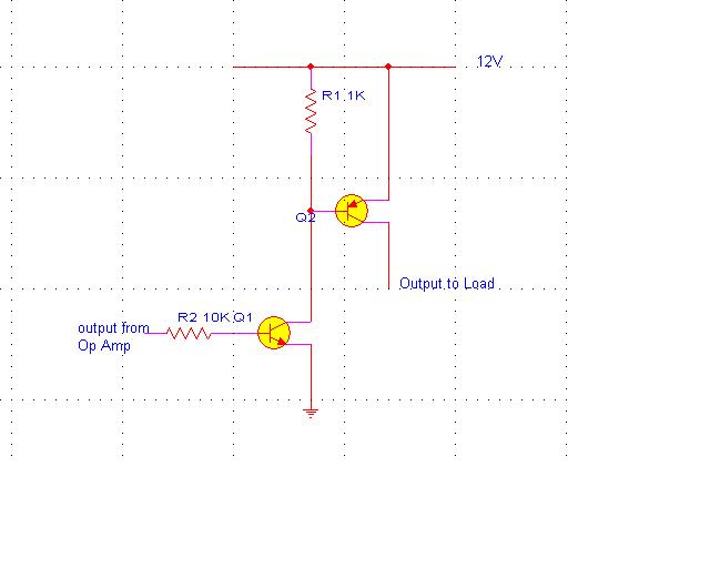

What has finally sunk in, is that using an N-channel, or an NPN transistor, interrupts the ground circuit of the load. While this works, its not what someone installing a device would expect...they'd expect their device (buzzer lets say), to be grounded, and get the positive voltage from this circuirt im making.
By using an PNP bjt or a P channel MOSFET, would that enable me to build a circuit where the positive voltage going to the load would be interrupted, instead of the ground? Any disadvantages to this?
This would be very similar to the circuit that Tarsil posted, except that in his, I didnt see any way that the base of Q2 would be kept high to shut off Q2.
There is no drawing of the P-channel MOSFET circuit, as it is the one I uploaded in error before.
