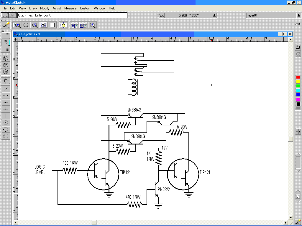

I need to replace a relay in an existing automotive power circuit with a solid state device. Device can be pre-packaged, or one that I can build from hobbiest parts such as found at Radio Shack. Result needs to be as lightweight and compact as possible.
The relay has 2 sets of contacts with both normally open and normally closed sides. With no power on the coil, commons 1 & 2 are each connected to their respective outputs. With power on coil, common 1 is connected back to common 2 but common 2 is not connected to an output.
The relay has a 12VDC, 5mA coil, and the contacts are rated 20A at 50VDC.

The relay circuit is my interpretation of your description. The solid state circuit is below.

I don't see how that circuit provides the isolation a relay would.
Have you looked at the circuit driving the relay?
Is there a diode in reverse paralell with the coil?
If so then connect a resistor the same value as the coil (about 2k4)in series with the diode. This will make the magnetic field decay at a faster rate so the contacts will open quicker and hopfully reduce arcing.
One issue that a descrete design may have problems with is a highly inductive load. Driving a motor or similar can result in alot of back EMF that can be fatal to a circuit not designed to handle it. Relays will do this easily, and with a simple snubber ( capacitor, capacitor-resistor in series) you can expect years of releiable service.
Automakers know that it is hard to beat a relay for simplicity and price when it comes to large inductive loads. Relay wins hands down.
BruceS57, you could use a couple of opto-isolators with darlington pairs. You would need to incorporate them into a design such as the one Russlk posted.

My thanks to all that replied to my question! I found a SSR on the market that solved my problem. It was 10x the cost of the relay circuit, but will never have to be replaced and doesn't generate a spark.
