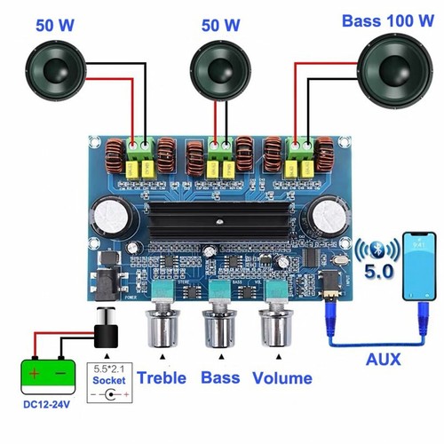

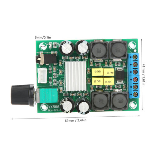

I suggest you look on ebay or Aliexpress for a TPA3116 based amp module.
Examples -
Stereo:
2.1 Channel
They are not bad for the price, perfectly good for PC speakers - the same device type as I use in my home built PC speakers.. The ratings are typically rather exaggerated (especially if only on 12V), but still perfectly usable.

This looks like a good and easy way. But I would like to build the circuit myself since the TV already has most of the required components on the board.

Actually I checked and it is cheaper to buy a second hand 2+1 system than one of those boards :/

The sample circuit board doesn't have any values listed, I can't decide them :( All of the simple and cheap amplifier circuits lack subwoofer output. Is there a way to add it by using another amplifier with low pass filter in its input. Also how people build stereo amps with one mono amplifier IC. I really don't want to buy a premade amp board since it destroys the purpose of using old materials and costs more than a 2+1 speaker set.
