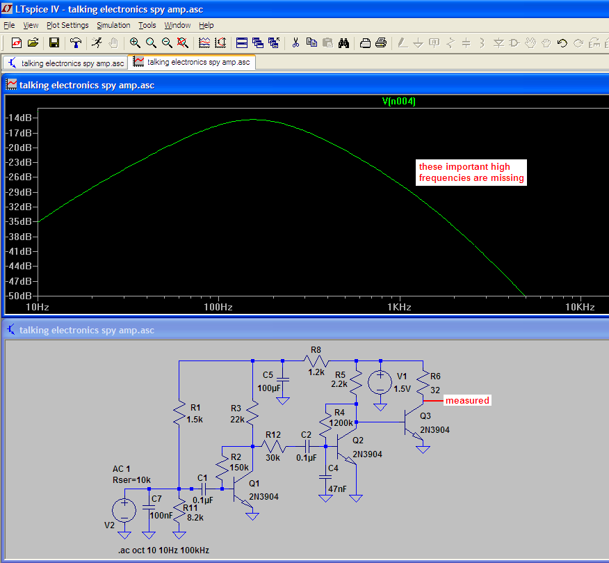

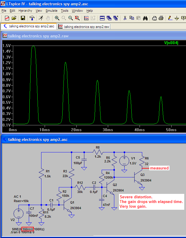

I simulated the Talking Electronics spy amplifier:
1) Its high frequency response cuts frequencies above 300Hz. At 3kHz the response is -28dB down.
2) Its distortion is extremely high.
3) Its gain is very low.
4) Its output level drops with elasped time.

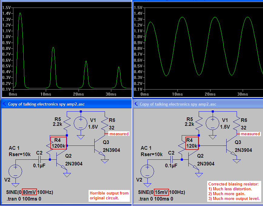

I notice colin55 hasn't posted much lately... =O
I corrected the value of the biasing resistor for the output transistors and made it work much better.
Now the capacitors that cut all the mid and high audio frequencies should be removed.
