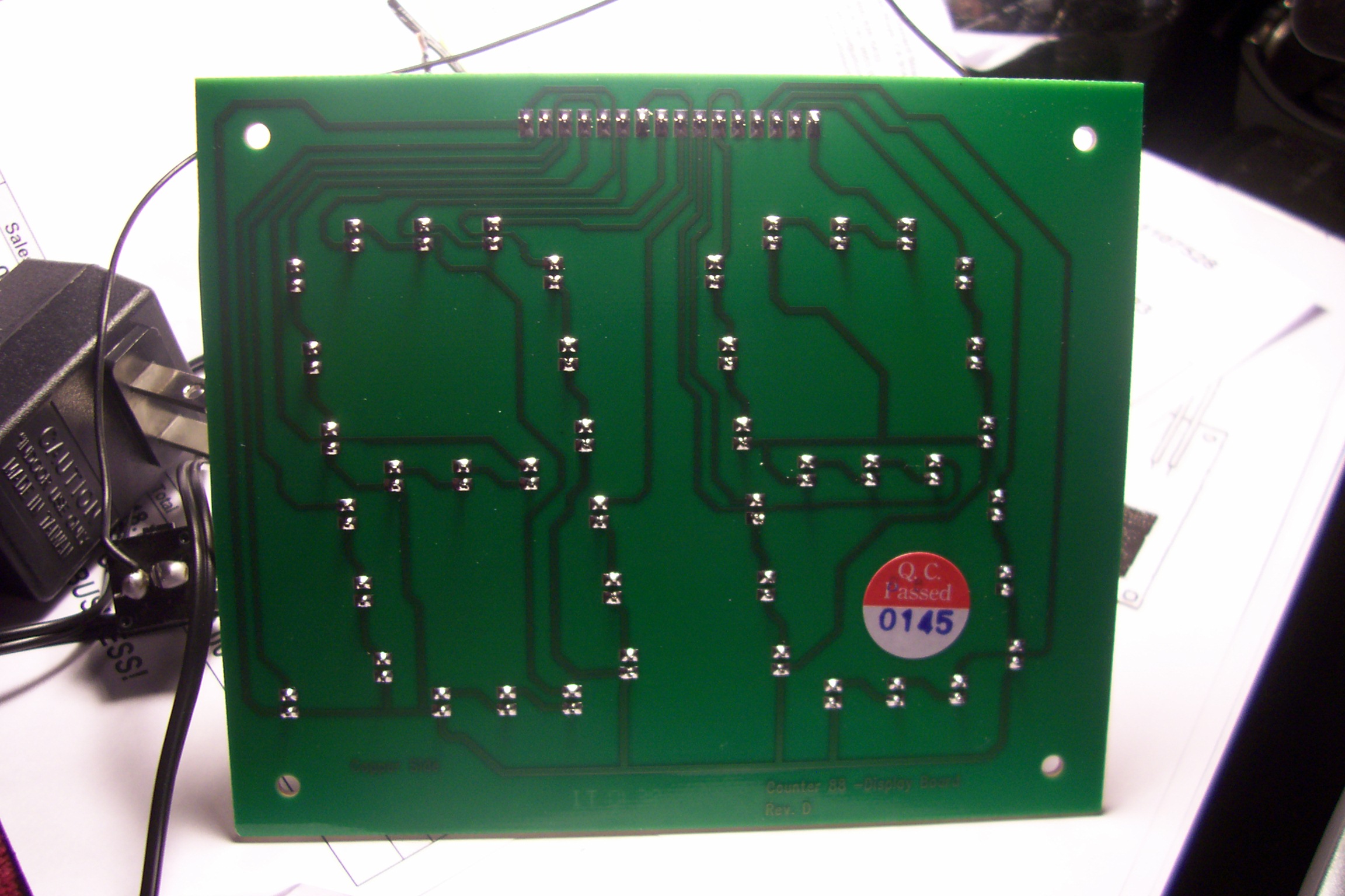

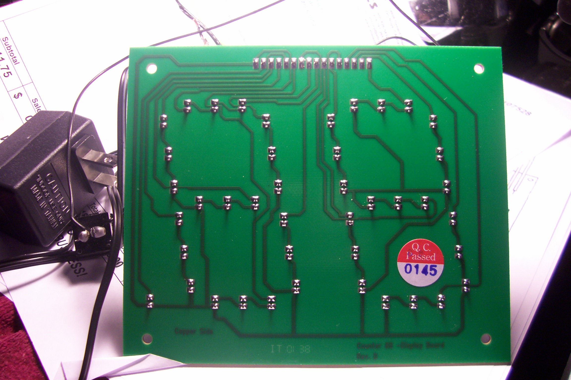

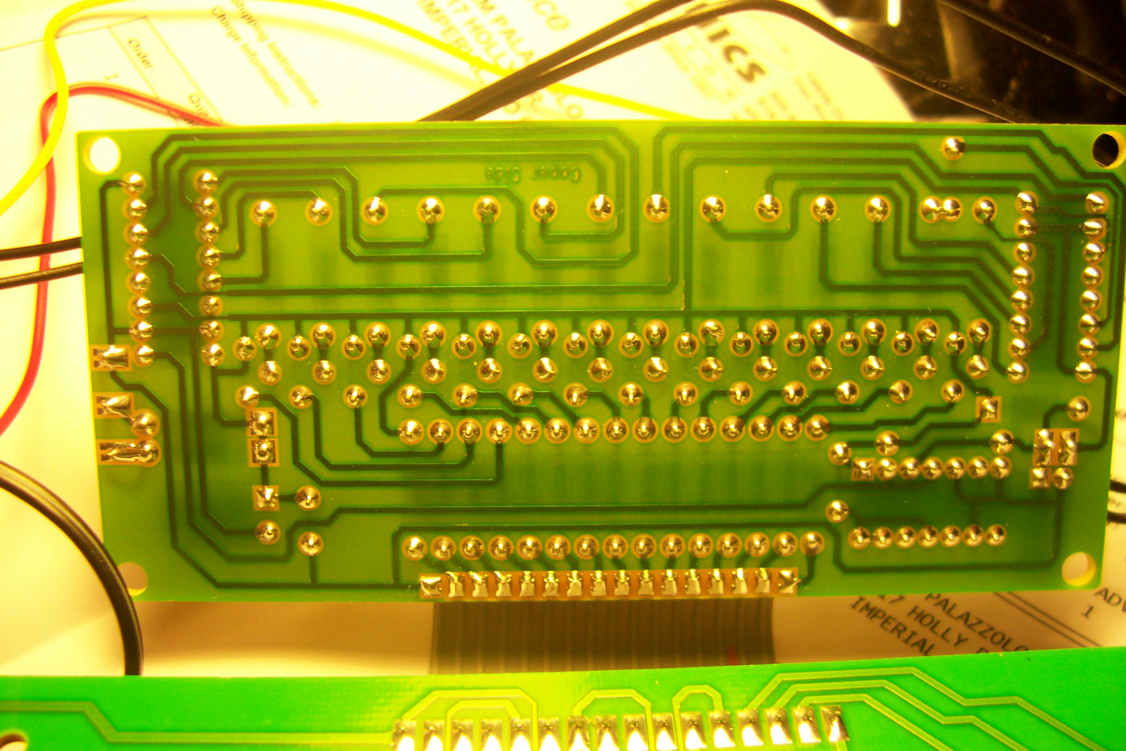

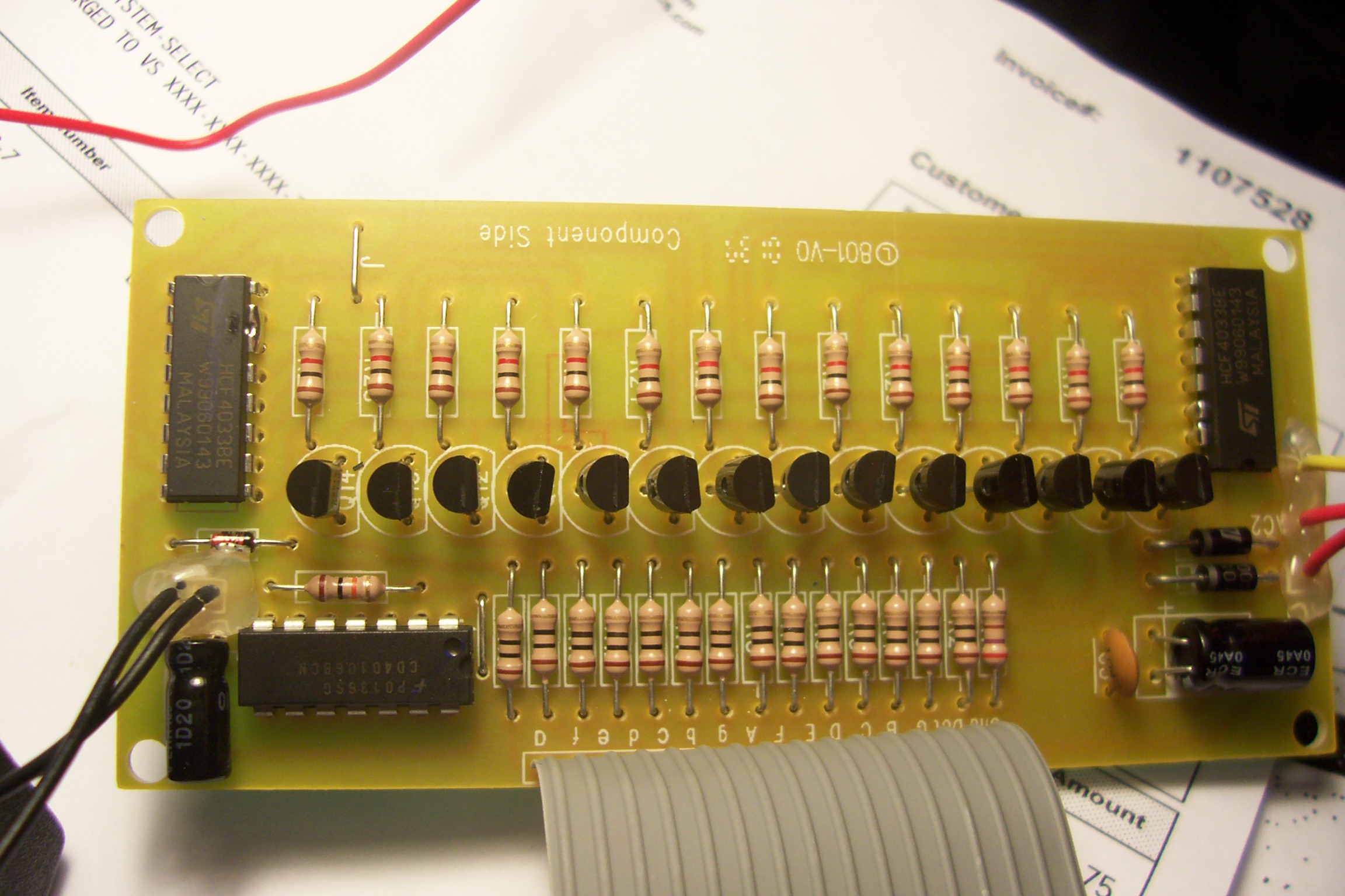

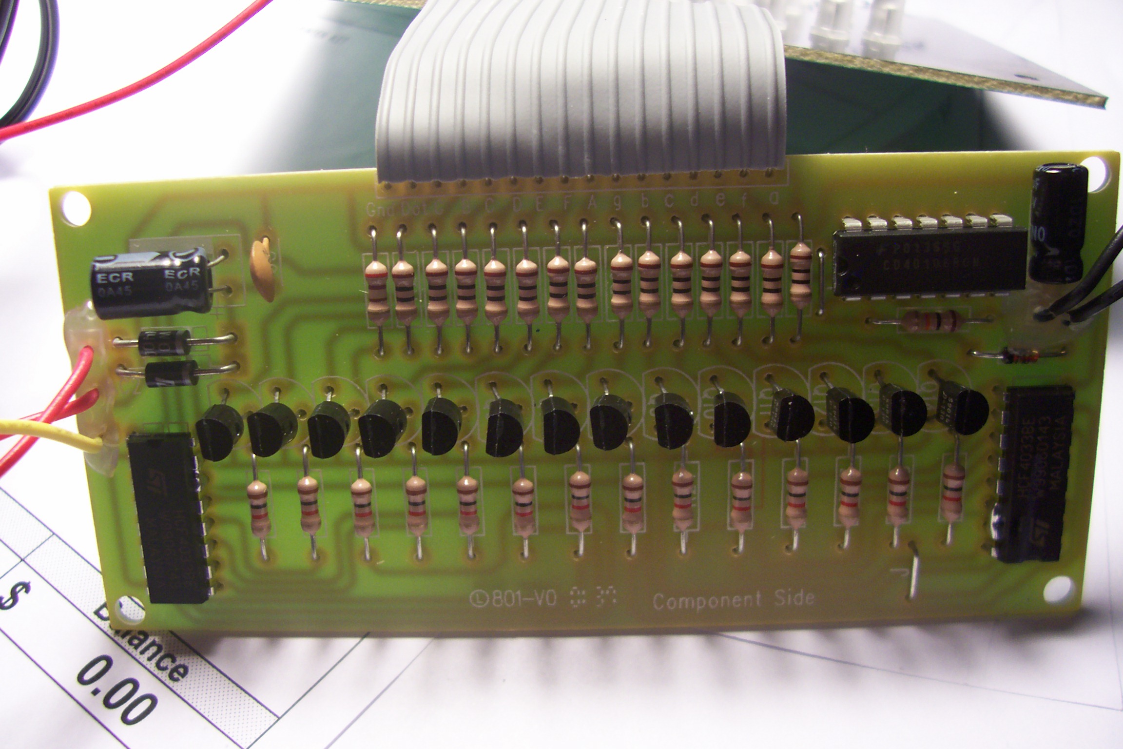

OK........... I admit I have only simple knowledge about electronics but would very much appreciate any and all ideas on how to add a reset button to a circuit that I just purchased.
By reset, I would like to reset the 2 LED's both to a "0" each.
(Not reset the power.)
The circuit involved is an ALL ELECTRONICS Corp. LED 2-Digit Counter Kit.
I knew in advance that the circuit was not built with a "reset" included, but in my infinite wisdom (smile), I assumed I could reset the power and then the counters would return to "0". So much for infinite widom.............
In any case I have added attachments of this circuit in case somebody would recognize this IC, have pity on me, and have some idea on how to advise me on how to make a reset button. "I am capable of some soldering."
REMEMBER....I'm very limited in electronics knowledge so a nice "Electronics for Dummies" explanation would be very much appreciated.
The 3 chip numbers are 2@ - HCF4033BE
1@ - CD40106BCN
Once again thank you for your time and experience.
Sincerely Grateful and inexperienced
Sam

It look from the photos that they have shorted pins 14&15 (Lamp test & reset) on the chips legs. On the back of the board only either pin 14 or pin 15 is connected to ground, so not only will you have to remove the short from the chip but you will also have to ensure pin 14 on both chips is connected to ground and pin 15 on each chip is connected to ground (for running) or to Vcc (for reset). Good quality photos by the way, really helps in this situation.
