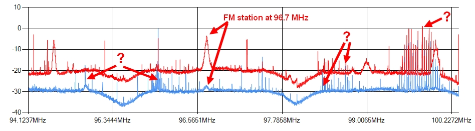

Using an rtl sdr as a spectrum analyzer and some code that I wrote, I recorded a segment of spectrum from 88 to 108 MHz, the FM radio stations allocation.
The faraday cage significantly reduces the signal strength of the radio stations. Notice the FM station at 96.7 MHz in the attached images.
The red graph is outside the faraday cage and the blue within it.
However, what I'm trying to determine is what are all those other signals.
The rtl sdr is plugged into a notebook which I do know generate some RF, I have previously found frequencies around 450 MHz.
What's all that in those graphs, though? Would a notebook generate such noise throughout the spectrum, could they be harmonics?

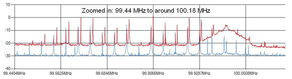

Here's a zoomed in image:
Do you guys think that it's RF noise from the notebook, there seems to be a lot of it for it to be that?
I'm also going to do some more experiments to determine what RF is being generated by the notebook.
A notebook generates a hugh amount of RF trash spectrum from DC to 2GHz and beyond, with worst stuff below about 800 MHz. There is no doubt that putting the notebook inside the cage to make a measurement of spectrum is a bad idea. Depending on the size of the cage, in fact the cage will make things look worse because the RF radiated from the notebook and cables will bounce off the inside walls and appear to add more noise power than if your cage was anechoic.
