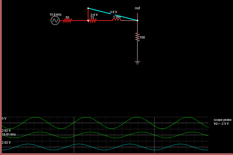

BELOW each element has equal magnitude at 2.62/5= 52.4% not 40% @f = 15.8kHz not 9.6kHz
The probe in turquoise is the lowest trace.
Reported the original results were;
1.- voltage on each element match at a much lower frequency (9.6k vs 16k).
2.- peak-peak voltage is not source/sqrt(2), but much lower (40% vs 70%).​
EDIT
In order for 9.6kHz to be true equal voltage point with L and DCR=Rs vector impedance = 100 Ω then √{X(f)²+Rs²}=100Ω for X(f) =ωL and f = 9.6 kHz then you can solve for L or Rs.
If Rs=13Ω then L=1.6mH
and if Rs=78Ω then L=1.0mH
so recheck DCR (Rs), f etc.
Forgive my oversight.
Then if the DCR measurements are accurate, then L may be easily calculated and the simulation should always match the real world when all assumptions and measurements are correct.
So far they do not match.
EDIT
