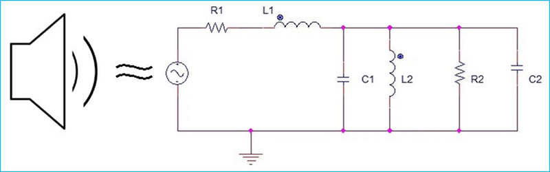

Hello Dana, thanks for the schematic. Interesting and smart to model the speaker as RL in series, i would not have thought of it.
Are C3, C4, R5 and L1 part of the speaker model or are they a mean to stabilize the reference potential?
Yes all the components below the text Speaker Model are part of the model.
So, again, the swing is only 2.2V peak to peak. Any ideas on how to improve it? Also, the output power is ridiculously quiet compared to the power i get by plugging my phone directly to the speaker. Any ideas?
The issue is you are trying to drive a very low Z load. That in turn means lots of current in the transistor
driven by need to lower its collector and emitter Rs. Its a cat chasing its tail, as you try to do this, Class A,
the Pdiss of the transistor rises quickly.
Regards, Dana.
Class A means the load has a constant DC bias current with AC swing on the collector.
The collector DC pullup current must be greater than the AC load current otherwise the collector collapses into saturation as a null voltage gain switch rather than the typical voltage gain of Rc/Re of an emitter current-controlled current sink at the NPN collector.
Class A is not practical for a speaker as the DC current and if AC coupled, for the same reason, the collector resistor, Rc must be less than the Load R.
