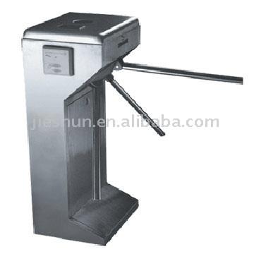

Only way to make the count accurate.
I wouldn't say the only way. If you use 3 pairs of these sensors evenly distributed across the height of the doorway, that completely eliminates the chance of a hand movement tricking the system. Unless the OP is expecting people to try to deliberately deceive the system (for example by two people entering at once), turnstiles should not be necessary.
I believe he's aware of that; he's suggesting that you could install turnstiles.
Brownout, the other problem is that turnstiles do not usually work in both directions, and difficulties especially occur when there's only room for a single turnstile for both directions.

Why sould two people entering the room at once be a deliberate attempt to fool the system? People move in ways that are most condusive to their own needs. The possibility of multiple people entering/leaving the room is always there. There is no system that can reliably account for that. Secure buildings require each person entering or leaving to use a magnetic badge before passing through. But even that isn't 100% reliable, as one person can 'taligate' on another. Only by controlling how people pass through can you be sure you have an accurate accounting.
