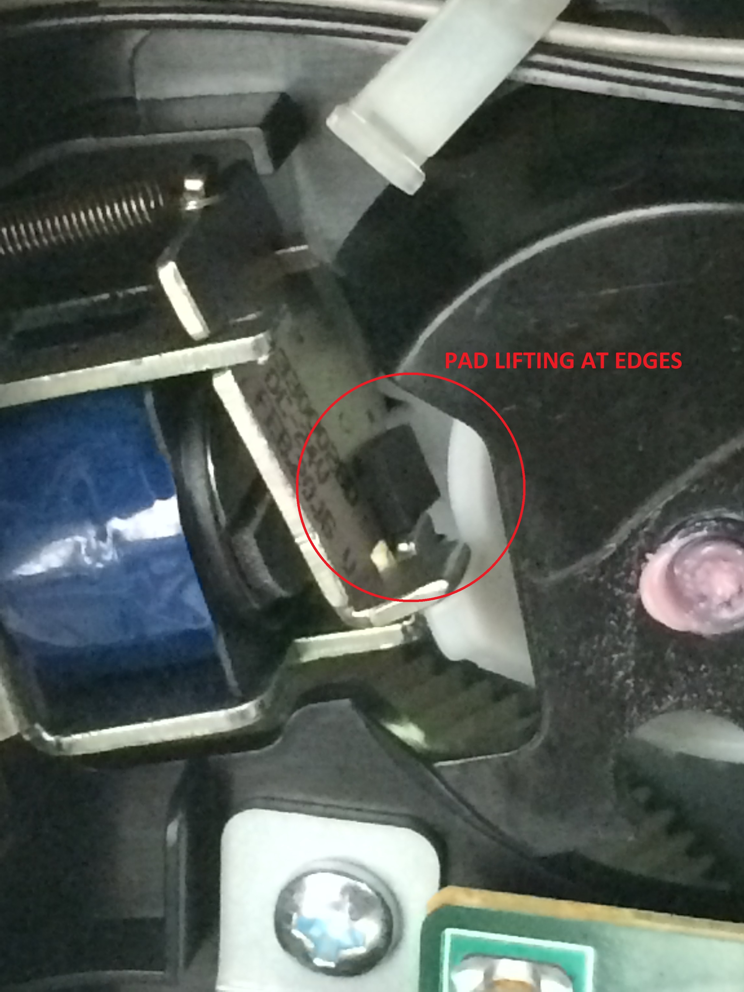

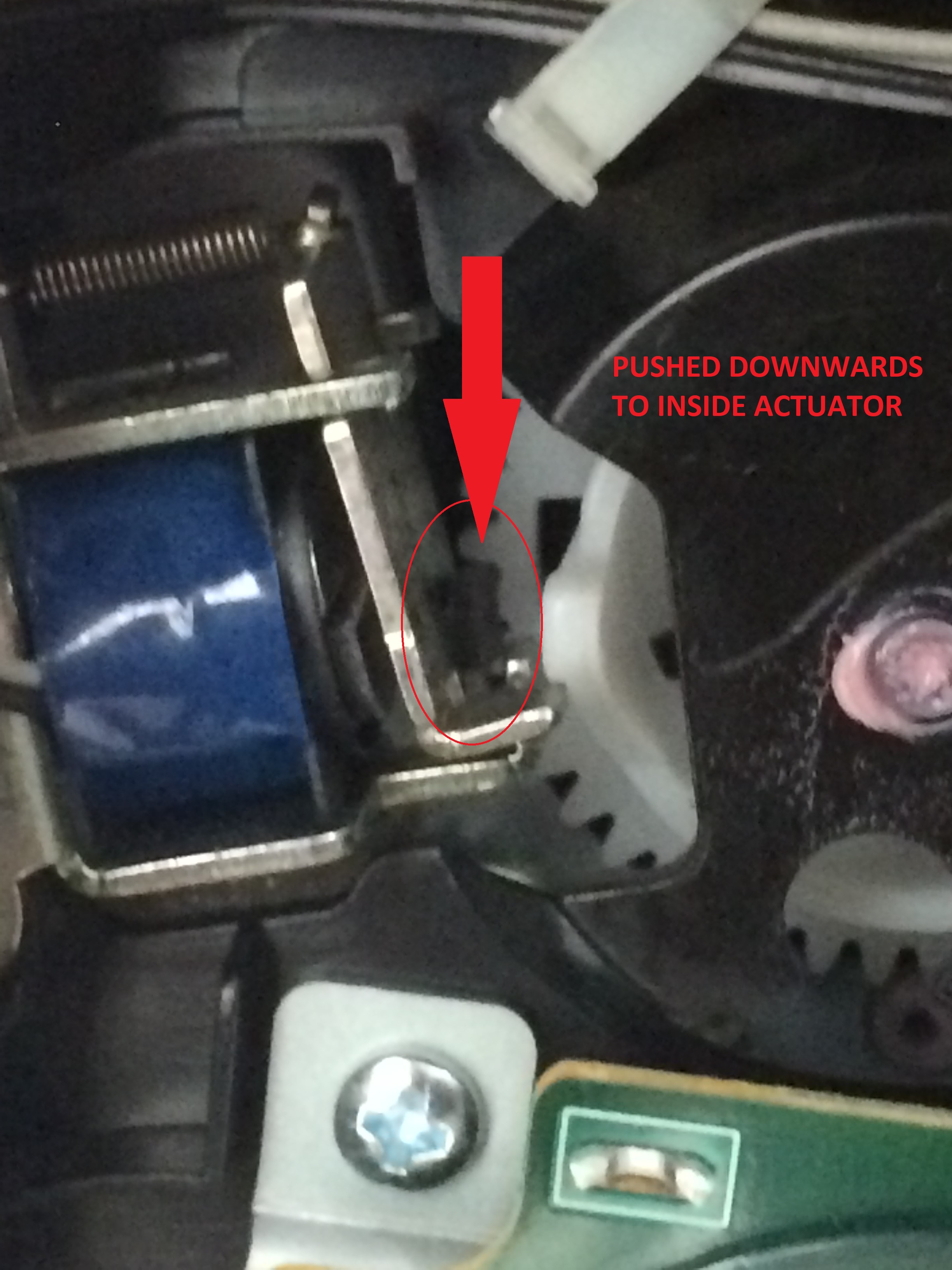

Exactly as your explained with your pictures - I removed 5 screws (two at the back, 3 at the front) and the cover slid backwards. With no technical knowledge whatsoever, I used a jewelers screwdriver to push the pad downwards towards the actuator, then connected power and it restarted. It was done and the "Ready to Copy" message appeared. I turned the printer off, replaced and rescrewed the cover and then we were working as normal. Total time 15mins. Just to prove it...photos attached:
Before:
After
