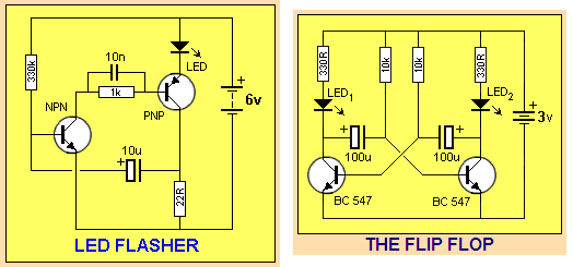

The explainations in the talkingelectronics website about the Single LED flasher is almost detailed, but there are certain points which I couldn't understand...
Taken from the site:
Here is the technical description of the operation of the circuit:
When the supply is connected, both transistors are off and the electrolytic charges via the 330k resistor and 22R. When the voltage on the base of Q1 rises to about .6v, the transistor begins to turn on and the resistance between its collector-emitter terminals is reduced. This allows current to flow in the collector-emitter circuit and Q2 is turned on via the 1k resistor. The 10n reduces the effect (the resistance) of the 1k resistor. Q2 conducts and the LED is illuminated. The current through the LED is limited by the 22R resistor and at this point in the cycle a voltage is developed across the 22R. The negative end of the electrolytic is `jacked up' by this voltage and the positive end pushes the charge on the electrolytic into the base of Q1 to turn it on even harder. In a very short time all the energy in the electrolytic has been delivered to Q1 and it cannot hold Q1 ON any longer. The transistor turns off slightly and this has the effect of turning off Q2 a small amount. The LED begins to turn off and the voltage across the 22R reduces. The negative lead of the electro drops a small amount and so does the positive lead. This action continues around the circuit until Q1 is fully turned off. This turns off Q2 and the LED is extinguished. The cycle starts again by the 10u charging. The charge-time is considerably longer than the discharge time and this gives the LED a very brief flash.

My analog knowledge has never been really good and I have a question that pertains to this thread's subject. On this page under the flip flop schematic: **broken link removed** (the page littletransitor posted), They have the polarized cap configured so that the positive lead is connected to the collector of the transistor and I have seen it this way everywhere else too. When the transistor saturates, the positive lead of the cap would be tied to ground and there would be a positive charge on the negative lead of the capacitor from the 10K resistor. Something in my methodology must be entirely wrong, because normally, I do not think that applying a positive charge on the - terminal of the cap and negative charge on the + terminal would be good at all for a polarized capacitor. If someone could clear this up for me, I would be very greatful :)
Hi Freeskier,
You are very confusing because you don't attach the schematic that you are talking about.
You linked to an LED Flasher circuit but you seem to be talking about the flip flop circuit at the end of the page. Just copy then upload the circuit that you are talking about.
The charge on the capacitor stays for a while. When the transistor saturates and grounds the + end of the capacitor, then the - end of the capacitor is driven to a negative voltage which cuts-off the other transistor. Then the capacitor is slowly discharged by the 10k resistor then begins charging a little in reverse.

AG, I was also confused until I scrolled down the page and found the "flip-flop" (actually, I've always seen this circuit called an astable multivibrator).
Coincidentally, though, I believe the timing cap in the other circuit you posted (below, modified) is backward. The cap will briefly be reverse biased by about 3 volts when the LED flashes. If it is swapped around (as shown), it will be reverse biased by a maximum of only 0.7V when the LED is off.

Sorry about the confusion guys. I was talking about the astable monovibrator or "flip flop" at the bottom of the page. Thanks audioguru for your information, that clarifies it a bit for me. I still do not seem to fully understand how a negative charge relative to ground is developed on the negative lead of the capacitor, but that I will look into that very soon. Its about time I get rid of my ignorance towards analog stuff. :) Thanks again!
Like I said, the charge on the capacitor stays on it for a while. The only thing to discharge it is the 10k resistor, and it will discharge to 37% of its voltage in 100uF x 10k= 1.0 second.
So with the capacitor charged to a little more than 1V, when its + end is grounded then its - end goes below ground to a little more than -1.0V.
