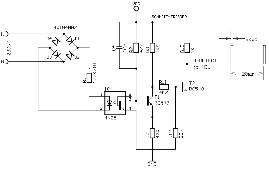

save my optocoupler 4N25
vinodquilon
Pls find the attachment of a self-explanatory telephone ring detection circuit.
The problem is that my 4N25 is not secure.
'After' four or five times of operation, it destroyed itself.
Then I replaced it with another, but same fate.
I think the protection circuit of 4N25 has no better immunity against high ring volt.
Any suggestions to rectify my problem ?

The limiting devices should keep the current through the opto LED down to 3 ma and the LED will only support 2 or 3 volts, so voltage should not be a problem. I suggest that a part of the limiting circuit has failed. For instance, if voltage is eating the opto, then diode D2 must have failed.
Hi vinodquilon,
it is most unlikely the telephone ring signal will exceed 60V.
Here is 0-crossing unit connected to mains via a bridge rectifier and a current limiting resistor directly to the diode of the 4N25.
I haven't experienced a damage optocoupler till now.
Use an 18K/1W current limiting resistor to fit your needs for the ring signal. The resistor has to dissipate ~375mW.
Boncuk
To sumarize Boncuk's post, ring voltages are commony over 100 volts.
Oops, forgot to mention that 60V apply to the ring signal in Germany pretty precisely for remote impedance check :)
However "over 100 volts" could also be 1,000V - so the info is a bit vague.
The 4N25 works reliably from 5 to 40mA LED forward current with sufficient CTR.

I would suggest checking the wiring very carefully, then a base resistor of maybe 1 megohm from base to emitter.

I set-up the same circuit again on a separate bread board with all new components except 4N25.
The circuit was fine for the first few checks, again the problem arises. That is I cannot get +5V
at pin4. This seems to be the problem is not with opto.

Hi Boncuk,
When I set-up 0-DETECT-SCH, I got constant VCC continuously at pin 4 when Ringing occurs. But I would like it to be of on-off pulses. ON pulse indicates the presence of Ring volt.

The way to test the circuit is this:
Connect everything up and leave the input to the optocoupler open.
With a 12v supply and 1k resistor plus 10 pot, reduce the resistance to the LED and see when the voltage on the emitter starts to rise. I would put a 100u in place of 1u to see this effect.
The problem is this: The optocoupler needs more current to illuminate the LED to turn the transistor on sufficiently to charge the 1u.
I always put the ring voltage through a bridge as you don't know the polarity of the phone line. Some phone lines actually change polarity!
I have done the same thing with an 8 pin PIC and a few components. It is much better to time the rings rather than count them. I would also join 5 6 7 outputs to get a more-reliable result.
Did you also use the Schmitt-Trigger as posted? I use it for extra short pulses to compensate mains frequency variations to fire a 40A triac timely.

It was the problem with Telephone jack as I cannot measure ring volts at the time of ringing.
Now all problems cleared.
Thanks everyone for their patience support.
Now we can close this subject.
CI tantalum, electrolytic is not avail.
That is your problem. Assuming that you mean C1 instead of CI, it should not be tantalum or electrolytic. It should be a film capacitor rated at 150V or more.
