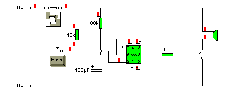

Hiya, I am currently in the process of designing and building a bike alarm for my GCSE systems and control project. Basically my idea is an alarm that is triggered when a thief sits on your bike seat, I would like to build my own circuit and house it in a vacuum formed shell that slides underneath the seat rails. I am just struggling to find a suitable circuit diagram. I want the circuit to consist of a buzzer that is triggered by the compression of the foam on the seat e.g. micro switch or a reed switch and then de-activated by a key switch. I would like the buzzer to stay on for a certain time or until the circuit is turned off by a key switch and finally I would like it to be run by a 9V battery. Any help would be gratefully appreciated as the project needs to be completed by the 2/4/04. Thanks, Ollie.
You are a little late, since it is 3/11/04 already! A simple series circuit will work, battery, buzzer, SCR, and keyswitch. A microswitch and resistor is used to turn the SCR on, the keyswitch turns the buzzer off.

Yes I do live in the UK and my project needs to be completed by the 2nd April. I think I already have the components to complete the circuit I need. I have a 555 timer which I would like to make the buzzer stay on for about 30 secs. I also have the buzzer, keyswitch, circuit board, reed switch (I think a microswitch would work better though) and a 9V battery snap. Does anybody have any circuit diagrams that would be suitable and allow the buzzer stay on for a certain time after the microswitch activates the buzzer? Further help would be greatly appreciated! Thanks, Ollie.
I will draw something out later, but you are a little late for it (I hope you have already done the paper based coursework to go with it)

Here it is, just replace the on/off switch with a keyswitch and the push button with your micro switch (in such a way the contacts close when the bike is taken), the duration can be changed by increasing the size of the capacitor and the resistor it charges though, I belive the formula is time (s) = 1.1 * r (ohms) * c (farads)
The diagram is not the best In the world, it was drawn quickly and it shows juts a basic 555 monostable circuit, I belive this is what you are after?
Adam

Thanks alot for the circuit diagram Adam, it looks like the sort of thing I need. I will have a go at completing the circuit tomorrow and let you know how I got on. Thanks, Ollie.
