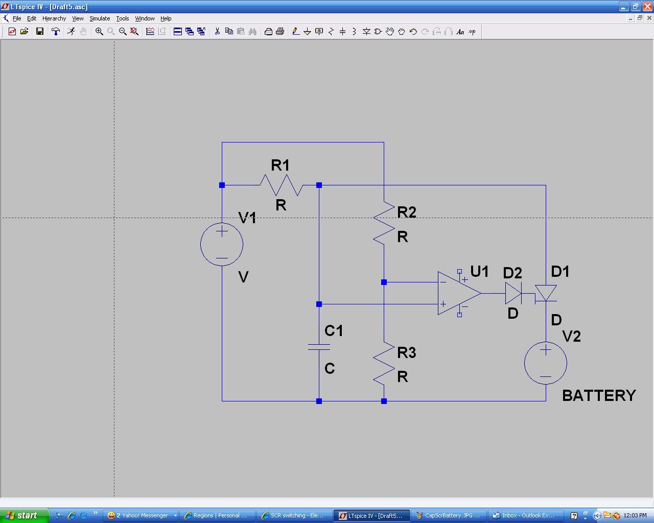

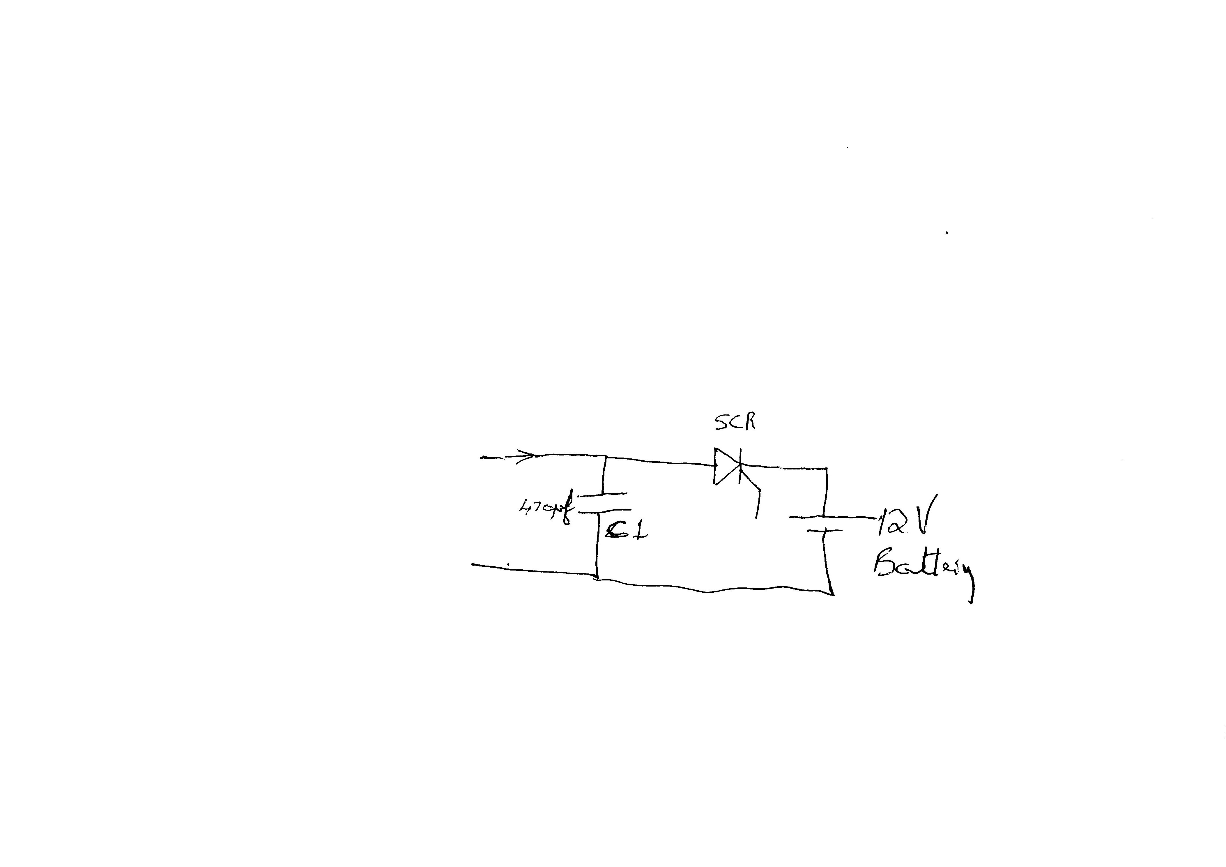

Can anybody tell me how to switch a scr on, to dicharged a capacitor into a battery as soon as the voltage in the capascitor reach a certain voltage, say 23V. The cap gets charged from a external generator and bridge rectifier. See diagram

Well, just a few things that hit me.
One, you really ought to be charging the cap through a resistor.
That arrangement can be used to bias a transistor when the potential across the capacitor reaches your desired value. The transistor could switch your SCR I suspect.
I've never designed an SCR circuit but I imagine this is the gist of it.

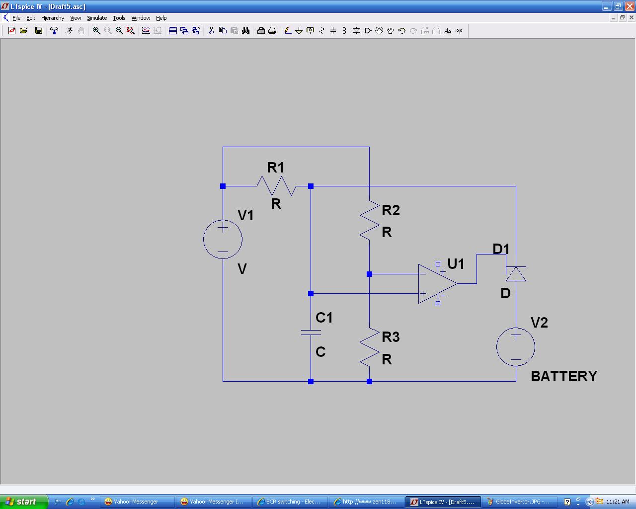

Something like this might work. R2 and R3 sets the level to fire the SCR, which is modeled by D1. I'm not an expert in SCR circuits either, so I encourage you to continue to get input.

The anode is the positive lead on a SCR. An SCR blocks in both directions when off and conducts in the forward direction when fired. Thus the cathode would need to be connected to the battery plus terminal in BrownOut's circuit.
The gate of an SCR is referenced to the cathode, so if the cathode is connected to the battery + terminal the gate trigger voltage must be equal to the battery voltage plus the gate firing voltage. In that configuration you would also need a diode in series with the gate to avoid excessive reverse bias of the gate from the battery voltage.
Heh! Well, I didn't have the patience to look through all the libs for it. One other thing, the SCR might be sustained through R1 in my diagram. Careful attention should be paid to this resistor value to advoid that situation.
Op amp comparator is a good idea

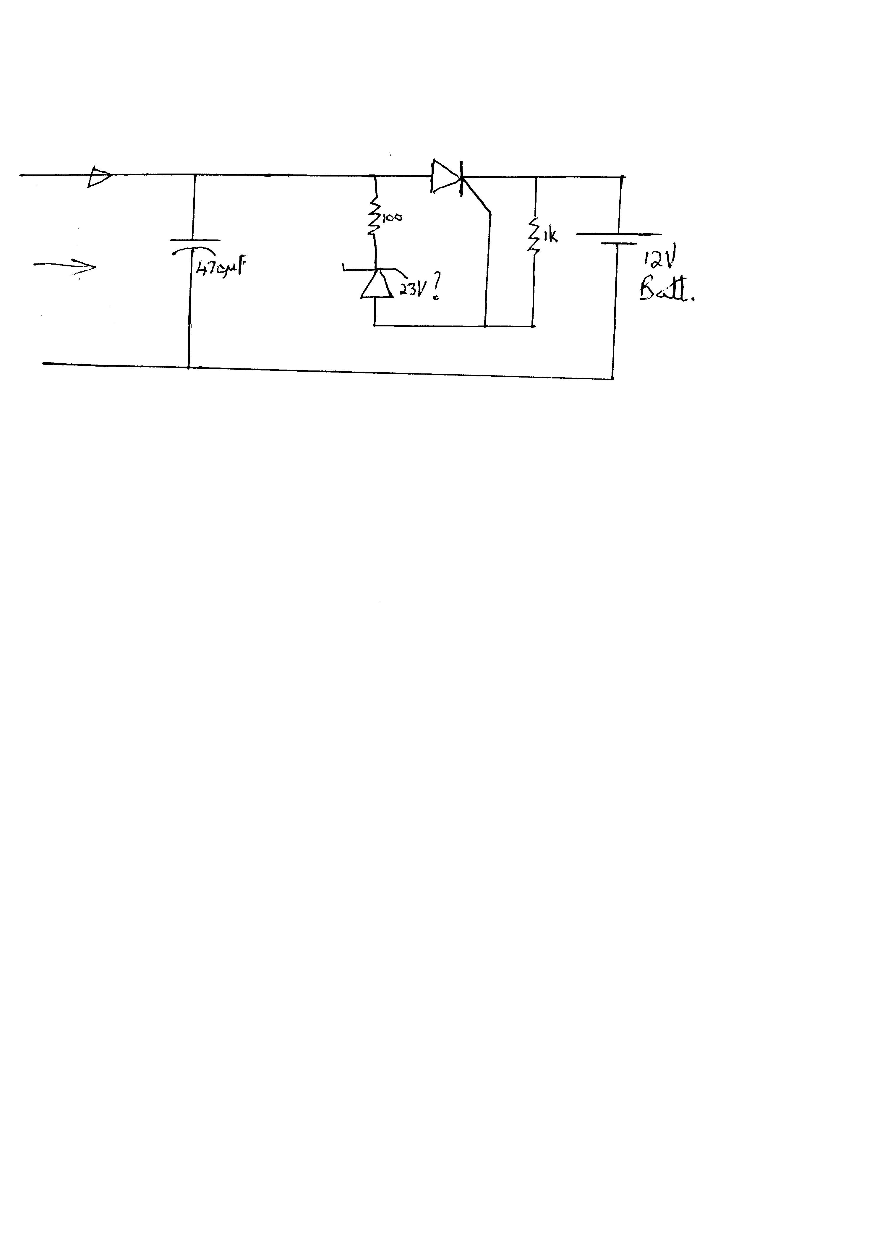

It gets easier if you define it so that the SCR triggers when the capacitor is at a specified voltage greater than the battery. Suggestions so far have addressed your original requirement assuming you meant the 23v was referenced to (V-).
Your original circuit would work, with a zener from the SCR anode to the SCR gate, A resistor (1k) from gate to anode is also suggested to reduce false triggering. A resistor (100R) in series with the zener might be a good idea to limit gate current.
Thank you. Do you mean like on this diagram?
How will I choose the value of the zener?
Can you please describe how this circuit functions
My bad!!! I said resistor from gate to anode, I meant gate to cathode.
If you want the circuit to trigger at 23V, the zener would be (23 - 12 - 0.5) = 10.5V. (Nearest value might be 10V +/- 5%.). The 0.5V is approximate for the the gate voltage. Recalculate if your battery voltage will be different (like 12.8, etc.).

Great. I will try it a bit later. The previous did not trigger.
