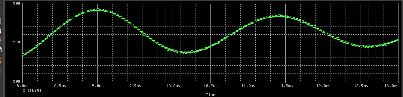

Here are the waveforms after the stabilization at the desired output voltage level :
current on L24 :

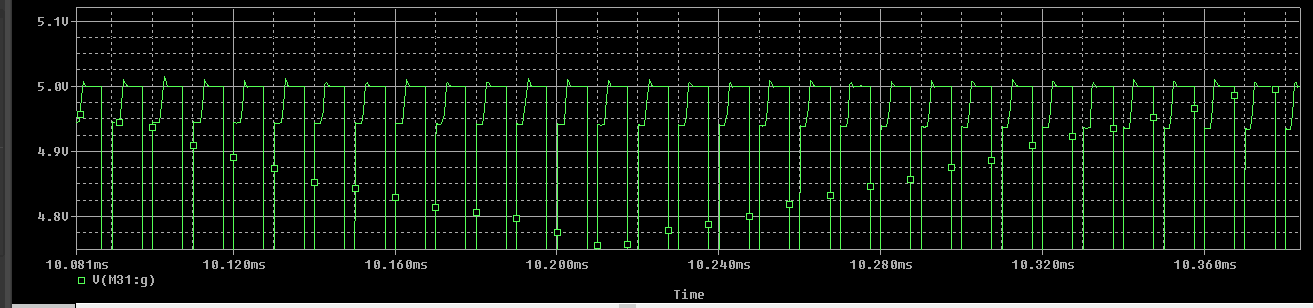

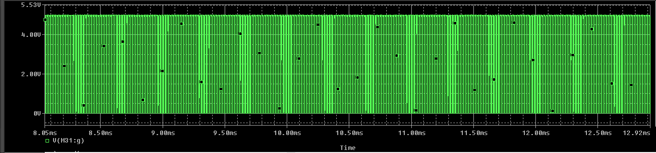

gate voltage :

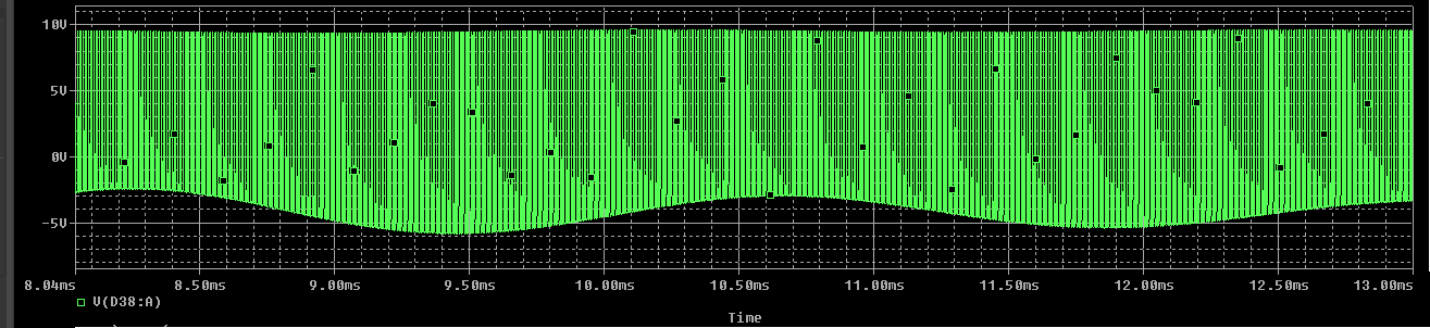

drain voltage :

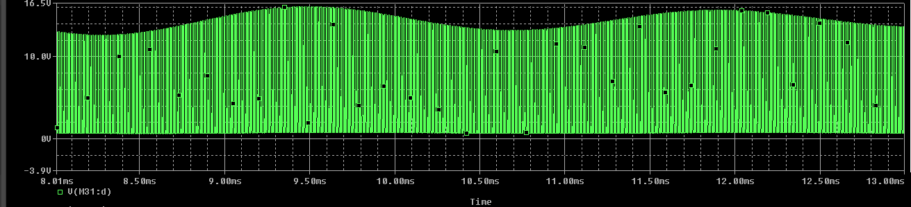

and the diode anode voltage :
These voltage wavforms look reasonable for an open loop converter. The L24 current looks excessive, although I don't know what your load is.
But the voltages within the waveforms are nowhere near those on your schematic of post #3
What's changed?
PS. The time windows shown are wider than is useful to see the basic operation. I'd prefer a window of 5 or 10 cycles.

The load is three DC-DC converters connected on the output of the SEPIC.
I didnt change many things. Post #3 is to show the schematic so dont pay attention to the voltages.
In respect to the time, for what time for example you suggest to run?
