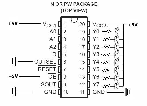

I'm new to electronics, and am trying to use a serial to parallel ic (TI SN74LV8153N) to light some LEDs. I've been having trouble, so in order to debug I've removed the serial portion of the project and am first trying to get the SN74LV8153N to drive all 8 pins (Y0 - Y7) high in order to turn on all LEDs.
The datasheet for the IC can be found here:
https://datasheet.octopart.com/SN74LV8153N-Texas-Instruments-datasheet-131714.pdf
Now according to the Function table if I hook outsel to low voltage, and OE to high then Yn (for n 0-7) should go high, but that isn't happenning.
Here is an image showing how I have it hooked up:
schematic-gif.35273
I am using a 9V battery hooked up to a 5V voltage regulator to supply the power and ground lines. I've tried hooking up the extra pins to ground (I'm not really sure what the best practice is for unused pins), and have verified the leds are hooked up correctly (supplying a +5V current to the anode turns on the LED), and have used a multimeter to see that Y0-Y7 is at 0V. Is it possible that this is getting messed up because I'm delivering too much current to the IC? Any other ideas?
I'm a complete noob so feel free to tell me that I'm dumb, and where I messed up.
Typically unused Inputs are tied to ground (or in some cases Vdd) but there are special circumstances. For instance when a chips pins can be configured as inputs or outputs.
How are you trying to send data to the SN74LV8153N? The LEDs will remain off unless the proper data is sent to turn them on. What do you have the chips address set to? Does your serial data reflect that setting? Judging by your picture OUTSEL should be High.

A resistor is not typically needed, either way. Open collector means the pin will only sink current or not, it does not output a high signal. The LEDs would have to be connected in the opposite direction in relation to your picture above and connected to Vdd not ground.
So you're connecting via a terminal on a PC? The datasheet does say the device is UART serial compliant but the data being sent is important of course. Are you just typing into the terminal? Are you sending data according to the chart in the datasheet?
You Must first send the device address and then the data. Have you tied the address lines to ground? Vdd?
As JimLovell says above:
"The LEDs would have to be connected in the opposite direction in relation to your picture above and connected to Vdd not ground."
Your data sheet indicates that when OUTSEL is low, as you have it, the Y's will be low, which means they are sinking current. I bet if you turn your LEDs around, you'll see some results.

It looks like the register you're using uses a very specific (and non standard) 10 bit serial frame two of which are needed to set all 8 bits, it's on page 3 of the PDF. I'm not sure if you can even generate that with an RS232 serial port?
Before you continue on the serial data side of things either switch your LEDs around and tie them to your positive power connection or set OUTSEL high by tying it to positive power.

The datasheet on the 3rd row of the function table says Outsel Low, Reset X, OE High, Dn X, Yn = High in Open Collector mode (which means all Yn pins should be sinking current... Right?). Am I reading that wrong? Does "X" in that table mean it doesn't matter if it's set to high or low?
jimlovell777 / AllVol:
I tried hooking the positive end of the LED to +5V, the negative end to a resistor and then that resistor to Yn. Still no light.
Correct, X means doesn't matter/don't care. Putting little thought into the situation your program should never send any number lower than 128. The start condition is low followed by a high with 7 data bits and a stop bit. To create the high start bit 128+ must be sent. Your number range with a device address of 000 is 128 (all LEDs off) to 143 (all LEDs on).
Have you done this? It's important.
mneary:
I have tried that yes, but still didn't see any lights on the leds.
jimlovell777
I'm tearing this off the breadboard I have it on at the moment, and putting it on a larger one so I can clean it up a bit. I'll try tying reset high, and see if I can see SOUT ever goes high.
