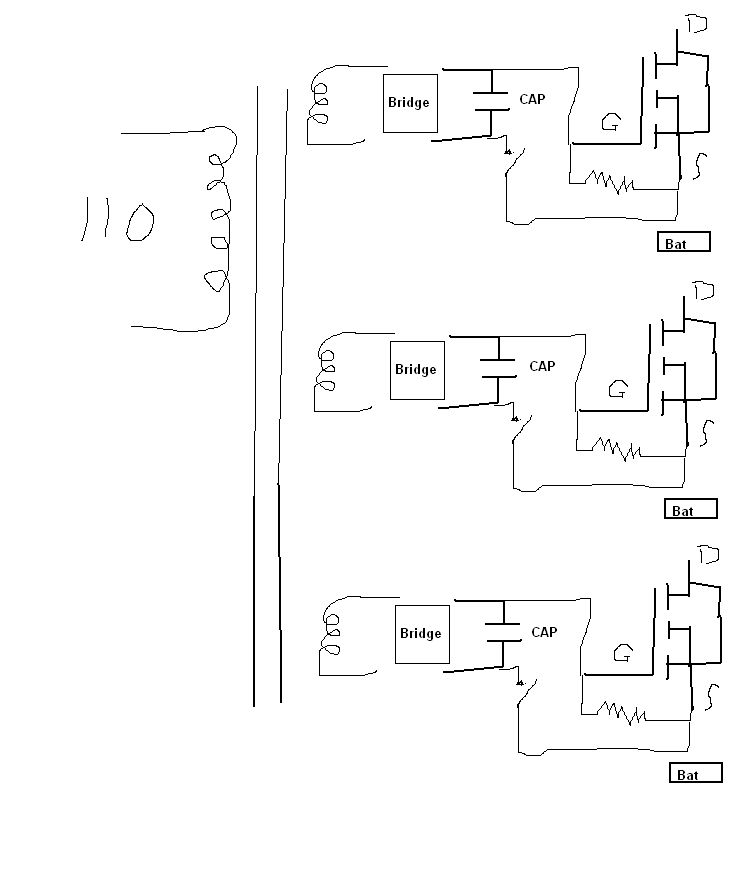

I thought I explained the reasoning behind the series connection of the Mosfets: I will like to connect 2 cells ( to achieve say 4V), 3 cells (6V) etc to drive some load. However, I do not want to solder the cells together. I want to be able to electronically connect and disconnect them.

if I decide to connect just 2 cells , for example, I can bypass the 3rd 4th cell etc by connecting the 2nd cell to ground. The last cell will always be connected to ground. Once again, the issue is: HOW TO CONNECT MOSFETS IN SERIES.

Then it would make more sense to connect all the cells in series and follow them with an adjustable buck switching regulator. That way, all cells will get discharged evenly. Your method could result in some cells becoming fully discharged while others remain fully charged. If these cells are then all used in series, the discharged ones will get reverse charged and be damaged.
Using your second drawing in post #6, you will need to keep your drivers completely isolated from each other, assuming you have to have what you drew up. Something like an isolation transformer with multiple secondaries to supply isolated power to driver. Then I can see it working ad drawn.

edit, with the proper polarities observed, something like this may work, no secondary grounding.

Another thought, if you had 3 cells and 3 Fets feeding a 6 volt lamp, and you want to reduce the voltage to the lamp, as soon as you drop any one cell, the lamp goes out because they are in series.
You would need all the cells actually in contact with each other and then take the power from between 1 and 2 or between 2 and 3 etc. and turn off one fet before turning on the next fet and have the out put of each fet tied together and to the lamp.

We've told you before, that will not work, as soon as you open one switch, the circuit will disconnected.
You could use P-channel MOSFETs and Schottky diodes but there will be a considerable voltage loss.
The best way is to use a an adjustable switching regulator as described above. That way, the batteries will all discharge at the same rate and you'll have a higher Ah capacity at the lower voltage settings.

With power fets (read: with the body connected internally to the source), always keep the source at the common (GND/-V in case of N-FET or Vsupply in case of P-FET). Othewise you are going to have the FET Body-Effect-> Reduced gain due the body connected to a floating voltage or a voltage different than 0V.
