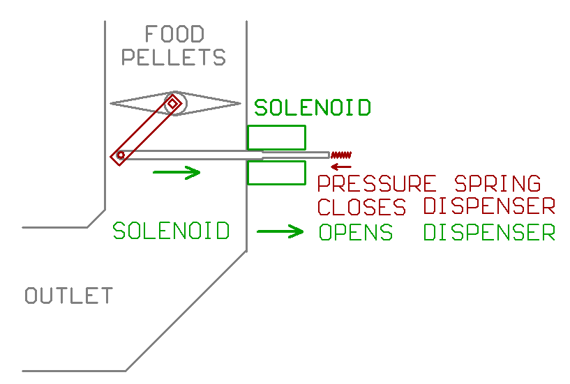

Why overcomplicate things?
Use a simple solenoid to open the food dispenser. No counting, no motor and no accurate stopping position required for the solution as drawn.

Thanks for the image, however the design needs to be able to supply both wet and dry food, multiple times.
