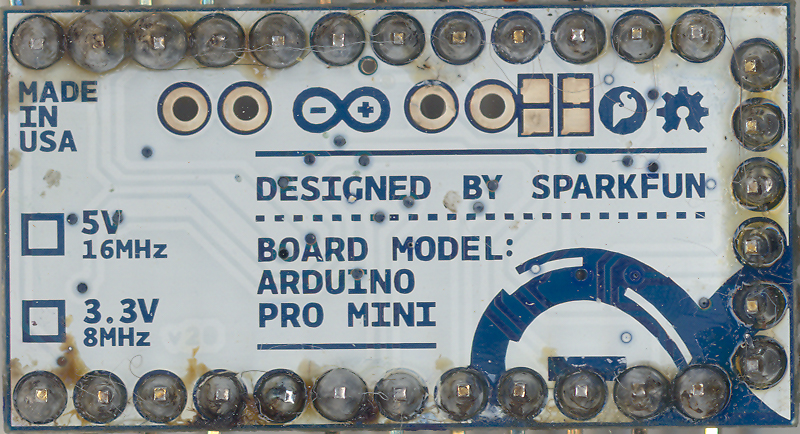

Edit, the solder pad should be bridged to power the board.

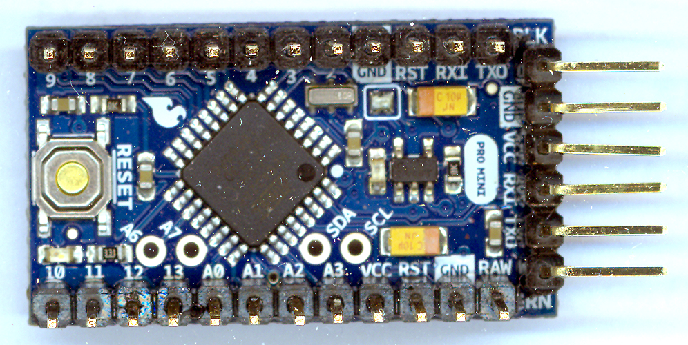

I reconnected the power LED. Please see image.
What should be bridged?
Do you mean the LED pad?
In the schematic it's labeled SJ1 but your board doesn't have any component names. The only thing that looks like a solder bridge is the thing in the white box near the top GND pin. If that is the bridge then it should be connected to pin 5 (top left) of the regulator. The bridge is there so you can disconnect the regulator and use a more efficient one for lower power usage.

I had my Arduino Pro Mini connected wrong and now have it running again so I guess I am now back online.
I have also disconnected the the power LED.
My AmpMeter is connected to the RAW voltage input feed by the batteries.
Adding this code, the power usage dropped from 20.4ma to 16.5ma.
