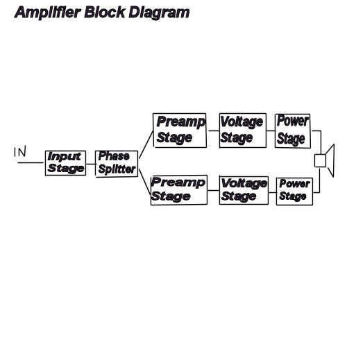

Does anyone have an idea how to make a hi-fi audio signal splitter (It accepts one input and gives a inverted and noninverted output). I am going to use it for my audio amp project and I would like it to be simple and with discrete components. A MOSFET version would be good, too.

It's Internal.
Bridged because the output power will double, and with 2 identical output stages, the output bias voltage is the same, with the voltage the same, there is no dc through the speaker. And because of that, I do not need output capacitors that act as high pass filters, witc means more bass.

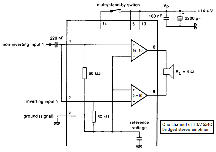

A TDA1554Q bridged car radio amplifier IC doesn't have a phase splitter. One of its amplifiers is inverting instead.

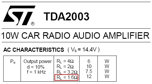

Car radio amplifier ICs don't have enough supply voltage for much power, so they use a high amount of current into nearly a dead short to make a lot of power.

The amplifier is a class-a complementary wich I will build from scratch, the speaker is a 8ohm 5.25'' woofer with a 8ohm 1'' dome tweeter that has a series 4.7uf polyester film capacitor. Also I only have a single-supply up to 20V.
