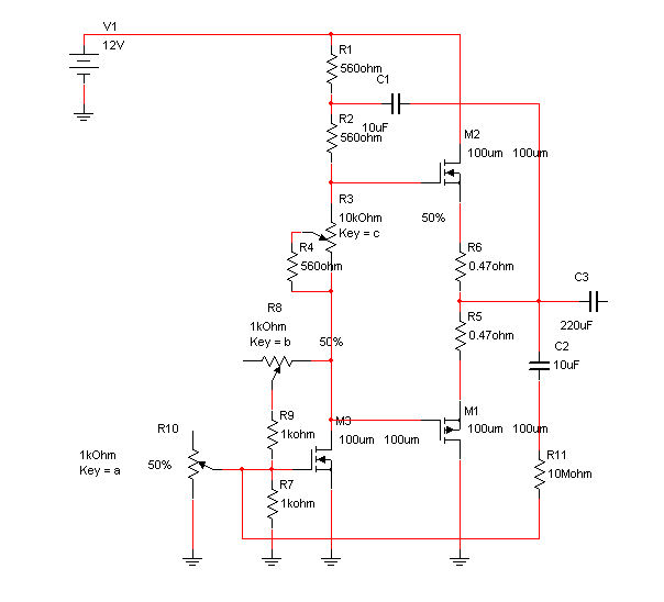

Yesterday I spent the day making a "crude" mosfet amp with complementary mosfet output stages, mosfet voltage/input stage, negative feedback, and bootstrapping; and it probably sounded better than anything I ever herd, despite the slightly low volume. It uses a single-polarity 12v supply.
Your Moset amp's voltage divider of the 10M resistor feeding less than 300 ohms eliminates any negative feedback.
EDIT: Its tiny 220uF output capacitor cuts 91Hz to half power and cuts lower frequencies much more.

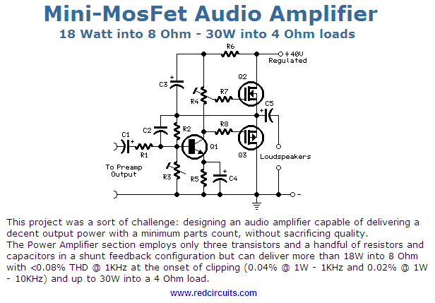

Here is a pretty good very simple Mosfet amplifier.
