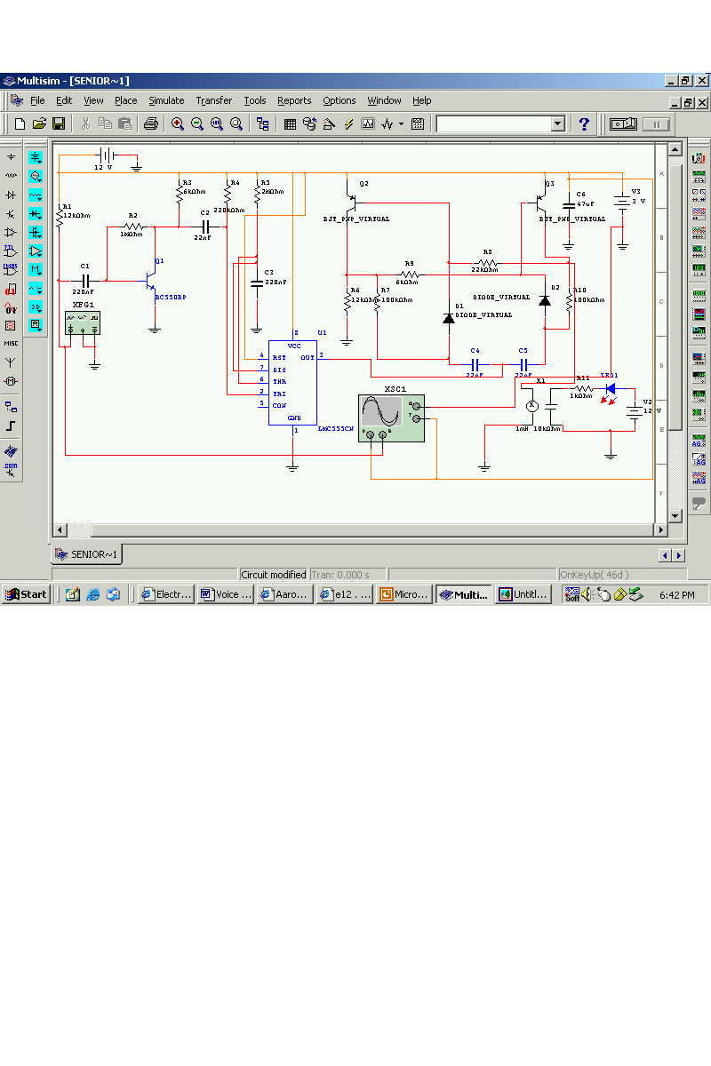

What about now. I really appreciate all your patience and help in this matter.
Your circuit is getting better and is nearly ready to work.
The battery is connected instead of a microphone. Use the signal generator at the input and put the battery at the very top line of the schematic.

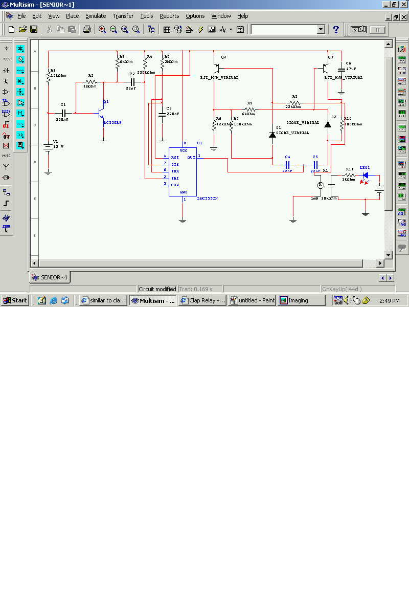

Okay i did that but its telling me that i have a error to voltage sources in parallel

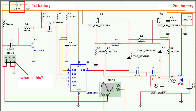

You have two batteries in parallel. Only one of them should be there.
Also there is a box that I don't know what it is.

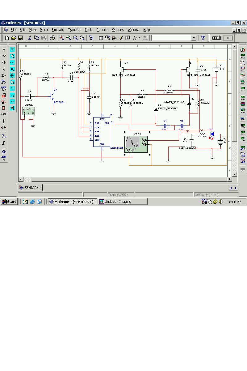

Yes! it did work.. just one question.. do i have my oscilloscope connected correctly
Thank you so much for your help. I don't think i would have got it done anytime soon without u. Know I just have to figure out my componet values. thanks
