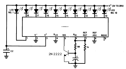

i found one design from datasheet.and another from net http://www.cpemma.co.uk/bargraph.html
if i remove the VR1 from above design and place a CAP(10uf),will it work?

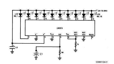

and below is the modified ckt

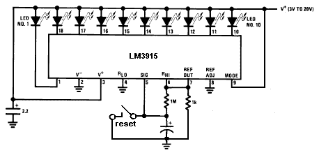

I modified the circuit so the capacitor charges by the 1M resistor. A 10uF capacitor will fully charge in about 10 seconds. The switch resets it.
It uses an LM3915 so that the capacitor seems to charge in a straight line. An LM3914 will have the capacitor begin to charge quickly then slow down near the end unless it is charged with a constant current source transistor circuit.

if i use transistor circuit to charger the CAP can i avoid the reset switch.
some how i have to avoid the extra input imean resetting the switch.
You don't need a reset switch. You just need something to completely discharge the capacitor when the power is turned off. The way it is now the capacitor might never completely discharge. Then the next time it is turned on the LEDs won't start at the beginning.
A constant current source transistor circuit can charge the capacitor so an LM3914 can be used, instead of using an LM3915 and just a resistor to charge the capacitor.

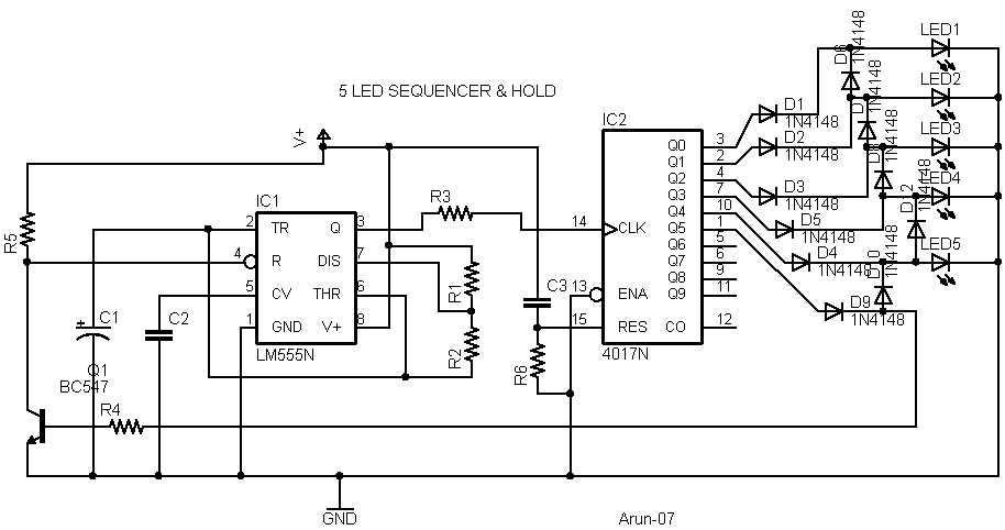

Hello Fever !
i have drawn this circuit which will do exactly what you wanted, using 555 + 4017.
on the sixth clock pulse,Q5 output of decade counter holds the LEDs on and the transistor is turned on to pull RESET pin 4 of 555 down to GND, thereby stopping further clock pulses from the timer.
without further clock pulses, the decade counter will not advance.
you can figure out the values of resis & caps your self.

thanks a lot arun.
i'll try it.but i wonder do we really need so many 4148's at outputs
hi-tech city,india-may be i know u.iam from HYD
Hi Fever,
Good to know,you too are from HYD,India.
yes, you will need the blocking Diodes at the O/P, bcoz you want the Leds in a particular sequence. with out these diodes the LEDS seq. is disturbed.
