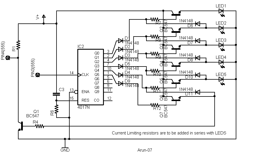

Hello Audioguru,
how about my revised circuit, does this solve the problem?;)
Fever, don't get scared by the number of Diodes, its a simple circuit and costs less than LM3914 IC
you also have learned about using RESET Pin of the timer.:)
best of luck
Modifications Welcomed!
arun

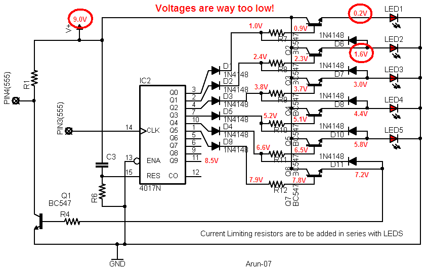

Hi Arun,
With a brand new 9V battery your revised circuit doesn't have enough voltage for the first two LEDs when they are all on. Also, when the battery voltage quickly drops to 6V then most LEDs won't work. The LEDs will have changing brightness. The transistors should be common-emitter. R12 and Q7 are not needed.
Your circuit also has too many parts to light only 5 LEDs.

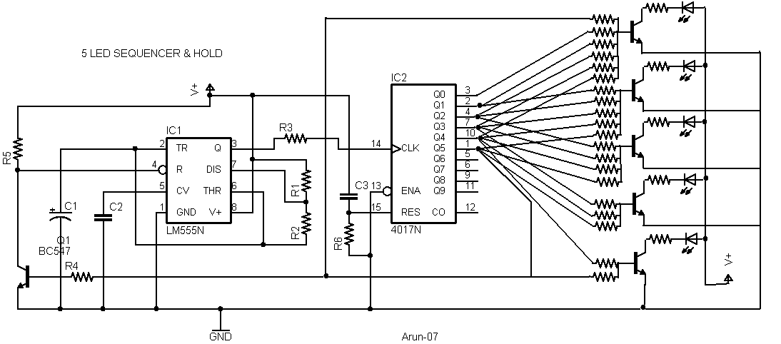

Sort of..... How about a little RTL logic?
31 resistors, 6 transistors, a 4017 and a 555 just to replace an LM3915?
It DOES seem silly unless the OP can't find a LM3915 or 14....
If I was to do it with logic ICs I would have chosen a shift register, grounded the serial input, puts the LEDs on the parallel outputs, and clocked with the 555 etc... That would eliminate the RTL logic, but it was a fun birdsnest to mod. :D
