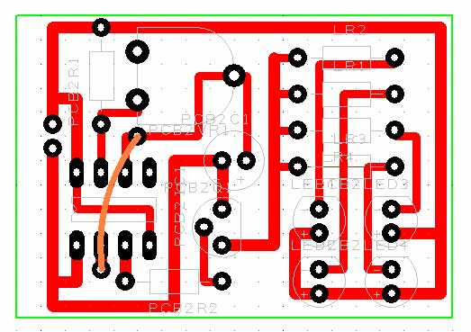

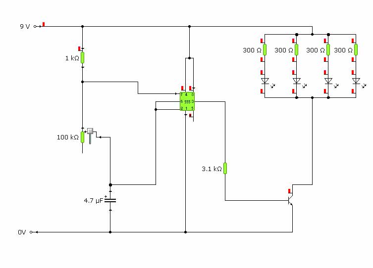

Im trying to design a PCB to make a simple 4-led strobe light, with a 555 timer chip. I have made the circuit on a breadboard several times, and have simulated it in croc-clips, however when i make the pcb, flip the design and etch it it just doesnt seem to work. All the pins of the 555 are correctly in their positions when i solder them.
The only thing that happens when i turn the circuit on is all the leds simply turn on. (this is mildly better than before, when i didnt flip the image, the 555 timer just got really hot!)
could someone please take alook at the attached pics and tell me whats wrong with the PCB i have designed. Its driving me mad, as I cant work out why the circuit does not work.:mad:

I'm not really qualified to advise, so take me with a grain of salt, but it looks like your control voltage pin isn't hooked up to anything. I think you want it grounded with a 0.01:mu: cap. Hopfully one of the pros can verify this.
I only glanced at the PCB design, but it looks fine. I haven't seen the PCB itself, so I couldn't tell you if thats ok :o You should go over every connection with a continuoity tester on your PCB, to check that everything thats meant to be connected, is connected.
And when you 'flipped' the design...what was this for? Press'n'peel tranfers method? photoetching? I guess it doesn't really matter if its mirrored horizontally or vertically, but make sure its mirrored! I assumed that what you meant when you said 'flipped' and that would be for the transfer etching method.

Well, now I am curious about pin 5. No one has corrected me yet, but last summer I made this circuit on solderless breadboard, and was pulling my hair out because it did the same thing, led was steady on. I tried all kinds of stuff before I connected pin 5 to gnd. and once I did, if worked fine..... I don't think I had a cap in there either, just a wire. :confused:
I think you have the transistor in wrong. What kind is it? Check the pinout. If the base is in the hole that goes to the LEDs, the LEDs will be on all the time.
Yeah, I have to agree with andy1845c on this. PIN 5 is not connected to anything. I would certainly try connecting it to ground through a 0.1uF cap. On all the 555 flasher circuit's i've seen, pin 5 is grounded through a small cap.

When i design in RealPCB the components and tracks are on the same side. this is why i needed to mirror horizontally, to get pins of the 555 in the right place when i put it on the back of the board (where there are no tracks).

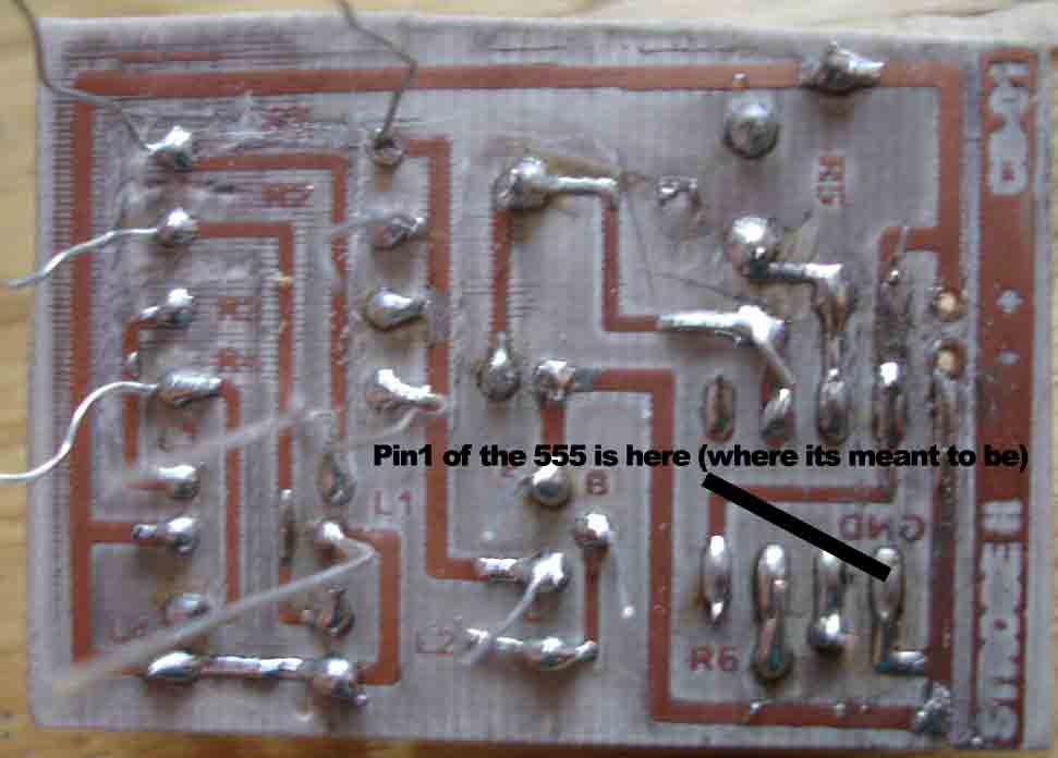

I used the photo resist method to produce this board, but i didnt develop it for long enough, so little lines of copper were left connecting tracks, which i scratched off with a stanley. I then cont. checked tracks before i started soldering, everything appeared to be in order.
I have left component leads long, so that i can easily remove them if this doesnt work, however i ensured that they were not shorting anything when i connected the power.

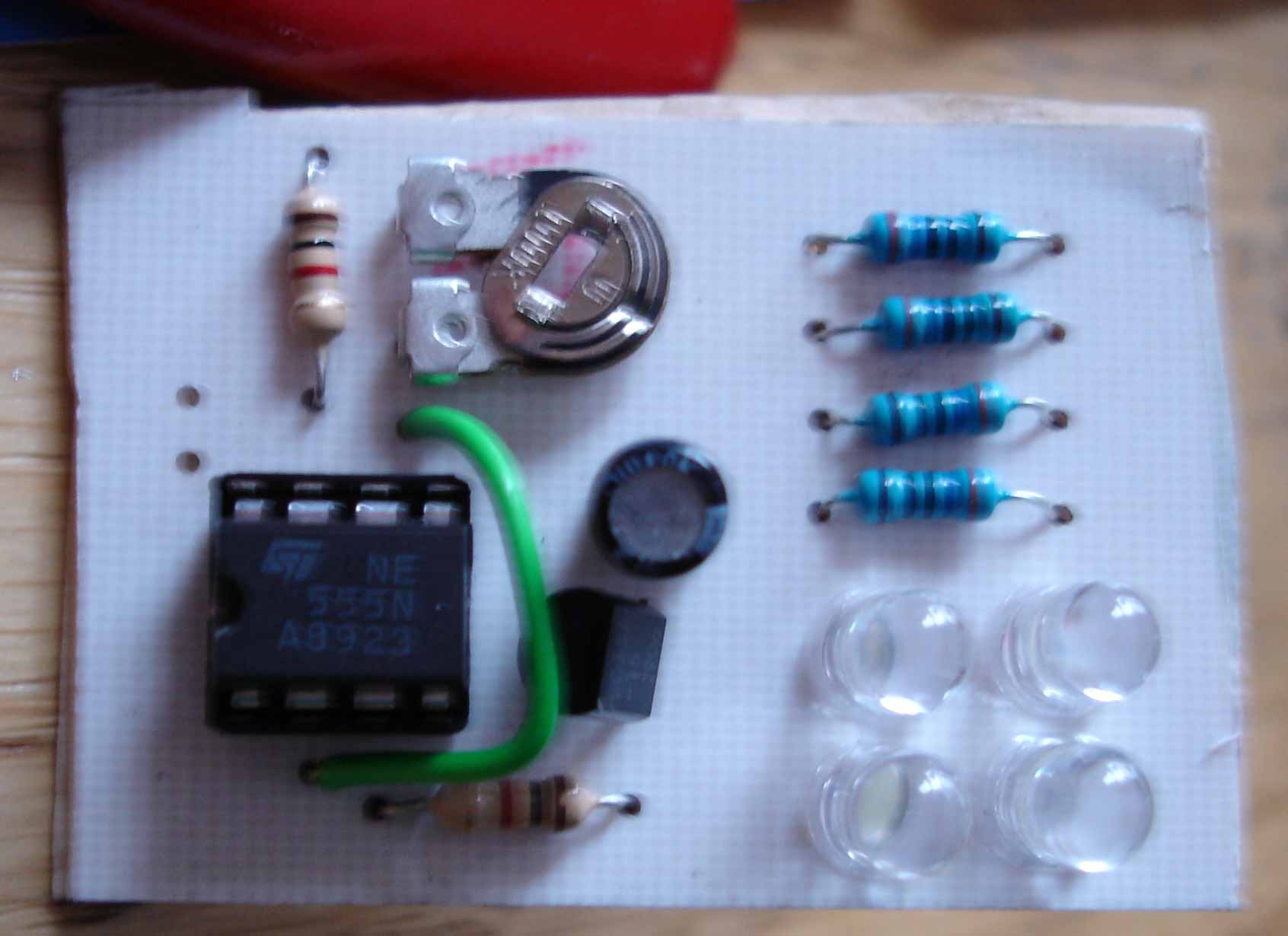

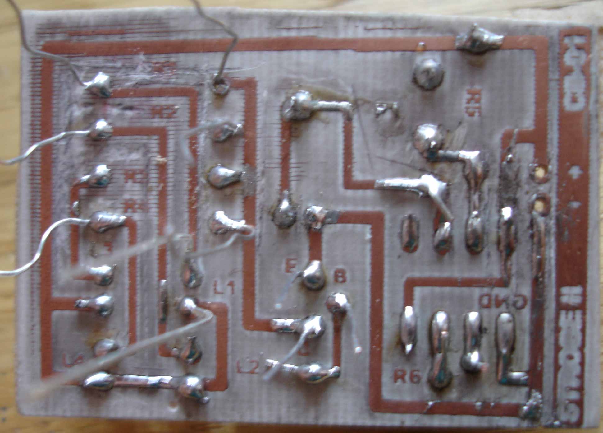

I have included pics of component side, and of track side. I apologise for the shite quality of my photos, my camera sucks, and ive compressed them heavily for users with slow connections;).

Checked pcb and circuit, as already stated you have a 0.01uF on pin 5, otherwise looks OK. Can't check the orientation of the transistor.
Whats the transistor type you are using ?. Depending upon the LED types it could be switching 100mA.
What LED's are using, there could be a more efficient way to connect them.
One point I would recommend when using a variable resistor as you are,
always link one end on the pot to the slider. As you know some pots can be a little noisy.
When one end of the pot is linked to the wiper, the maximum resistance in circuit never exceeds the value of the pot.

The reason I asked about the LED type, because your orginal circuit shows a +9v supply.

Is the pcb track view you have posted the component side and we looking at the copper track thru the pcb???

The pcb track view, is the view of the copper side, but the components are displayed on the copper side in the program also (this is why it needs to be flipped).

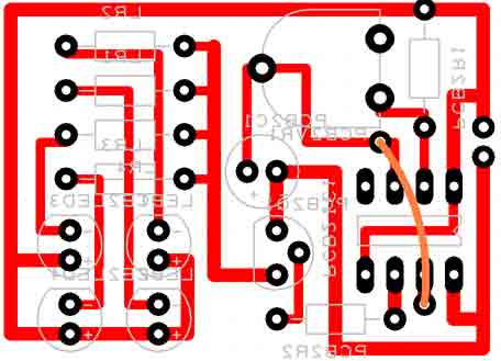

Have downloaded your pcb artwork, if I use my Paint Shop Pro to 'flip' it or 'mirror it' it makes the layout incorrect.
So it suggests to me, that I am looking at the track thru the pcb on your original layout.
Can I suggest you try the same in your PSP or equivalent.

Okay. Your transistor is wrong, but I had to wait for confirmation as to which side we were looking at. Just to prove it to yourself, look at your layout on the computer screen. Now, imagine an NPN transistor (TO92) between the thumb and forefinger of your right hand, with the flat face against your finger. The emitter will be on the bottom. Try to plug it. Yep, you have collector where emitter should be.
Well, first of all, it seems to me like the assembled board confirms that the artwork is OK. Am I missing something?
Did you look at the datasheet of the BC337? Collector and emitter are swapped relative to the "norm", like a 2N3904.
