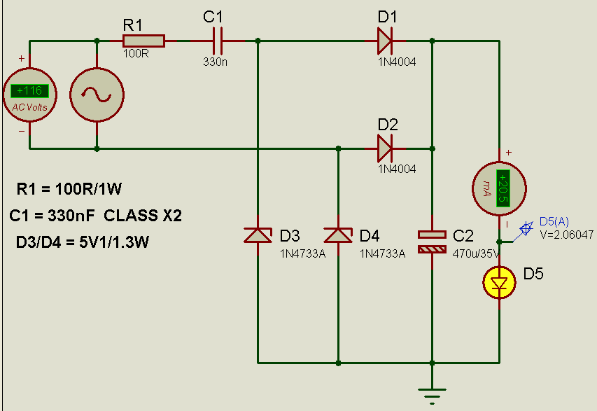

Hi delphijustin,
you might consider using that little circuit for safe LED operation.
Output voltage depends on C1 capacitance and D3/D4 value.
Note that the zener diodes are used like normal diodes.
Boncuk

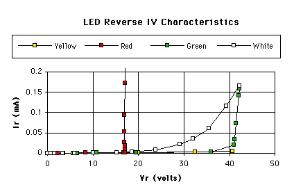

The reverse zener voltage can vary quite a bit from lot to lot of LED diodes. Get a batch with high zener breakdown of 10-12 volts and the power dissipation during reverse current times the higher zener voltage may blowout the LED. All the diodes tested for actual reverse breakdown in the graph had 5v breakdown voltage specs, which is a common 'boiler plate' spec for LED's.

Back to back LED's means two LED's in parallel with reverse polarity connection. Each conducts on alternate half cycles balancing the forward and reverse current through series capacitor.

I have seen many circuits with Zener diodes. I don't understand why. A LED is much like a Zener! I can't see why we need a Zener across a LED.

The purpose of the zener is to take the possible surge, particularly during a bounce connection where series cap get a double charge. A shunt capacitor also helps by damping out the startup transient surge.

You're definitely wrong on the second count ("or efficient"), and I challenge you on that point.
It's certainly more efficient to use the reactance of a capacitor to limit the voltage and current to the LED than using a resistor.
Do the math with my little circuit and you'll see how little power (essentially zero) is dissipated in the capacitor.

Well, you've done nothing to prove that this is a less efficient way to drive a LED from an AC power line than some other way. I'd go so far as to say that it's probably more efficient than using any kind of "LED driver" (meaning some sort of converter, like a buck converter), since all those have some losses (small, but not zero).

The wasted power that reduces efficiency in the simple circuit with a capacitor driving the LED is when the LED is in breakdown half the time with a reverse current that does nothing except heat the LED. Also, the breakdown voltage has no maximum so its voltage might be high enough to over-heat the LED.
