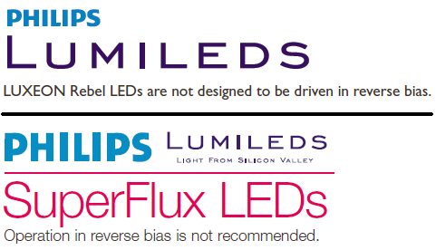

Philips Lumileds says that their LEDs are not designed to survive a reverse bias.
When this major manufacturer says DON'T Do It then don't.

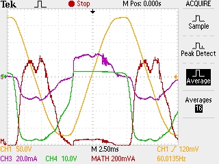

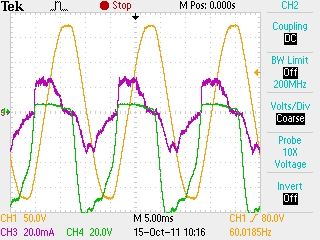

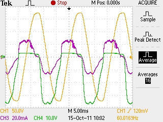

I have a bag full of hundreds of surplus LEDs from years ago, so I decided to make some measurements. Using a Tektronix TPS2042 scope with 4 isolated channels and a clamp-on DC responding current probe, I captured some scope images.
I connected a .47 µF X2 capacitor in series with the LED and connected it to the grid. I tried this several times and each time the LED worked right away; I didn't have any initial failures to illuminate. I disconnected and reconnected the arrangement to the grid numerous times and with any given LED, after several re-connects, the LED would fail, usually shorted.
In these images, the grid voltage is shown in orange, the LED (and capacitor) current in purple and the voltage across the LED in green.
The first image shows one of the LEDs in action. The green trace shows the voltage across the LED. The forward voltage is about 4 volts, and the reverse (breakdown) voltage for this LED is about 35 volts. The current through the LED is shown by the purple trace and is about 25 mA in both forward and reverse.
The second image shows that same LED, but with the sweep speed changed, and another trace turned on showing the instantaneous product of the LED voltage and the LED current. This is the red trace, and what is shown is the instantaneous power dissipation in the LED. I offset the reference for the red trace to the bottom of the screen, so we could more clearly see the difference in dissipation in the forward and reverse directions.
Horizontally, from about 4 cm to about 7 cm, the green trace shows the voltage across the LED as it conducts in the forward direction; it's about 4 volts. The red trace is about 1/3 cm above the bottom of the screen during this time; this is the forward dissipation in the LED.
From about .5 cm to 4 cm, the LED is conducting in the reverse direction. The green trace shows the reverse breakdown voltage to be about 35 volts. The reverse current is about the same as the forward current, but with 35 volts across the LED when the reverse current is flowing, the instantaneous dissipation is much greater. The red trace shows this dissipation peaking out about 5 cm above the bottom of the screen. This peak dissipation in the reverse direction (35 volts times 25 mA = .875 watts) is about 15 times the dissipation in the forward direction. This heats the LED and produces no light; it's not a good thing!
The third image shows another LED which has an even higher reverse breakdown voltage of about 80 volts peak. Imagine what the reverse dissipation would be!

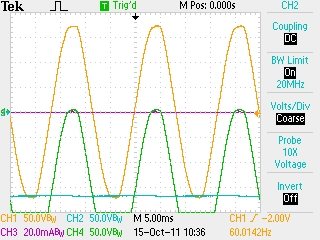

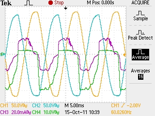

Here are a couple more scope captures.
The first image has an additional trace; a blue trace shows the voltage across the capacitor. The zero volt reference is the center of the screen (vertically), so you can see that the voltage across the capacitor goes from about 170 volts positive to about 170 volts negative.
The second image shows what happens when you put a 1N4004 in series with the LED. It's a little hard to distinguish between the green and blue traces, but the voltage across the capacitor is the horizontal blue line at -170 volts. The capacitor has become charged with a DC voltage equal to the peak grid voltage. This voltage opposes the AC voltage from the grid so that the voltage applied to the LED isn't able to go sufficiently high in the forward direction to turn on the LED.
The voltage across the diode/LED is still the green trace; now it doesn't go sufficiently high in the forward direction to turn on the LED. This shows that the LED wouldn't light up if it didn't break down in the reverse direction.
