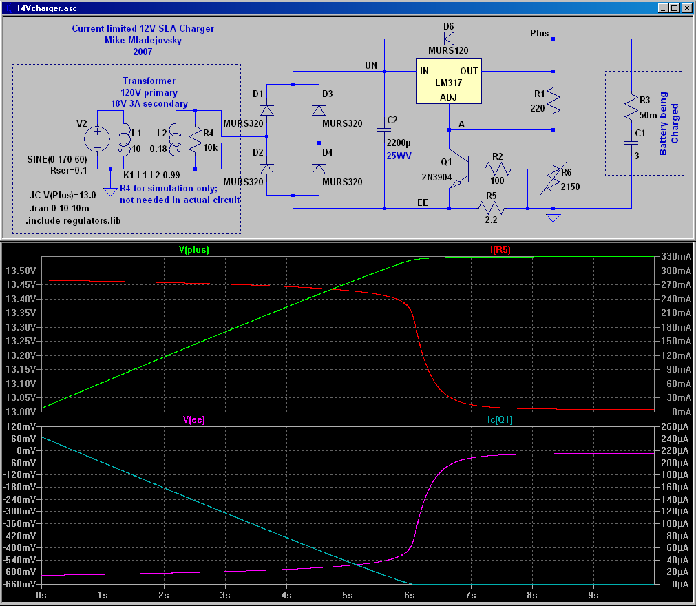

So just a quick question. I've built a LM317 charger based on **broken link removed** circuit using a 1.5 Ohm 5W resistor in place of the "see text" the idea being to achieve a peak charge current of 0.39A or less and after some testing on a battery running about 12v and the voltage of the charger set to 14v or similar it was pushing 0.6A out to the battery which is beyond the rate the battery can sustain... its a 1.3Ah battery.
Any ideas? I calculated the resistor value based on that article.

To get ~0.25A, R=0.6/0.25 = 2.4Ω
Note how this all comes together in the LTSpice sim, where I'm using a 2N3904 as Q1 and a 2.2Ω resistor as R5. Note V(EE), which is essentially the Vbe of Q1. Note that while Q1 is turned on by the drop across R5, its collector current Ic(Q1) is stealing current from the ADJ terminal of the LM317

Not sure how I buggared that simple equation up. Thanks for that mike.
Strange thing tho, I've changed out the resistor and installed a 2N3904 (I had a BC549 in there ) and set to 14v then applied to a battery that is at 12.5 (not flat but not full) and it initially put 1.2A out then settled at 700mA which is still far too high for the battery on hand. Any ideas why this is happening? the schematic is exact as per your diagram there asside from the input circuit, I have a 19v DC input to the LM317.
Cheers
Notice that there is only one ground in the circuit. The neg end of the battery is the circuit ground. The neg end of the rectifer/filter cap (labeled EE in my schematic) must be allowed to go below ground by about 0.6V. It seems that you somehow have a short across R5.
