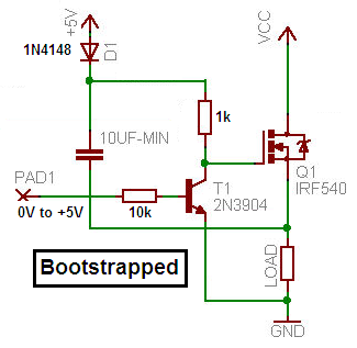

Hi all,
Have just finished a project for work that required a High side low Side N channel MOSFET arrangement so I used a great chip from International Rectifier the IR2106 High Side Low Side Driver and during the project understood how it worked. So whilst I was bored one day I was thinking how I could make my own simple version based on a Boost Strap capacitor the same as the IR2106 and have so far come up with this. It could be useful for some one for a motor driver or some fun project. So far I've had it controlling a PC fan from a PIC 16F628 in a high side configuration and its worked perfect but it might just be a fluke.
So here it is for every one to poke holes in and hopefully I'll learn some thing extra and we will have a little project for the forum and other peoples fun and games...

The emitter of the transistor drives the gate of your Mosfet. So boostrapping the collector won't do anything. The base voltage of the transistor limits how high the gate voltage will go and if the input signal is up to +5V then the gate of the Mosfet goes up to only +4.3V and it barely turns on.
The transistor should be a common-emitter instead of your emitter-follower. The logic is inverted but the bootstrapping will work when the Mosfet begins to turn on.

A couple of notes about the above circuits:
1) They will not keep the load powered indefinitely because the capacitor will discharge unless the load is switched off & on again periodically. Fine for a PWM circuit; bad for general purpose DC switching.
2) Audio's circuit will only apply 4.3V across the gate/source unless the anode of D1 is connected to a higher voltage such as Vcc.

I thought that originally, but a simulation says otherwise. With Vcc=20V, and a 10 ohm load, the voltage across the load switched between 0 and 19.8V, although the rise times are terrible due to the 1k pullup.
I don't think Audioguru was necessarily trying to post an efficient circuit - he was just illustrating the bootstrap principle.

I didn't mean that the voltage across the load that would be 4.3V, but between the Gate and the Source terminals of the FET which is OK if it is a logic level FET. This will also contribute to the crappy rise time in a real life circuit. eg as per your SIM: So when the FET is ON then there would be 19.8V on the source and 24.1V at the Gate meaning there is only 4.3V left to turn the FET on.
Probably not. More to illustrate the need for a common emitter config as opposed to the emitter follower posted by Clipo.

Audioguru's solution will work but only for AC, the capacitor will eventually discharge though the leakage in the electrolytic and MOSFET's gate.

Audioguru.. I cant seem to figure out how your boots capacitor would help since it would always be charged up to the +5V supply and not boost the supplt across the FET, I originaly was thinking about the arrangment you sugested but thought the emitter-follower arrangement would work and allow for the logic to be the right way around, how come the boost strap capacitor wont allow the gate voltage to go above the 4.8V since Im going to be driving some large FETs that require a larger threshold voltage and to also speed up the switching times..
Also I noticed you changed the diode on the boost strap how come you chose that one im just going to find the data sheet now.
kchriste.... Im planning on using the design in a PWM system and so the cap charge should be refreshed all the time, Im also thinking of a DC - DC converter and that too would be PWM but as you said it requires longer on times and could cause problems...
Ron H... I'm interested in what software package you used to simulate the design in so I can run my own simulations too, and if you could send me your simulation if the package is free/easily avaliable.
Alternative designs or ideas are welcome Im currently thinking about audioguru's design but adding an extra stage to keep the logic the right way around since Im initialy driving the design from a PIC.

I increased the supply voltage of the transistor so the Mosfet has enough gate voltage to fully turn on.
The capacitor charges to 11.3V then it boosts the gate voltage up to +23.2V.
You had a very slow rectifier diode that is made for 100Hz. I selected a very fast diode.

none of those is reliable ... eventually the base current discharges the capacitor.
they only work for PWM circuits that have some maximum duty cycle so that the off time can recharge the capacitor
