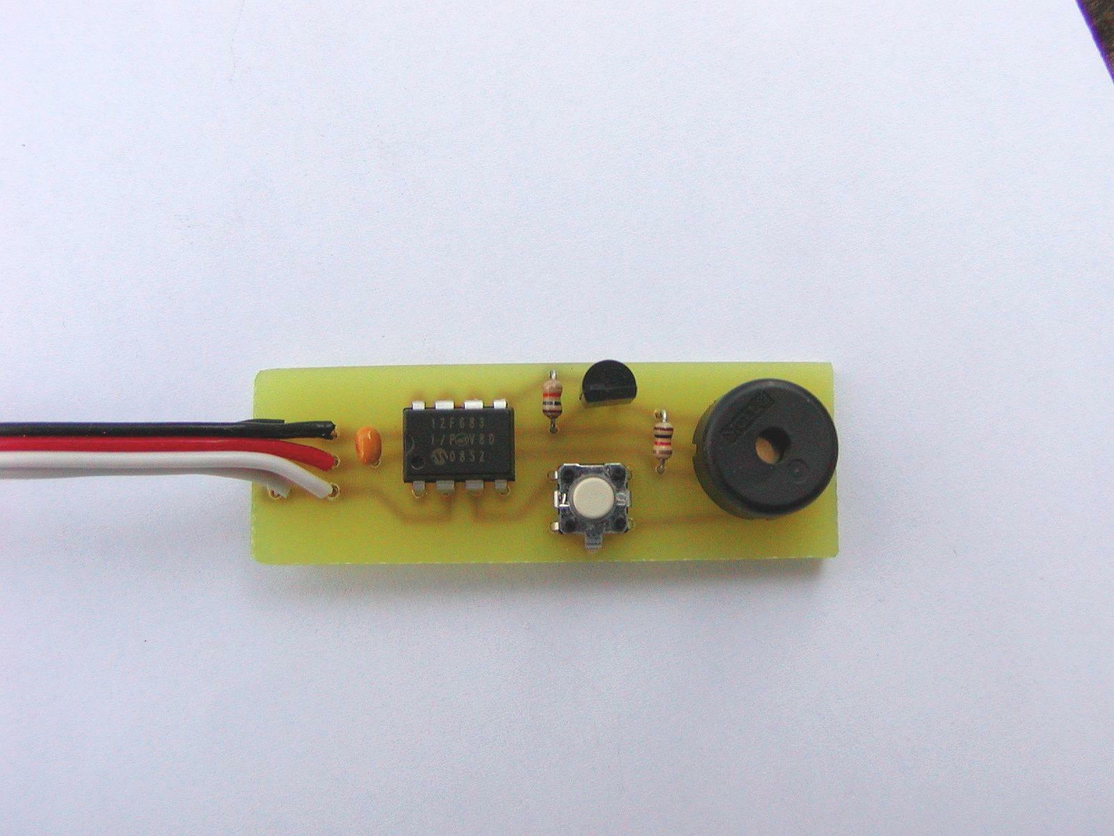

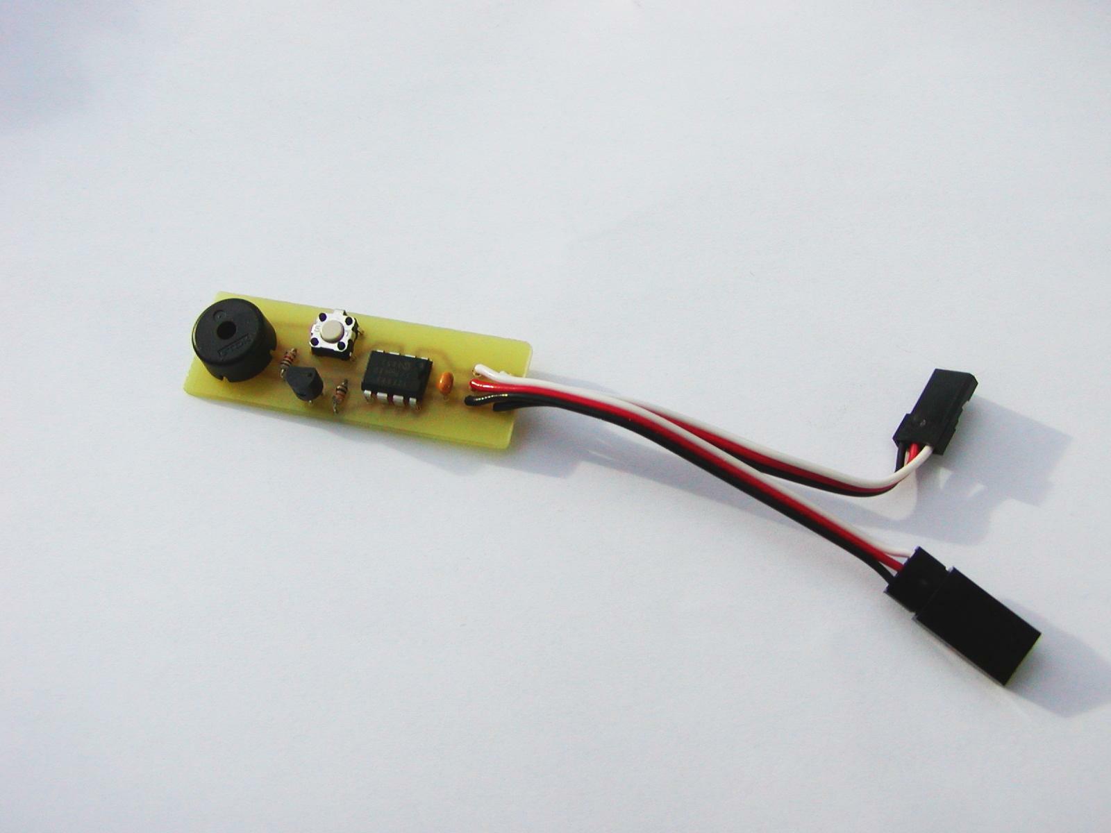

I've completed the board and software and I think it does exactly what you wanted.
I've attached pictures of the completed circuit.
Mrclox, if you PM me your name and address, I'll mail you the board so you can see if it is what you want.

There's no protection circuitry on that, at the very least you should put a 10ohm or so series resistor inline with the chips VCC line.
Well I guess you don't need reverse polarity protection. Over voltage might be nice though, a fresh 5 cell pack will put out slightly better than 7 volts for a bit, don't know if the pic would survive that for long. Is that a piezo speaker or a buzzer? I wouldn't think you'd need the transistor.
Just a suggestion to your "UI".
On Power Up - if the gain is CORRECT - have the device "chirp" twice.
This way you get positive confirmation that the "gain monitor" is operational, and that your settings are correct. Otherwise if the board fails (broken wire to the Piezo anyone??), you may never know until it is too late.
Sceadwian,
A resistor isn't going to help with over voltage. The PIC only draws about 1 ma. At 1 ma, a 10 ohm resistor would only drop 0.01 volts.
It is a piezo sounder, but its spec sheet didn't indicate its current draw, so I figured that the FET would be cheap ($0.25) insurance.
MrClox,
The PIC is only rated up to 6 volts. I will add space on the board to add 1 to 3 small diodes that drop about 1 volt each. Add no diodes for 4-cell NiCd or NiMH batteries or 5V BEC circuits. Add one diode for 5-cell NiCd or NiMH batteries and add three diodes for 2-cell LiPoly batteries.
Mike

Since the current is so low you could skip the diodes (which would have to be configured for each system) and put a small micropower LDO linear regulator in there. Then it would be a universal solution.
You may need to put a current limit resistors on the I/O line(s) as well, I have no idea what the output impedance of the servo signal line is, but if it can source more than 1ma of current it may fry the I/O line because the voltage will be over the MCU's VCC from the diode or the regulator.
I thought about putting a small regulator in place of the diodes, but that would required two more capacitors too. I think that 99% of the cases will be covered by a single diode. It works just fine with 1 diode for all cases except where the power is two LiPoly cells (up to 8.4 volts). That has to be pretty rare because most servos and receivers will fail at that voltage. Most users of two LiPoly cells use a 5 or 6 volt regulator.
I think it unlikely that the receiver output will be greater than 5 volts (most are between 3 and 4 volts), but adding a resistor on the input is cheap protection.
You were right about the transistor. I found that the piezo sounder only draws about 7 ma; well within the capability of the PIC. So I've eliminated the FET.
Mike
Mike is that piezo device a buzzer (you just apply DC) or does the PIC drive the buzzer with a timer?
Use software PWM. If instead of grounding one pin and turning the other one on and off to get the piezo to sound you swap both legs at the same time it'll double the effective voltage the piezo sees. It should increase the volume. Nigel explained that one to me a while back. It's like using a two way speaker instead of a single ended one.
