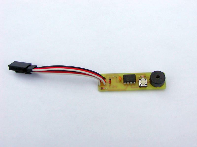

Here is the final prototype. It has a resistor on the input for overvoltage protection and space for up to 3 diodes to lower the supply voltage.
The prototype has one diode and a jumper in place of the other two diodes.

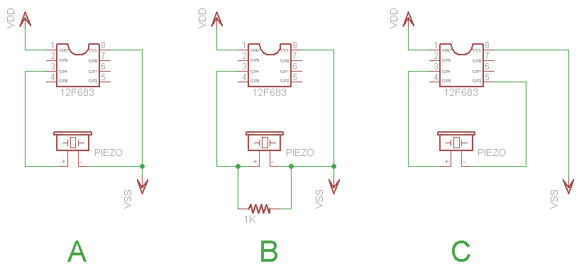

Use software PWM. If instead of grounding one pin and turning the other one on and off to get the piezo to sound you swap both legs at the same time it'll double the effective voltage the piezo sees. It should increase the volume. Nigel explained that one to me a while back. It's like using a two way speaker instead of a single ended one.

Feeding it in such a bridged way makes it a LOT louder, four times the power.
It's easy to do, requires no extra hardware (and as you say, one less resistor), and well worth doing.
I built a new board with the piezo sounder connected to two PIC outputs and drove the two pins in opposite directions. I was surprised when the volume was actually lower in this configuration.
In the end I built three test configurations (labelled A, B and C in the diagram - other parts left off for clarity)
Driving the piezo speaker single ended with no discharge resistor (as in circuit A) gave quite low volume.
Driving the piezo speaker double ended (as in circuit C) was much louder.
Driving the piezo speaker single ended with the 1K discharge resistor (as in circuit B) was louder yet.

hmm, that doesn't make sense =\
No, it doesn't. It turns out that my software PWM routine was at a different frequency than the hardware PWM. The device is quite frequency sensitive.
When I made sure they were operating at the same frequency, then the double ended method is noticably louder, although I wouldn't say it was significantly louder.

The more I fiddle with this and zero in on the resonant frequency, the larger the difference in volume between the double ended approach and the single ended approach becomes.
Mike
You should sweep your PWM's frequency while listening to it to find out the resonance of the piezo. They're incredibly loud at resonance. You can use a variable that gradually increases in your delay loop
