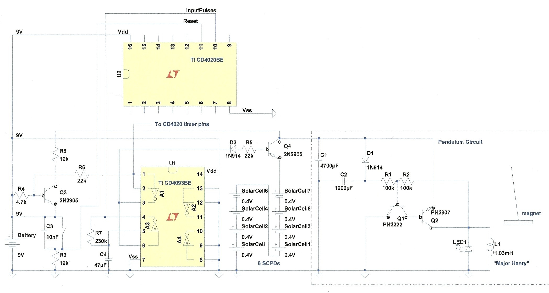

I have the entire circuit prototyped and it is working PERFECTLY!!! I'm currently timing Q14 (16 hours) and I have the pendulum between two coffee cups on my table making a "clink, clank" sound. Pure music!
alec_t, I want to thank you so much for all your help. I can't thank you enough! I'll upload some pictures as soon as this thing is finished. I might as well upload a YouTube video while I'm at it so you can see it in motion.
I'm guessing one more week...
Here is a Circuit Diagram for this project
