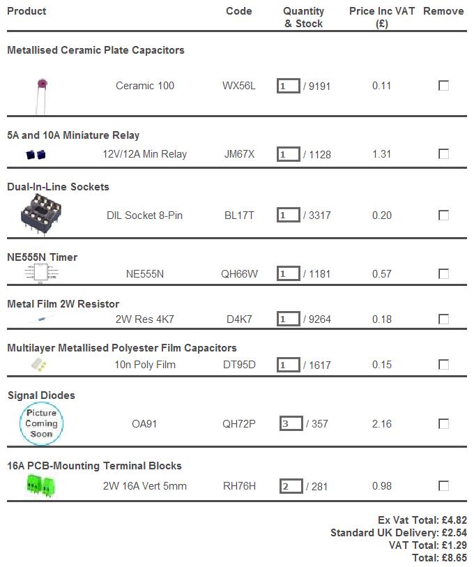

I have posted the list of components here, can you confirm all the parts are correct.
Cheers!
The delay is important, it at least needs to be long enough to turn the relay on and for you to see it.

The ceramic capacitor and 4k7 resistor you're intending to order will give an even shorter delay, just 0.000517 or 517µs which is even worse.
Start off with 100:mu:F and 100k for 11s.
If you want a variable delay, then go for a 100k variable resistor with a 1k fixed resistor in series to give a delay from 0.11s to 11.1s but only do that once you've got the 11s delay working.

Maybe I've missed the jist of the thread here, but shouldn't pin 7 be connected to pin 6 too? I notice you have Germanium diodes in your parts list. A 1N4148 would work OK, and a lot cheaper
On my circuit simulator it seems to work without pin 7 being connected.
Thanks for the tip about the diodes, but I've already put the order in. Apart from being cheaper they should work just as well. (I was thinking higher cost = better reliability / performance) - even if that's not the case!
That's ture, the voltage drop doesn't make any difference here. The diodes are just used for protection and discharging a capacitor so using expensive ones is a waste of money.

just an after thought but what's the current rating of the diodes?
Germanium diodes are low current devices, I'm concerned that the one in series with the relay won't be able to take the current.
If you wanted to spend more moner, you could've bought a more expensive 555 like the ICM7555 or the TS555, they will use less power and have a lower input current which is better for longer delays.
