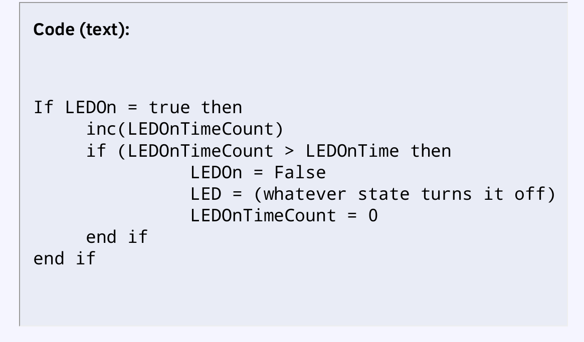

I am still trying to understand Jon's suggestion
this looks like it might work but INC THE LEDONTIME? where is the loop?? Am sure I am missing something and the button press?
MrDEB, this is just a snipet to illustrate the key point you are missing. Read the variable names carefully, every letter. They are extremely descriptive of the function each. It's not
Inc(LEDOnTime)
It's
Inc(LedOnTimeCount)
If you can't follow the logic in those few lines, further discussion is pointless.

Let's expand on this a little. I won't go beyond this, so I encourage MrDEB to go over this the THINK his way through the steps. What I posted before is a concept to get rid of all the delays that prevent reading switches. Starting from this concept:
First, we'll need to declare variables for EACH LED color.
Dim RedLEDOn as Boolean
//True means you want the LED on
Dim RedLEDOnTime as Word
//The time you want the LED to be on.
//This can be different each time you turn it on
Dim RedLEDOnTimeCount as Word
//this is a counter of how long the LED has been on
Repeat this for green, yellow, blue....whatever colors you have.
At the end of your program loop, we put the following, a separate block for each color.
If RedLEDOn = true then
     inc(RedLEDOnTimeCount)
     if (RedLEDOnTimeCount > RedLEDOnTime then
               RedLEDOn = False
               RedLED = (whatever state turns it off)
               RedLEDOnTimeCount = 0
     end if
end if
If GreenLEDOn = true then
     inc(GreenLEDOnTimeCount)
     if (GreenLEDOnTimeCount > GreenLEDOnTime then
               GreenLEDOn = False
               GreebLED = (whatever state turns it off)
               GreenLEDOnTimeCount = 0
     end if
end if
//repeat the block for all colors
And finally you can either add THE ONLY DELAY IN THE LOOP or the timer routine to generate 1mS events. Let's go the delay route.
DelayMS(1)
Wend
The above code handles only keeping the LEDs on the length of time you want them on. Read it. Think about what happens when you want an LED or several LEDs on. Take your time. I will wait until you understand it.
Stop. Do what I said. Line by line, go through the above until you understand what's happening.
