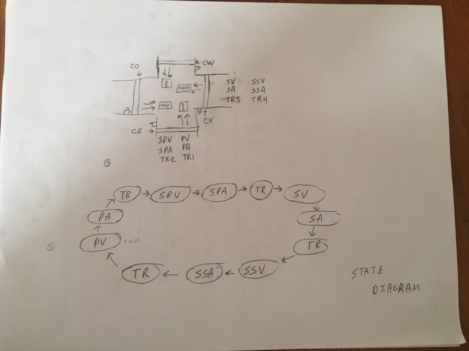

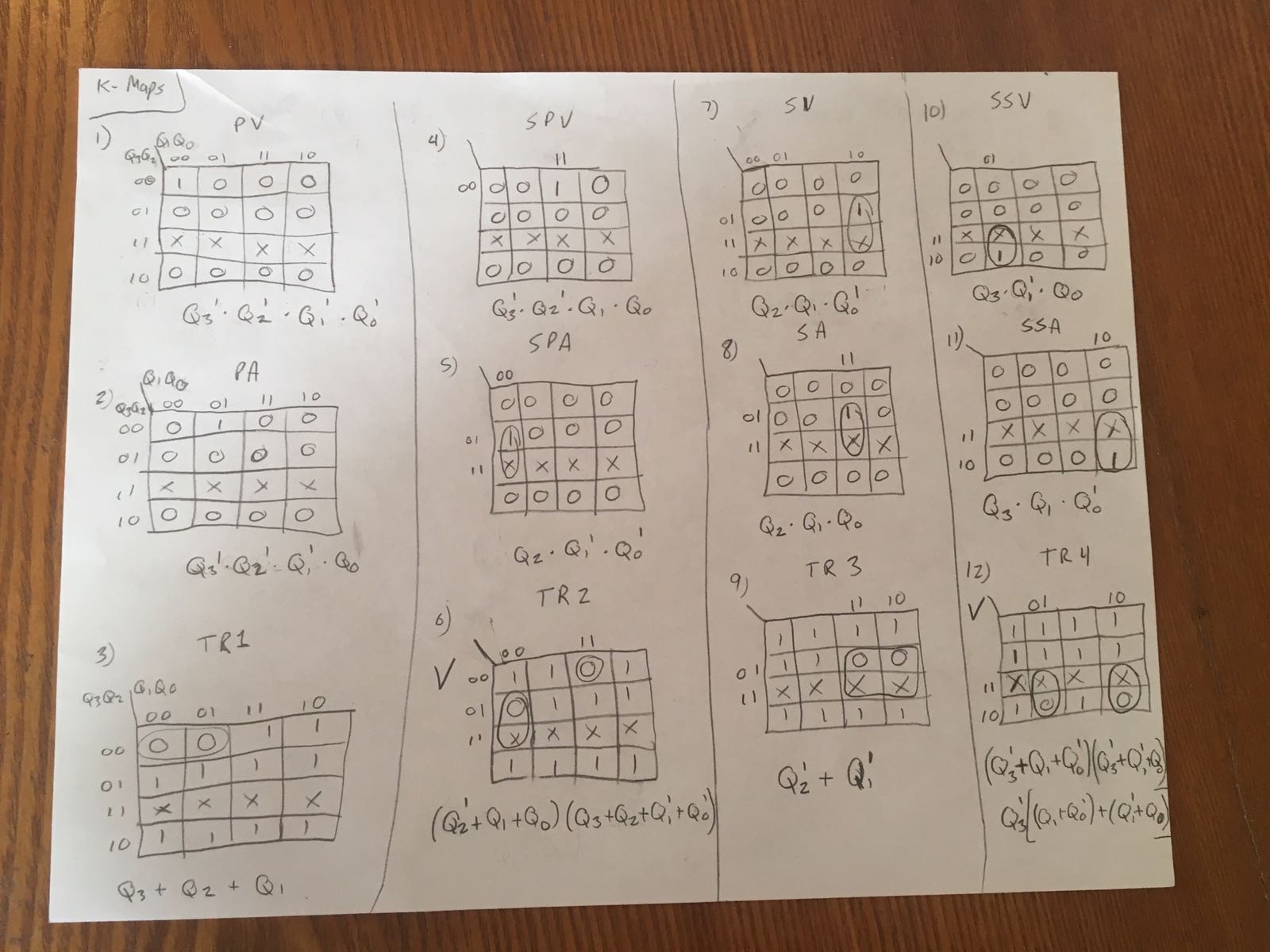

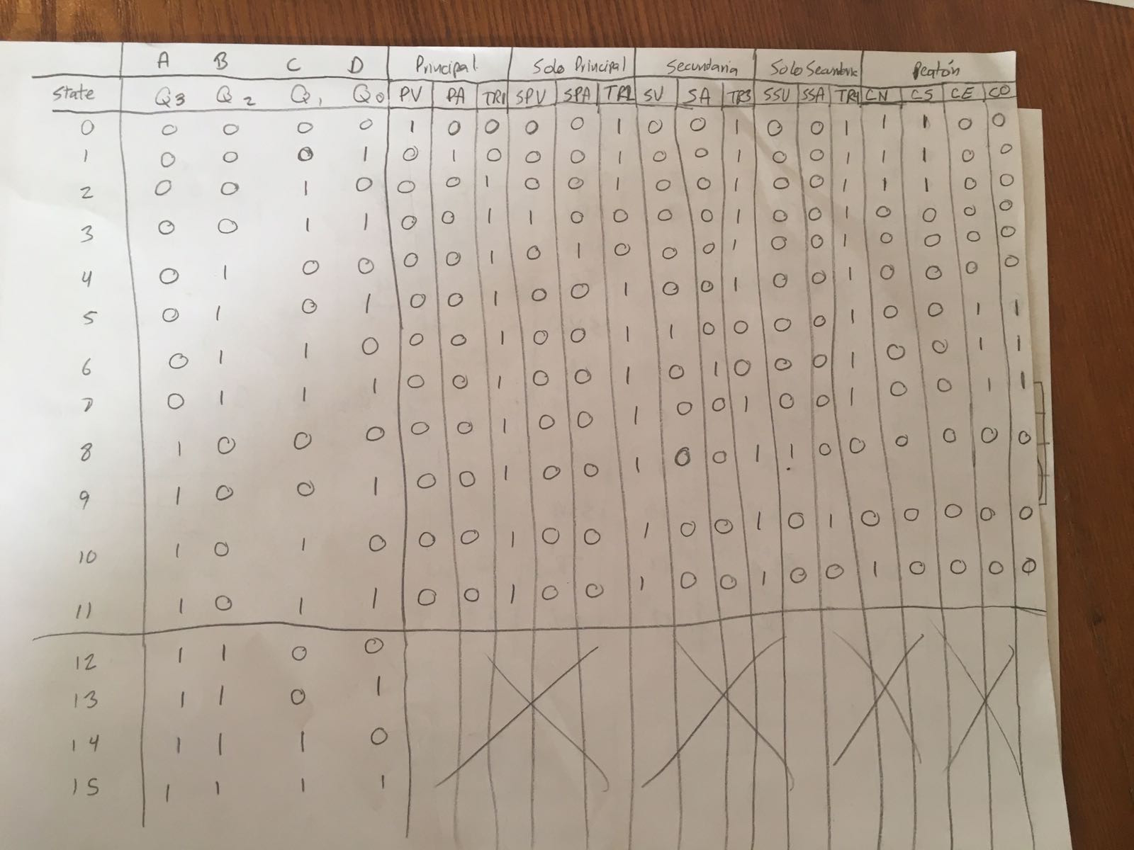

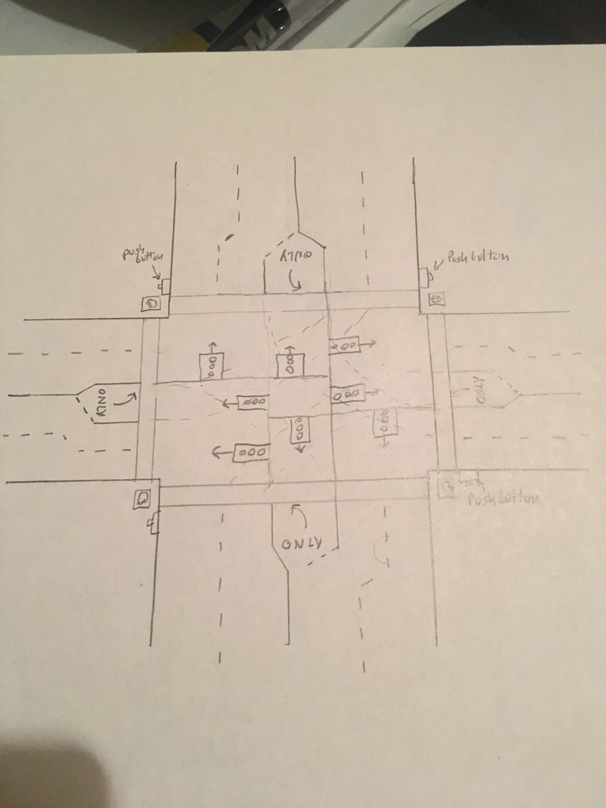

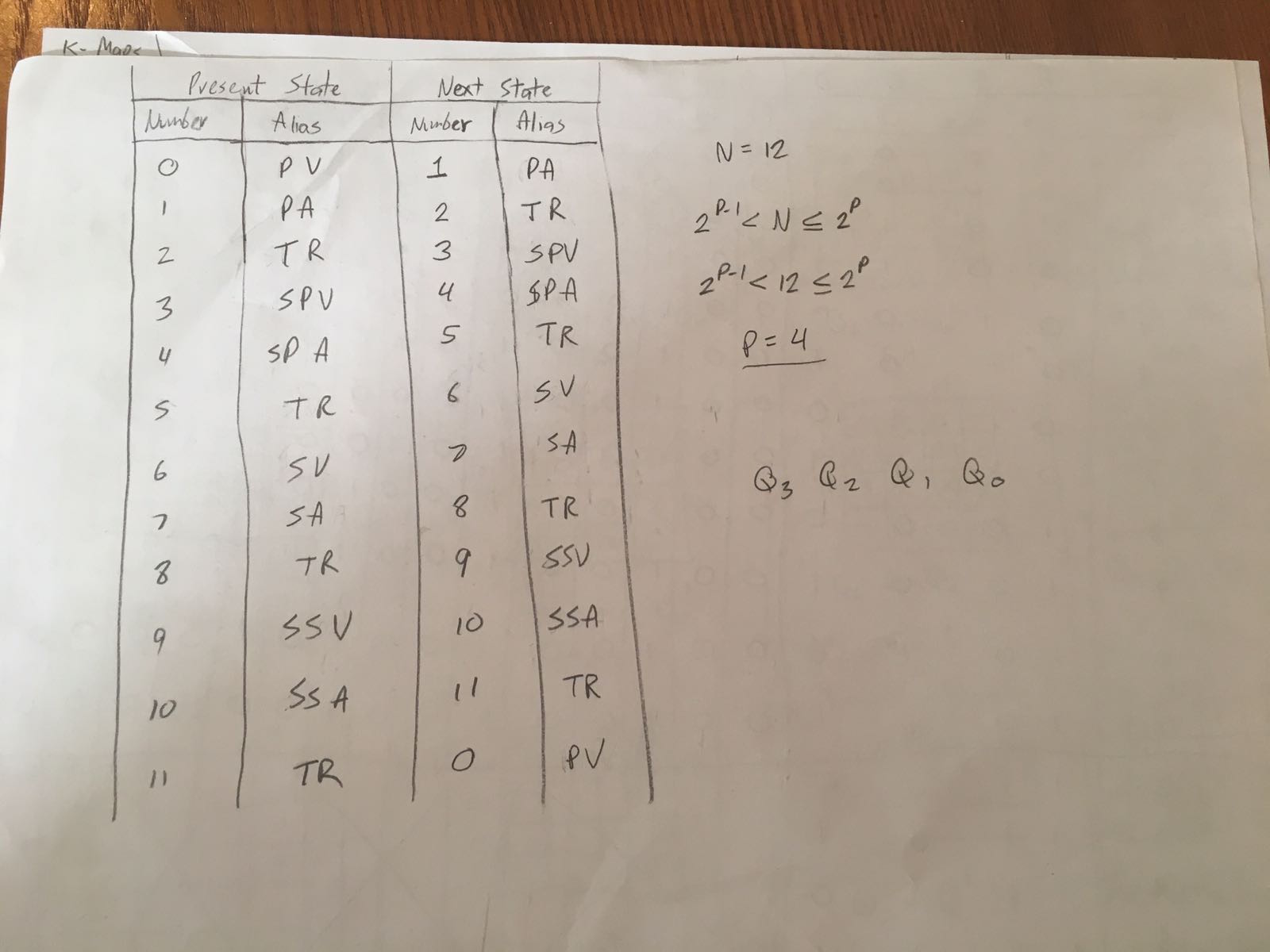

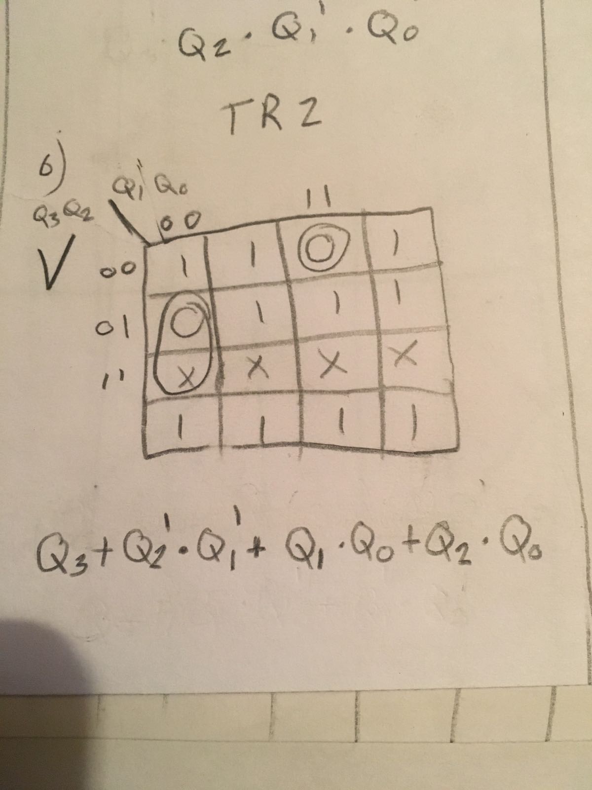

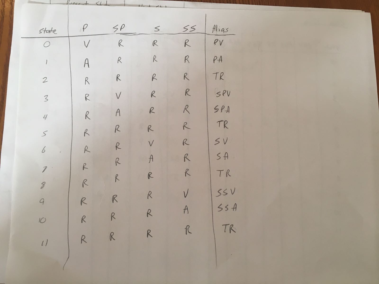

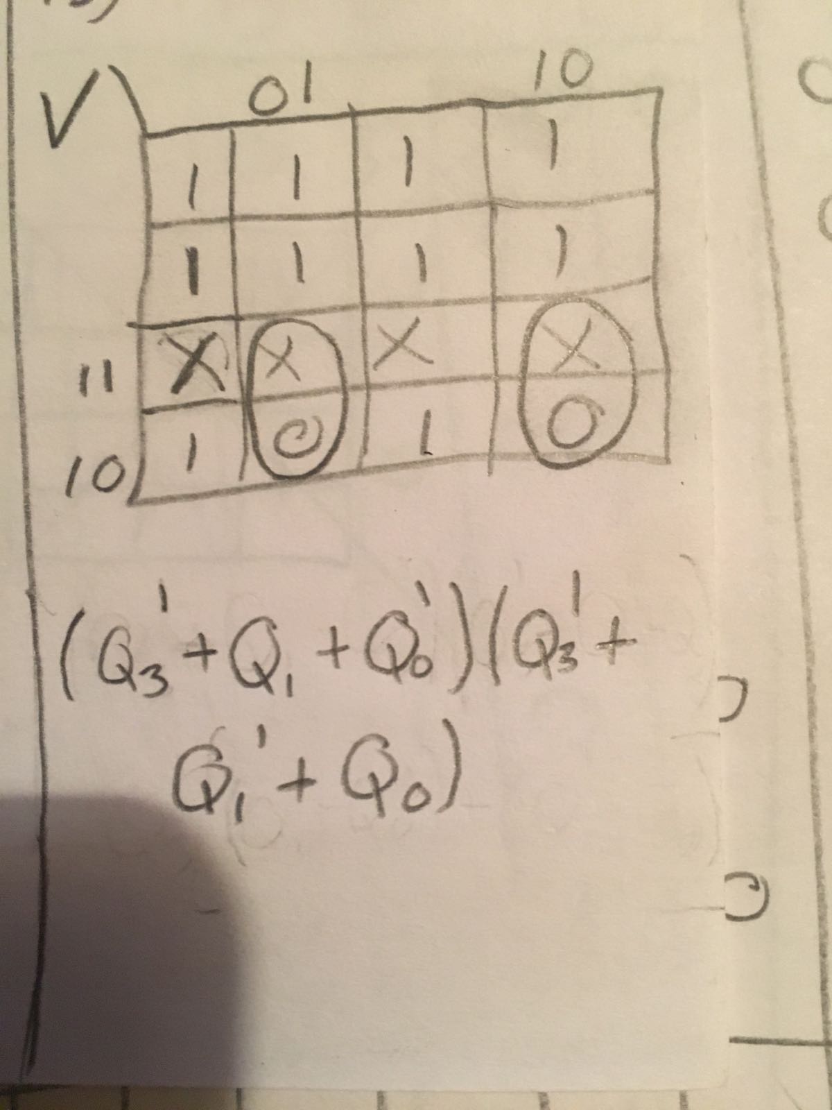

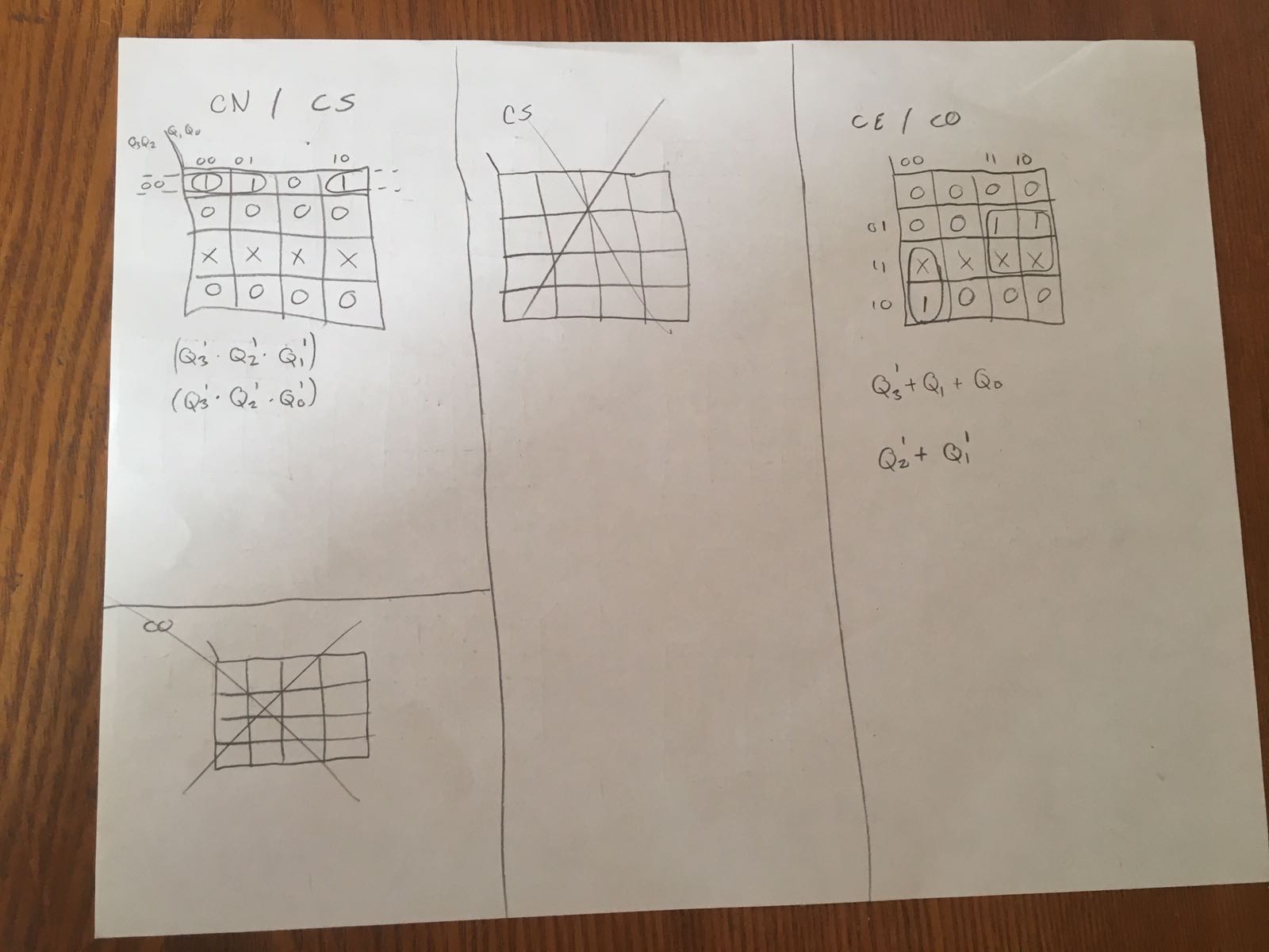

Hey Guys! I just subscribed to the forum. I hope anyone will help me out doing my final proyect.
Base on the equations attached, how can I make my design on multisim. I know that I need to use a D Flip Flop and a Counter...
