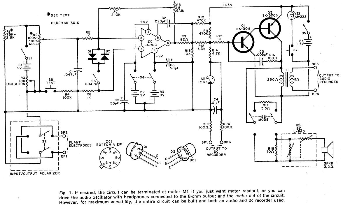

I was looking at making a weatstone brige and an amp, but i eventually stumbled upon this article which seems to be alot of the work done for me!
The article will give you a better overview of what im talking about.

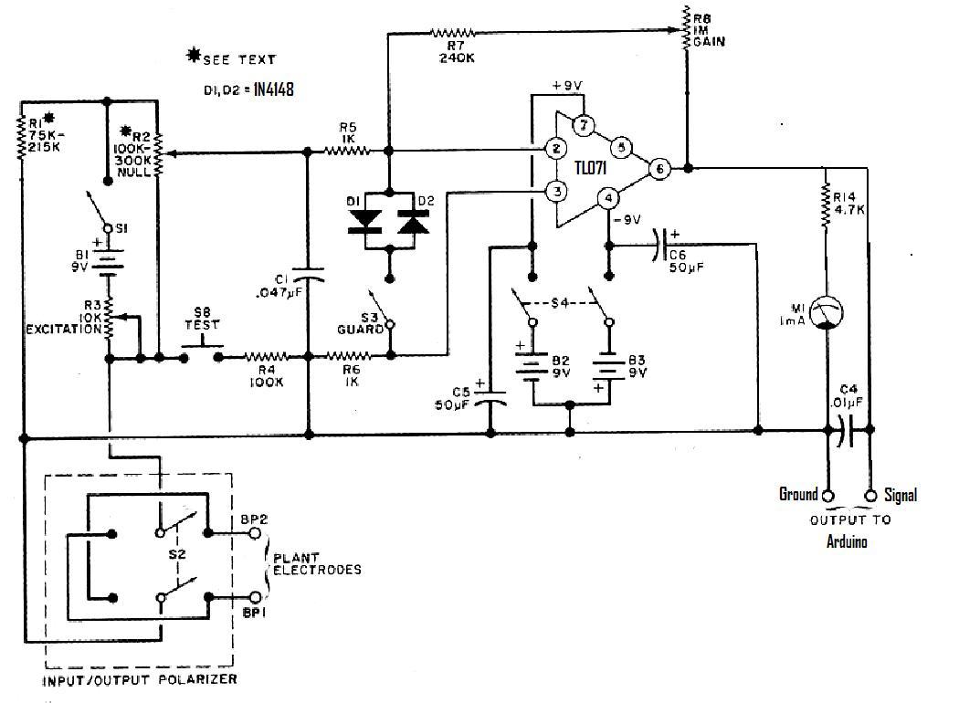

If you could have a look at the second link. It is the schematic for the system.
Looking at the schematic here where i am struggling

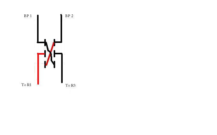

1. The input output polarizer. How does this work? I dont really understand how it would be wired. Its confusing me quite a bit, why have the tracks comming from the electrodes (bp 1 and bp2) been crosed over each other?
2. How viable is this in terms of part avalibility? I think the ic might be a little out of date but shouldnt be to hard to find a sutible replacement. Any advice as a whole?
3. I need the output to be in a voltage range of bewteen 0-5volts. A range of 0-1 would suffice though. Where would be the best place on the schematic for me to take the output to be sent into the arduino? At the dc recoreder or the audio output? Im asuming the dc recorder but im not sure what voltage range it will be outputing.
