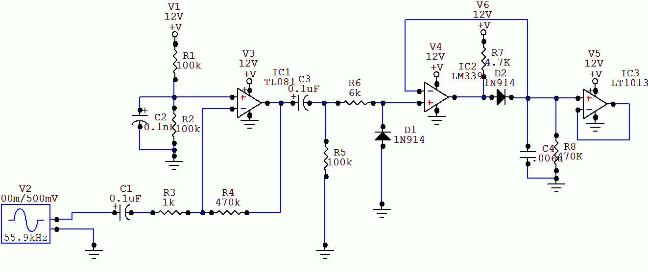

Hi Ronv,
What I was trying to do was add the TL081 to your suggested Amp, for maximum Amplification, which on the simulator seems to work and 'sees' below 1mV by changing R2 and R4. (This then overloads easily) and if R2 and R4 are changed it will then 'see' 10V. Then to add some sort of circuit to shrink the Amp effect as the signal goes up so that it sees low and high. 'say' 1mV up to 10V.
I have heard of Logarithmic opamp circuits that do just that, and thought that's what the AGC did, but now I am corrected.
Tell me if you think this is a good idea, or perhaps make R2 and R4 Pots.
Cheers.

D2 is a "clamp diode" prevents the input of the LM339 from going more negative than about -0.7V but the LM339 must not have its input go more negative than only -0.3V.
The single TL081 does not have enough bandwidth (3 Mhz) to run with the gain you have attempted to get from it.
In addition the low input impedance (1K) will lower the Q (and gain) of your resonant circuit.
Are you thinking of a new design?
I've not had problems with the clamp diode if the input current is low. But to make it sure you can use the circuit shown in figure 10 of this application note.
https://www.electro-tech-online.com/custompdfs/2011/05/AN-74.pdf

I don't understand bandwidth or impedance or Q, All I can do is copy circuits and make them, with a little knowledge.
If you mean I'm attempting to get 1mV to 10V out of it, I was trying to see if the Opamp could be adjusted down as the voltage went up.

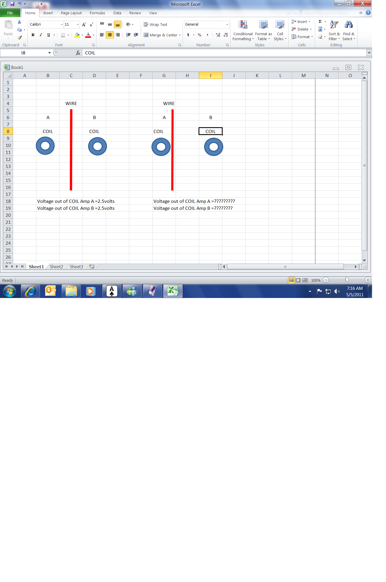

Lets say everything is working at nominal and you get a 2.5 volt output. Now it you move one COIL closer and one further away from the WIRE what would the lowest and highest voltage be.

Because of the wide range of voltages, I thought I needed 1X COIL Amp for each Set of COILs and WIRES.
I was going through notes and memories, of past testing, of different COILs different WIREs different Sig Gens, and was looking into the possibilities of 1X COIL Amp Circuit the would cater for the full range. The range across all situations is 0.1mV to 10V. And this input should give 0V to 5V DC. I think also it is better that this is by controlling then output not clamping it.
As a usable circuit for many other applications I'm sure it would be good to go down to near 0V and have an adjustable high range.
COIL Voltage Range
I'm not sure this method will work for what you want to do. Is it your intent to adjust focus, F stop etc.?
See if you can fill in the question marks in the picture.
