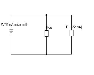

Really basic question, I'm afraid. I'd like to use a solar cell (3V, 45 mA in the midday sun) to power a small circuit. The circuit uses about 3V, 18-22 mA.
1. Is it true that power from solar cells must be stored or used immediately? A battery will give you from its store what you ask for (22 mA) and no more? But with a solar cell, you have to dispose of all the current it's generating?
2. If so, where do you put those extra unwanted milliamps? Put 1-watt resistor in parallel with the load to dissipate it as heat? Or a capacitor that will discharge in 12 hours? Add a physical earth/ground?
Grateful for the help.

The specs on a solar cell are limits it can't go over. If your solar cell can't go over 3 volts and the load is designed for 3 volts, you don't have a problem. Just to make sure, you can connect a volt meter to watch the voltage being applied to the load. Just to make sure, you can add a 3.3 volt zener diode across the load so the solar cell can't push more than 3.3 volts or the zener diode will eat the excess. A 1/2 watt zener will be safe in this condition with no resistors to "save" it.

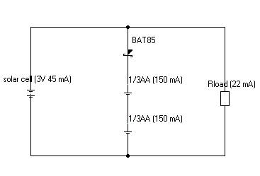

See attached. Will this work?
But I want the 1/3AA batteries to discharge overnight to 10% full, don't I?
Does the Schottky diode prevent that overnight discharge?

1. A 3v solar cell will never be able to charge 2 1.2 or 1.5v cells.
2. A super-cap is permanently connected to the micro.
3. A diode is placed between the solar cell and a super-cap.
4. A sense line is taken from the solar cell to the micro to detect when the sun shines.
5. The super cap will have sufficient energy to allow the micro to send a signal.

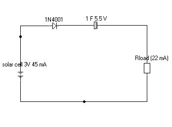

Does the attached schematic match what was suggested?
How big a supercap should I use to store (and discharge) a day's overage? I reckon about 125 mA per day.
Does the usual rule hold, voltage on the capacitor should be twice the supply voltage?
I'm discharging back into the solar cell, is that okay?
Not sure about a "sense line". I imagined the circuit will operate when there's current (i.e., sun), will shut down when there's none. Is there something more I should be considering?

The two 1.5V batteries were not to charge. They were to absorb the excess current, and then discharge it.
Getting the two cells the "absorb" excess current is exactly the same as "charging" them. The cells produce a "floating charge" or "floating voltage" that is far higher than 3v and your solar cell will not be able to deliver any energy into them. That's why I suggested you use a super-cap.
Use a 0.22F super-cap directly across the project.
Take a "sense line" from the solar panel to the project to detect when illumination is present. The purpose of the super-cap is to allow the project to work at the first sign of illumination. The project will have to be able to shut down to less than 1mA.

You can't use a NiMH battery because it will not begin to charge until the voltage is above 3.6v. But a super cap will charge at any voltage it is supplied with. That's why you should use a 5v5 supercap. That's why you are listening to us. We are telling you things that you will never learn in 100 years from reading a book.
