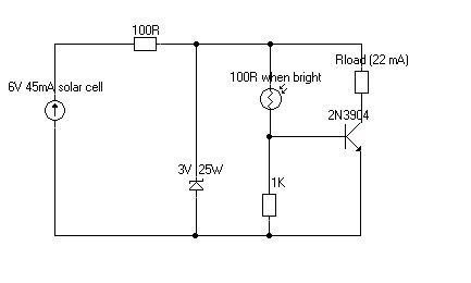

Here's what I came up with. "Transmit a signal when the sun is shining."
RF transmitter (indicated by Rload) runs at 3V, 22 mA, shuts off at 2.7V.
6V = two 3V solar cells in series.
1K chosen to shut off the RF transmitter load when it's cloudy.
The zener is 1/4-watt (not 25-watt).
Your examples showed a circuit like this could tolerate a transistor, so I used one.
I've quit worrying about extra current from the solar cells, it's a myth.
Will this work?
Thanks for your help.

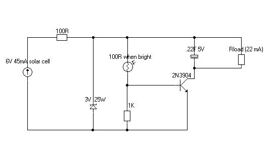

The trouble with the circuit is this:
The device you are powering will gradually receive current and the voltage will gradually rise. If the device is a micro or oscillator, the oscillator will not start-up.
This is the funny thing about oscillators - that no-one or book will tell you.
They need a heavy current to reliably start-up.
That's why you need either a Schmitt Trigger in the voltage-delivering section and/or some form of capacitor across the load.

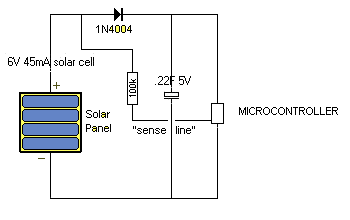

It needs a microcontroller to shut down when not needed and have a sense line to detect when the sun comes up
Sun-UpAlarm-2.gif**broken link removed**
