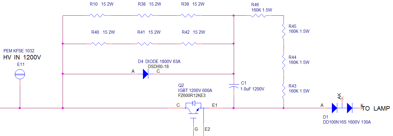

Hello,
I have the below snubber circuit. I don't have much experience with them. I'm trying to determine if the components used are suitable, specifically the resistors. The input voltage is 1200V max and Q2 triggered at 2Hz. Using .5*C*V^2 the cap energy is 0.72J. Now I need to figure out the voltage across each resistor to determine their individual power dissipation and that's where I'm a little confused of where to start.
