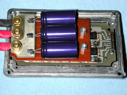

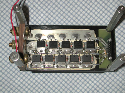

Are you sure you need snubbers? I would check some of the high-power model controllers. I don't believe they have snubbing. Also, here are two pictures of paralleled half-bridge controllers I built. The left is an early version using copper strips. The right is on 4 oz PCB. Neither has snubbers. Both have a "main" capacitor as we discussed previously, which is not shown in the image of the older design. I have no idea of the amperage capacity of the left controller. It was probably 200 to 300 A at 12V. The right controller is for a 1.5 HP PM motor at 12V. John

WHen I say snubber in this case, I am referring to any kind of discrete device like diodes or R-C. DId you only have the main capacitor? YOu didn't have any diodes or anything?
