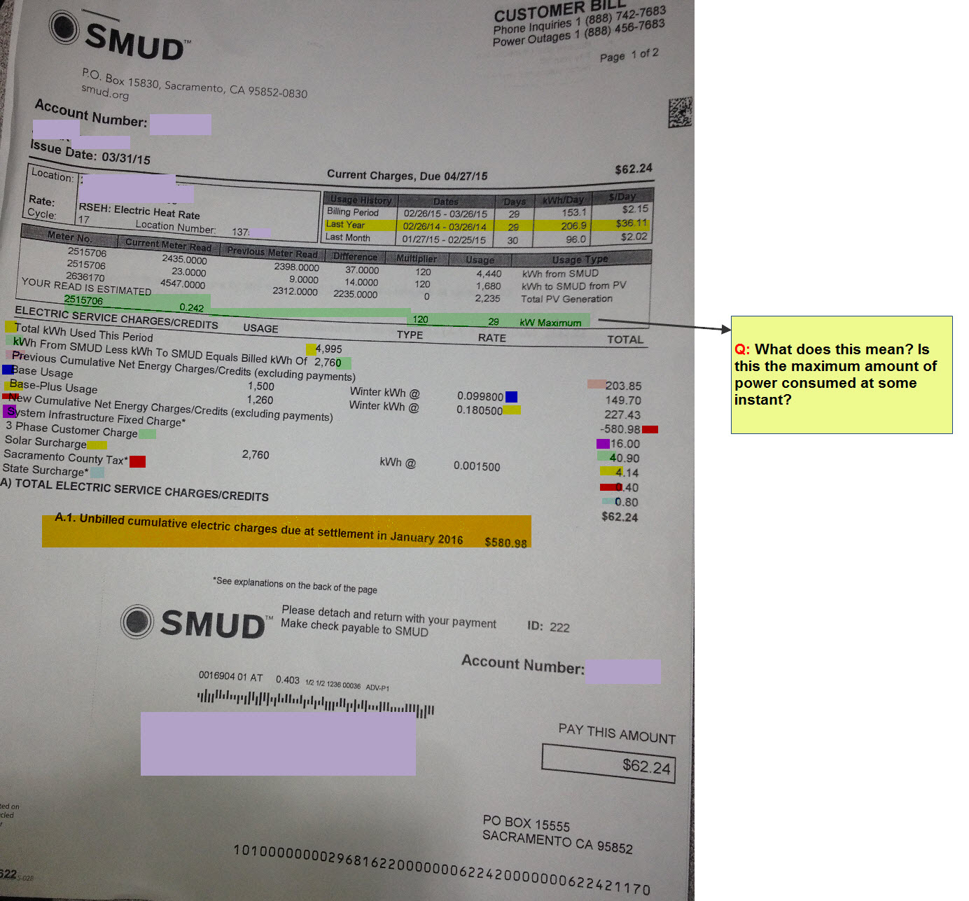

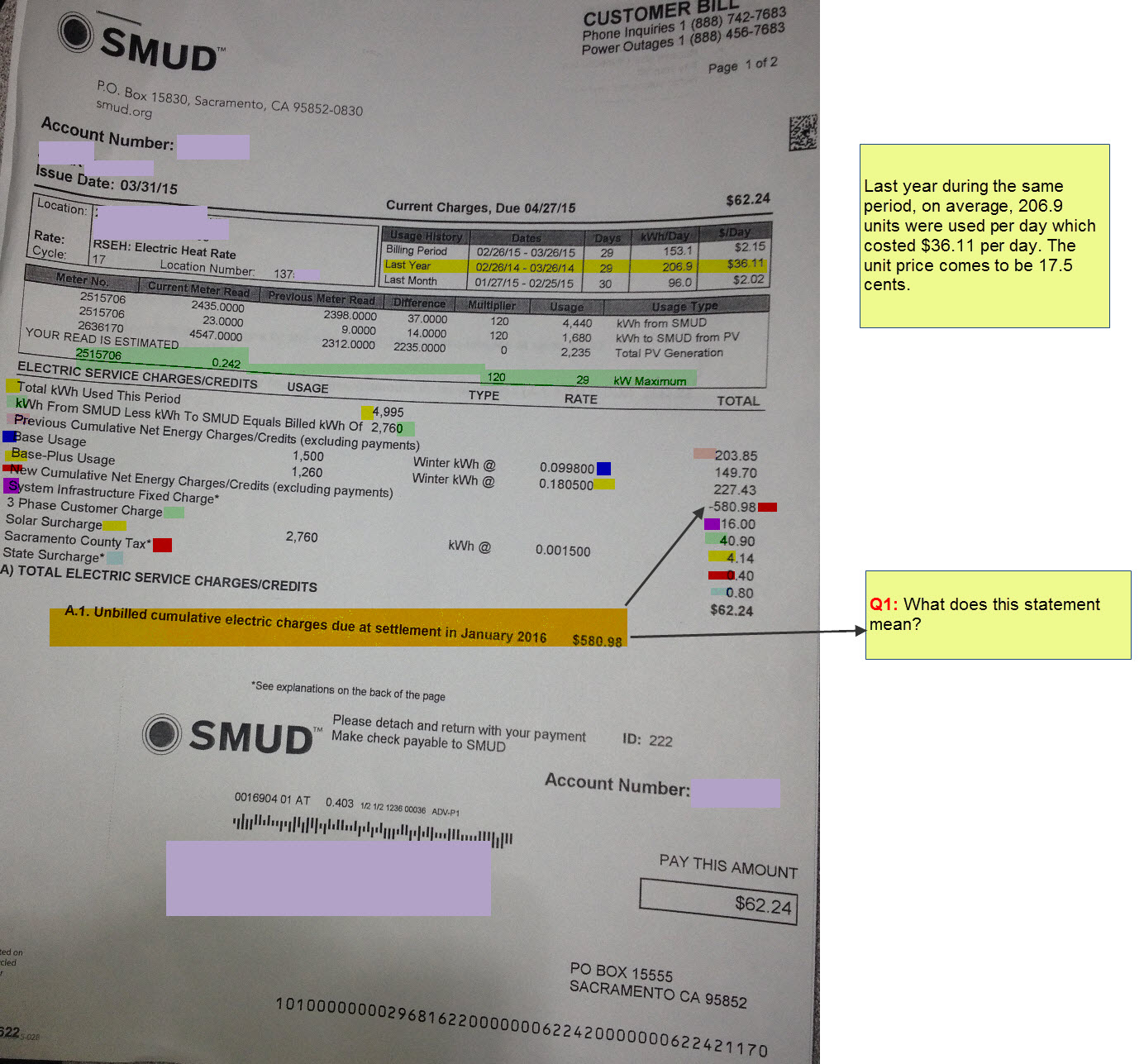

Hi
Q1:
I got hold of an electricity bill of a consumer and need your help with this query.
Q2:
I see that more and more people are using solar PV energy. It means that the grid is gradually getting closer to zero net energy consumption. I believe that electric utilities such as SMUD wouldn't have any problem with this because it is a publicly owned utility but I don't think PG&E will be very happy with this because, naturally, such utilities always aim for profits. By producing more and more energy, you are aiming for zero net energy and therefore you are simply using the utility's infrastructure for your own benefit and this doesn't really profit the utility.
Could you please tell me that what benefits utilities such as PG&E drive from encouraging consumers to install photovoltaic panels? Someone was telling me that most of profit for many utilities come from industrial and commercial sectors and therefore encouraging residential consumers to install PVs would let the utilities to generate electricity at cost-effective rates during high-demands hours, i.e. during the daytime. Thank you.

Looks like a 1 yr deferred cost bill.
Too much power consumed at peak price as well, could use better insulation.
Infrastructure costs are based on peak capacity. This may help reduce their peak demand but savings to you look doubtful unless you capitalized using only off peak power.
The biggest plus for PV panels is local power factor correction which is often overlooked and demand side management. Air conditioning runs when the sun is shining, so the utility does not have to build infrastructure to meet the peak demand. PV also credits against the carbon footprint.

Thank you, everyone.
I had grid-tie inverter system in mind because I believe that the concept of reverse metering makes it batter than a solar PV system with battery backup.
Here in Arizona the electric power company started charging customers a $50 fee for having Solar panels. The power company claims it costs them money to buy the excess power, they have to pay employees to deal with this, it is not free. Solar companies here will install the solar panels on your house FREE. Your roof is a place for the solar company to keep their panels. To make a long story short solar companies make it sound good to the customer but in the end the customer does not get much out of this deal.
In California, as I have heard, things are quite different. I think that in California the consumers with PV panels will benefit because of reverse metering. For example, their solar panels will produce electricity during the day and it will reverse the meter reading. Suppose that you used 10 units during the night and during daytime you also generated 10 units then overall you consumed 0 units. Please note that I don't really know how utility buys electricity from a consumer in California. Anyway, someone told me that generating more electricity than you consume on monthly basis wouldn't benefit you. For example, if you consume 100 units in a particular month and also generated 150 units during the same month then the extra 50 units wouldn't really account for anything.
You get 200 BTUs per sq ft of heat from the sun. NO way you can get close to 200 BTUs with electric panels.
"200 BTUs per hour per sq. ft"?
On a bright sunny day, you might get 1000 W/m^2 (or, 92 W/sq. ft) but I believe that this figure is rather optimistic. Anyway, there are 1055 joules in 1 BTU. 92 (1/1055)*3600/hr./sq. ft. = 314 BTU/hr./sq.ft. I hope that I have it correct.
Solar City offered to put FREE solar panels on my roof, 7600 watts of panels. Solar city gets the government rebate, they get all the electricity $$$ the power company buys from the panels. Only thing I get is free electricity from what they call, excess power.
I would request you to clarify the points above. I believe that you are saying that Solar City gets the government rebates and can buy solar equipment such as solar panels at cheaper prices but I don't get why Solar City gets all the income/benefits generated using those panels. What is that "excess power" which you can get for free?
Now the neighbors house is For Sale but they cannot sell it because the solar system does not work. Legal contract says, the home owner can not remove the solar panels from the roof.
Why can't your neighbor sell their home with their existing dysfunctional solar system?!
Perhaps, it got deferred to facilitate the installation of solar panels.
Were you referring to this? Please let me know.
Thanks a lot, KISS. I wouldn't make any further queries about your posting because I believe that I have already made enough queries above and you can guide me with them. Thanks.

I think KISS's estimates are valid, just need to multiply by PV efficacy of 15% to 22% depending optical bandwidth if it includes IR and steerable PV * number of sunhours per month.
Yes the overcharge above 1500kWh goes from 10 to 18 cents per kWh and that bill was more than 50% surcharge, so the power use was excessive, hence more insulation needed. i have R50 -R90 in attic DIY rental blown fiberglass 7x compressed batts and added 1-2feet with leaf blower extension tube. Ventilation to attic is critical. So added ride vents and continuous open screen soffit vents. cost 800$ payback 2 yrs
Our bill is only $150/mo now with gas furnace and TIme of day rates in the range of 8-14 cents/kWh...not sure.
