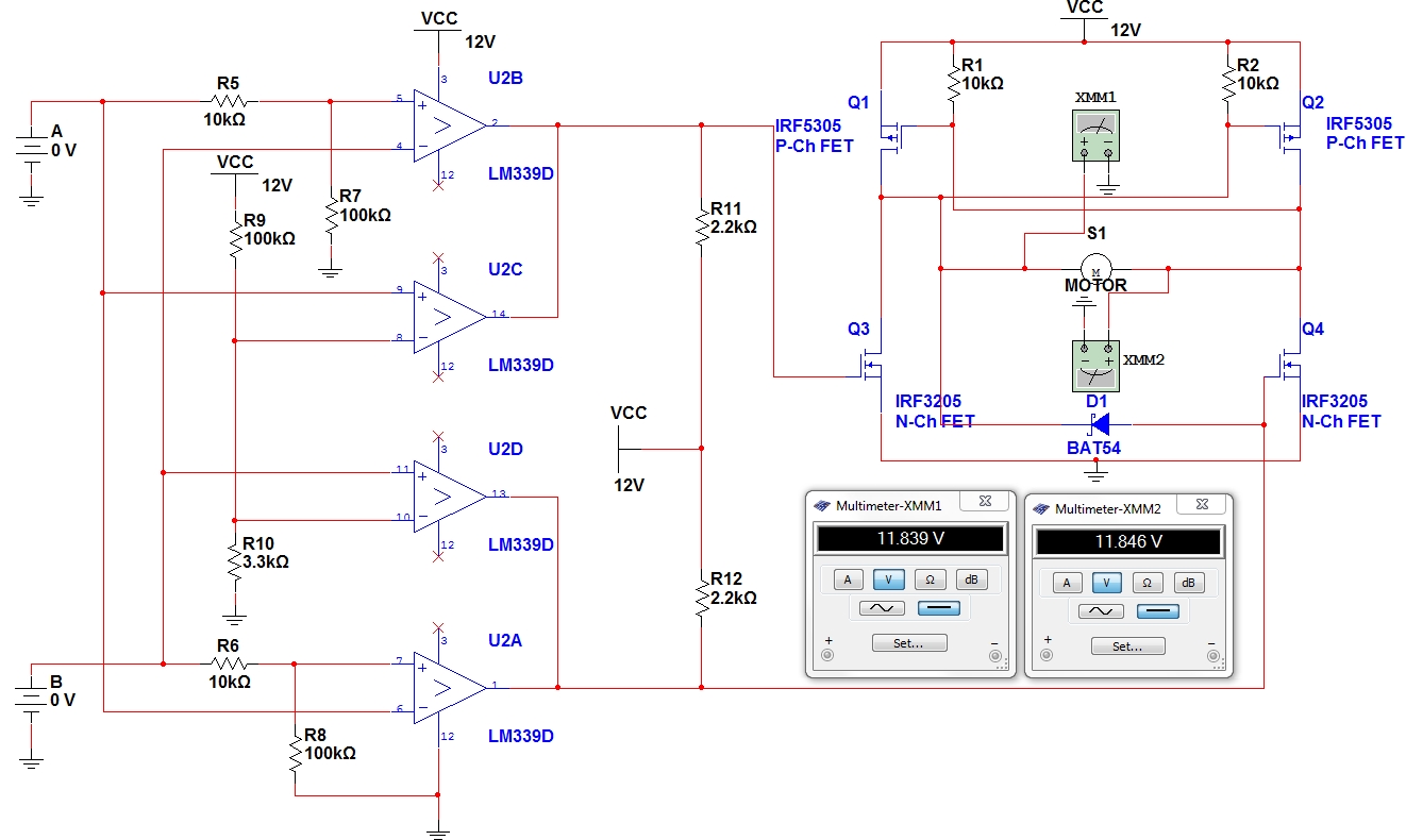

When both MOSFETs Q3 and Q4 are OFF, then resistors R1 and R2 pull up their drain terminals to 11V (12V). That's how they turn Q1 and Q2 OFF (by setting the Gates of Q1 and Q2 equal to their Source terminals.)
A voltage is different from a current. For a current to flow (e.g. through the motor) the voltages must be different. One end of the motor would be about 12V while the other is about 0V. If both ends of the motor are at about the same voltage, there is no current; the motor receives no power.
The way your meters are hooked up is nice for troubleshooting, but if you really want to understand what the motor sees hook both ends of a meter to both ends of the motor. The motor doesn't know what "ground" is. It's a notation for our convenience as it gives us a reference point. And simulators are homeless without a "0V" to return to.

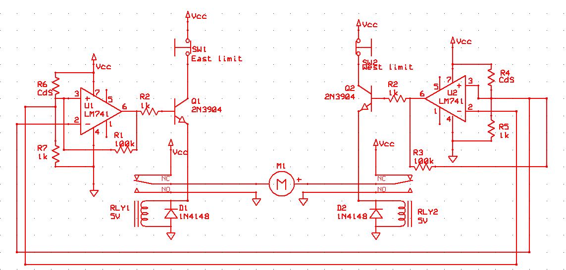

I'm not sure if this was suggested yet, as I have not been keeping up with this thread, but why don't you try these circuits?
Appears that's a single axis tracker as well, however, I do see it has relays in it which makes me wonder if that circuit returns back to east at nightfall?
I'm not sure yet how we'll have to implement that yet, but we have a working circuit currently, at least by simulation results, so I'm still going to proceed with working with that one since I somewhat understand how it works :)

The circuits that I've posted are very similar to your circuit, they just use a different op-amp. If you want a circuit that will reset at night, I can throw a scematic together, but you may have to wait a day or so untill I have some more free time.

Well if you look at this last page here, you can see we are no longer using an OP Amp but a comparator, so that first circult you see on the first page of this thread is no longer what we are building onto :)
The following is the current "working" circuit that I'm about to build on a breadboard fairly soon. So if you know of a way of implementing a way to get that particular circuit to turn back east, that would be awesome :)
Both of those LM741 circuits are useless. The relays are a good idea, but the implementation is bad.
CdS photocells were once very popular, but I prefer silicon diodes in new designs now that the dangers of cadmium are understood.
The LM741 is a very poor choice for driving a relay through an emitter follower, because the relay will get a lot less than Vcc. (In this circuit the relay may get approximately Vcc-4).
The LM741 performs very poorly below 10V. Vcc is not stated.
The LM741's inputs should be kept between 3 volts and (Vcc-3V). Neither circuit assures this.
The first circuit has the + and - inputs to the two LM741s simply cross connected meaning the motor is always running back and forth. The motor will never stop.
The second circuit does not compare the two photocells. It simply runs when one of them is very dark and the other is not. The motor will stop when it is very dark or it is very light. When the photocells have different amounts of light, the motor won't run until one of them is totally dark.
The limit switches interrupt only the collectors of the transistors, meaning the LM741 is still trying to drive the relay through the transistor b-e junction. The motor might keep running.
