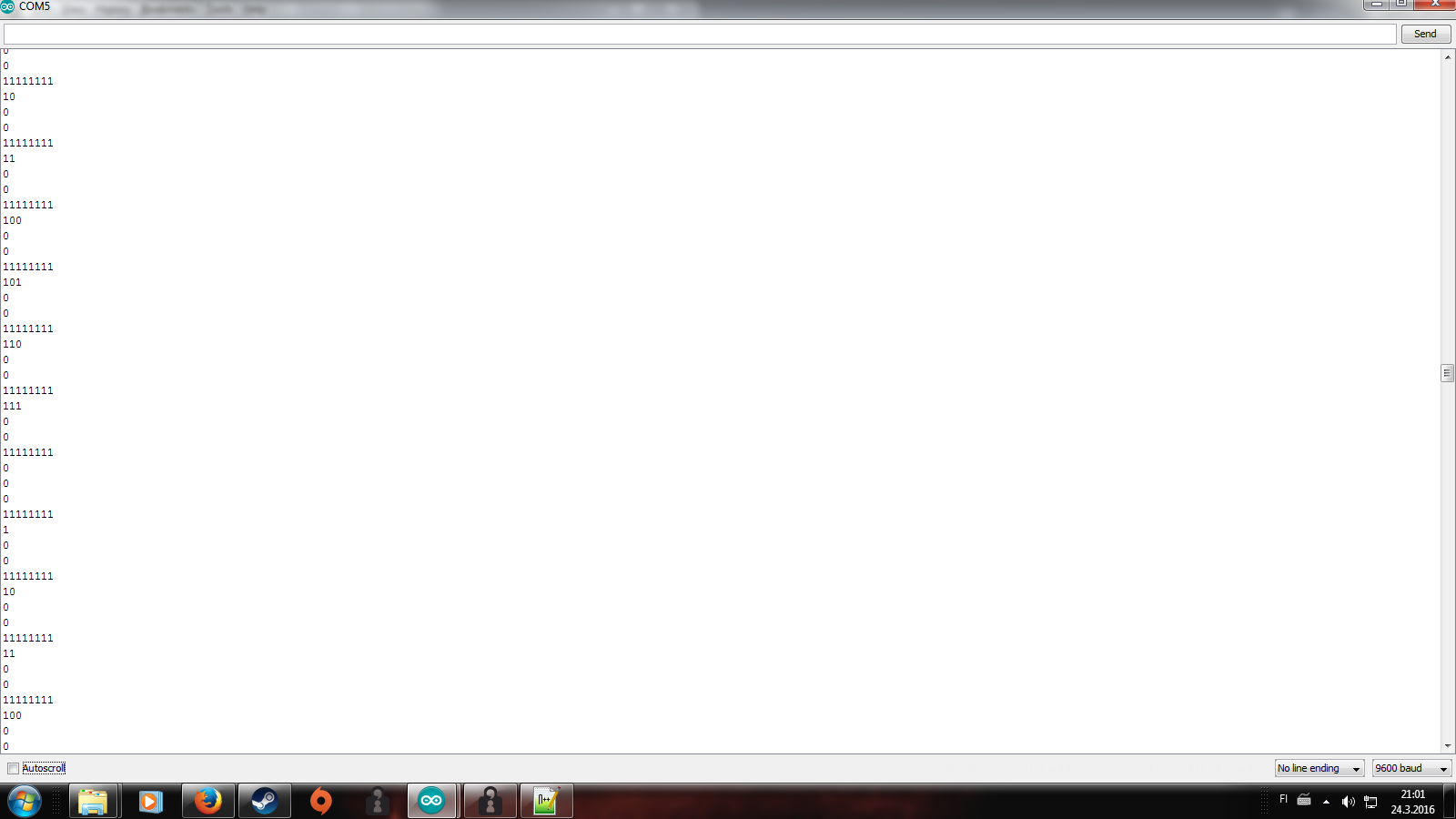

Ok, with code #364, small living; segments dot and a blink bit once in a while, but still in pattern,will take shot tomorrow, but with these all, only one dot is lit (16 bit font):

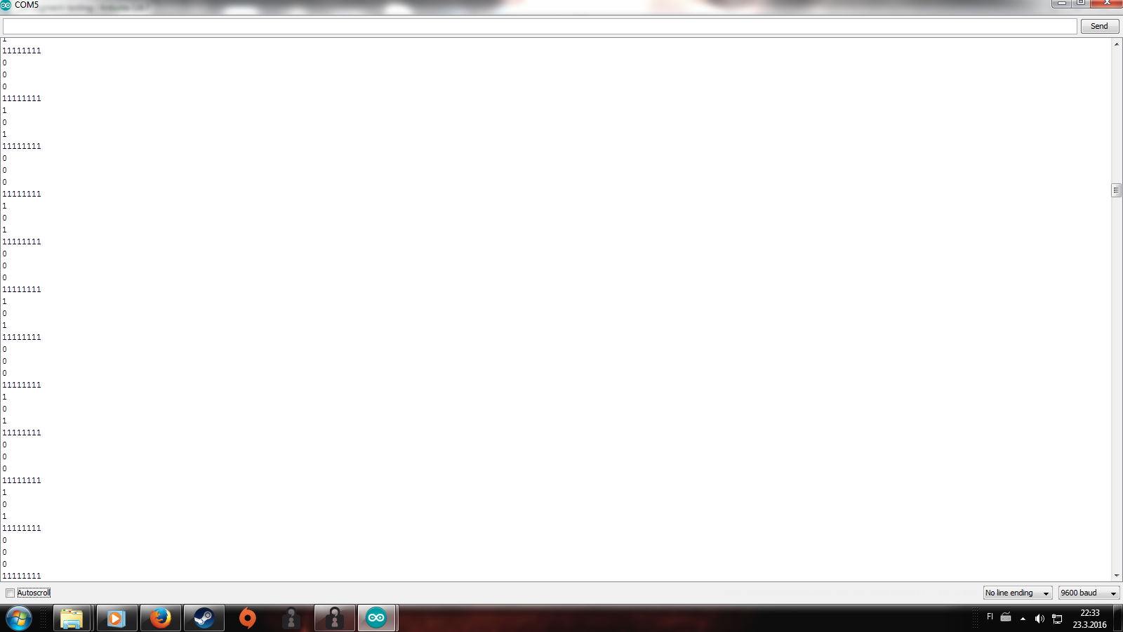

Doggy, here's output from serial: (pattern isn't worth taking shot of, only dot is lit now for some odd reason, but it does flicker so something is happening) Sorry for delay, got other stuff to do like brand new atmega 328's that were painful to program (no bootloader and google didn't help much, now they all have loader!)
oops, 0*2 = 0, plus more bit bangs, should be a little more colourful, may take about 30-60 seconds for full run
Also lets change these back to 8 for now:

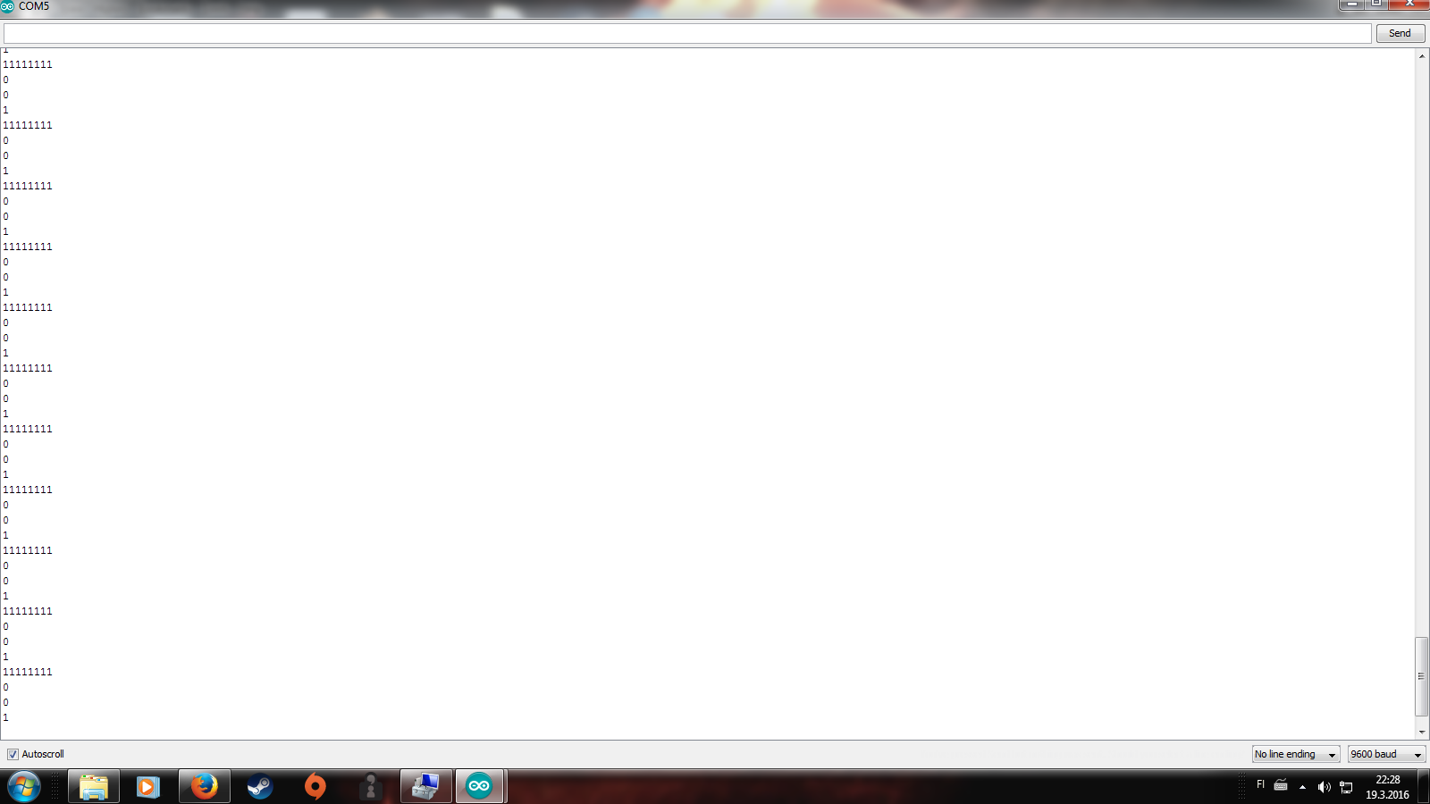

and put serprint in the interrupt instead (hope it works!)
ISR(TIMER1_COMPA_vect) // timer compare interrupt service routine, called every now and then, outside of loop
  if (TIFR2) // Make sure its the timer interrupt.
  setcolumn(displayPointer);  //column scanning
  setdata(buffer1[displayPointer]);
  Serial.println(0B11111111, BIN);
  Serial.println(displayPointer , BIN);
  Serial.println(buffer1[displayPointer] /256, BIN);
  Serial.println(buffer1[displayPointer] & 0xFF, BIN);
  PORTD = (1 << PORTD3);
  PORTD = (0 << PORTD3);
  if (++displayPointer == 2){ displayPointer = 0;}  //  number of cathodes attached, then resets to 0
  TIFR2 = 0; // Clear timer 2 interrupt flag
Hmm, I tried to compile but errors rain, here's code(can't see obvious reason for those errors...):

Doggy, here's serial output, no error now, and leftside digit dot is lit flickering.
ok here is another test that should give results, the trick is to count how many lights on each segment, should be consistent, i think the problem here is that we have one of the buffers/registers reversed, also in the mean time I'm thinking about another arduio for myself, but before i do , and for us here, ima try to get this atml studio for vb working, i hear roomer that with it we will be able to debug the arduino, which helps alot...

hmm, all is empty, on screen as well as serial monitor
Odd, still left dot flickers, but now it also stops too, need video? it flickers about 6-7 seconds,then 1 second off, repeat
Indeed it shows data now, dot doesn't flicker now however: (sorry, it does flicker, it just took a while....)
