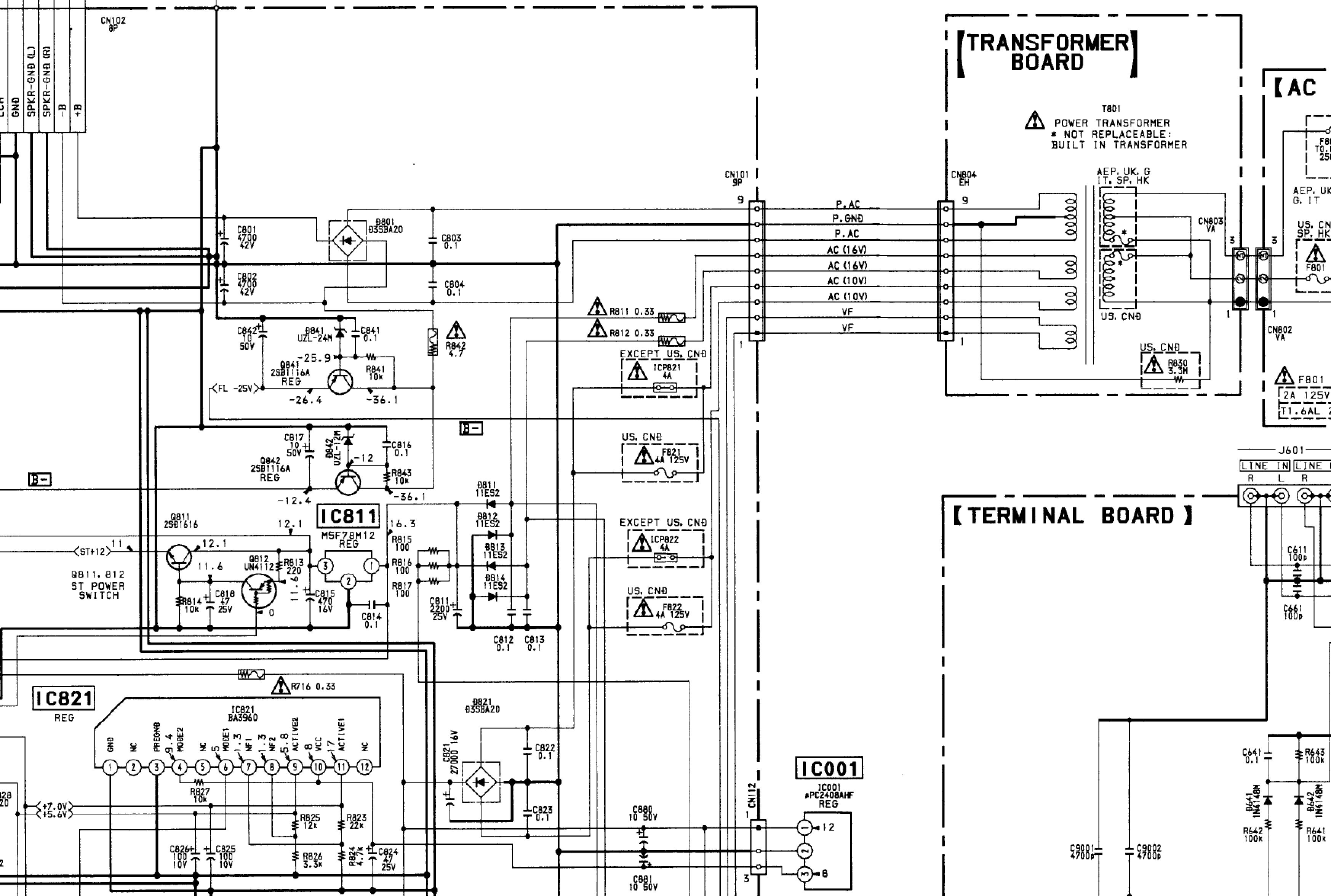

With it all reconnected try measuring the DC voltage on pins 9 and of IC821, pin 9 should be 5.8V and pin 10 should be 8V. Pin 9 is the power to the main micro.
OK, I'll do that. But the transformer has got only 9 pins going out. I'll to get earth somewhere and try to get a reading.
When I plug the mains a hear a faint click, so something get power.
And when I unplug a second click.
Is this the clicker ??
Stupid me. Instead of verifying the IC821 on the schematic I bought of the transformer.
But now I see what you are pointing at : the rectifier .
I am reading a book on the discoveries of Nikola tesla and I should have known that AC is transformable, but still stays AC .......
Forgive me.

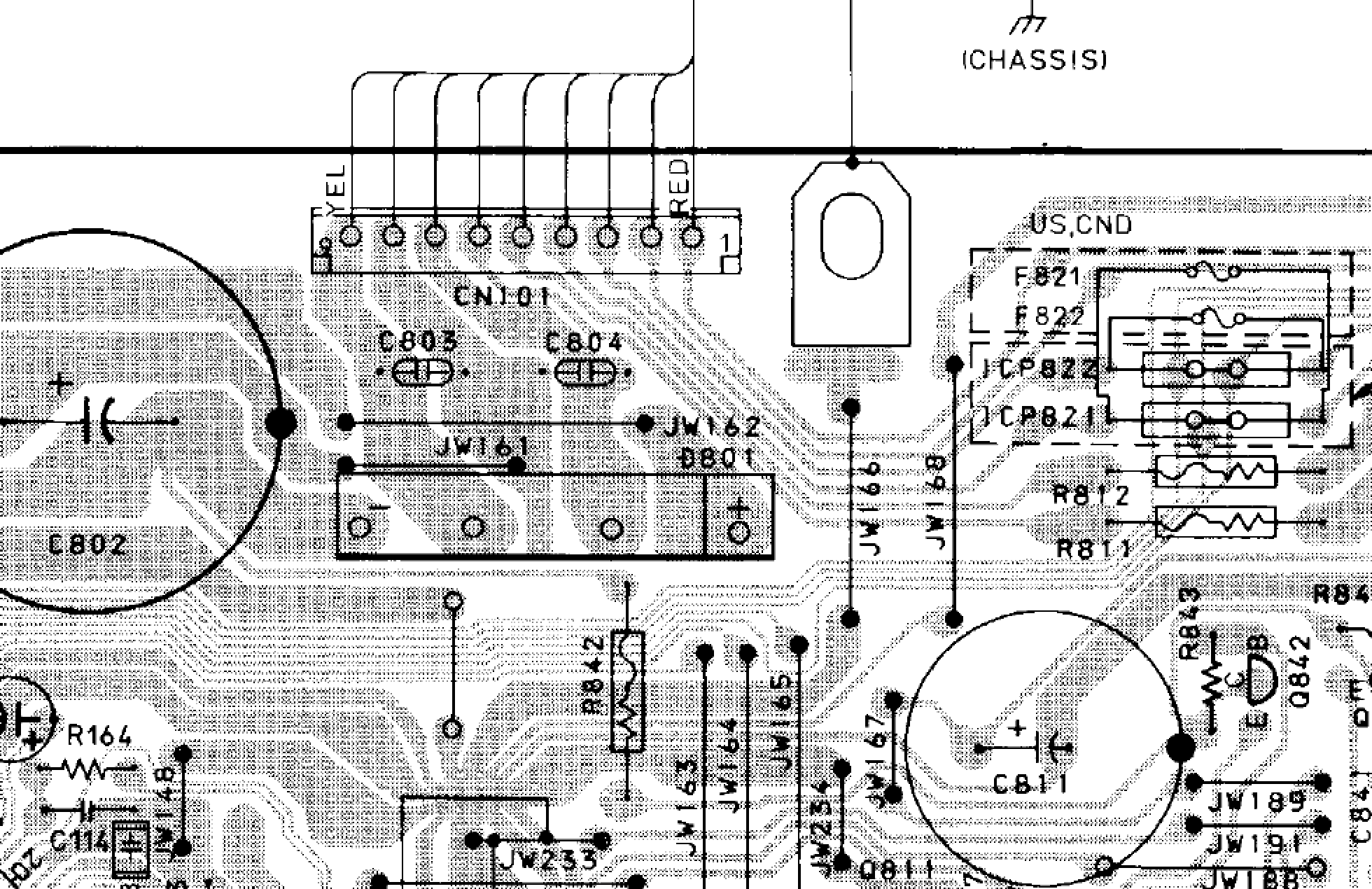

The voltage from there goes through a pair of circuit protectors (small soldered in plastic fuses) ICP821 and ICP822, you can test those without power with your low ohms range.
You can bridge the failed one with an equivalent fuse - or preferably test the components after that to find the cause of the failure.
Simply bridging it out now is likely to cause more damage, as there will no no overcurrent limiting if there is a fault in whatever that feeds.
Yes, caution is good advice. I’ll get a replacement fuse first. But upstream there is nothing else but the transformer, so could the one out of two similar fuses have blown because of a spike, or fatigue ....
I would suggest connecting a 12 volt (Filament.) bulb such as a 21 watt car stop lamp bulb in place of the fuse while continuing to trace the fault. (Avoid using a 20 watt quartz halogen type bulb as these have very low cold resistance.) Before doing that it would be worth testing for a short circuit on the 4 diodes in the bridge rectifier using the diode test setting on your meter.

In my limited imagination I see cause of the blown fuse upstream. The main glass fuse on the 220 mains input was never blown. This is a small soldered on fuse immediately behind the transformer, I think, before the rectifier. If I talk nonsense, forgive me.
